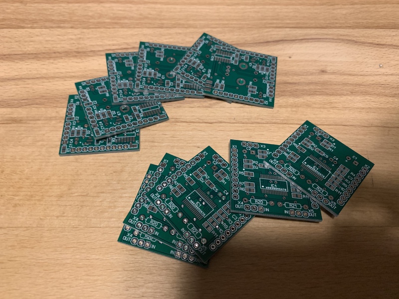

Muses Volume
New batch arrived today.
I will ship them to the end of this week.

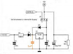

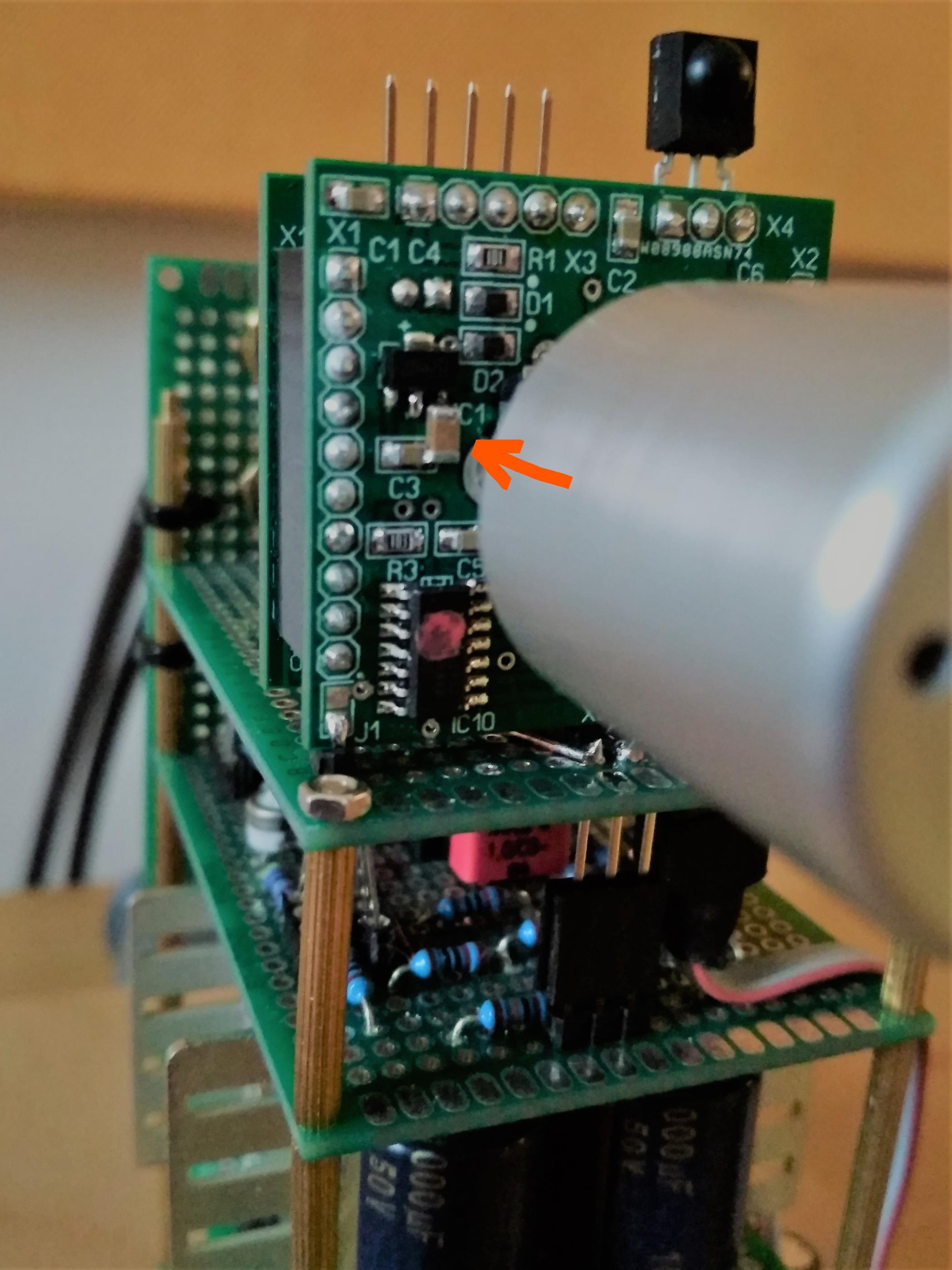

I have two minor suggestions:
1: (Controller board) The LDO or voltage reg. needs an input cap close to input terminal. This cap should have a capacitance value equal to or larger than the
output capacitor for performance applications.
Fortunately it is easy to install to the board, see pics. I do not remember the package size, maybe it is 1206... fits perfectly.
I tested two different LDOs in this application with and without the additional cap, and without the cap both were oscillated.

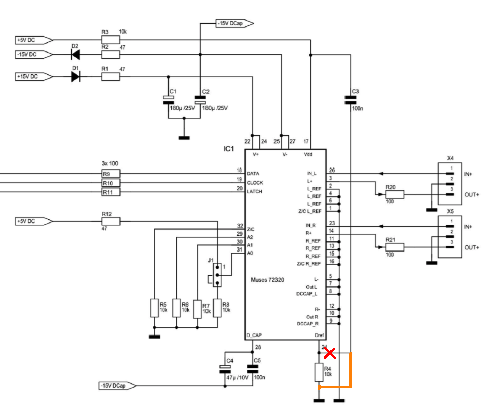

2: (Muses board) I think there is a mistake, see pic.
It is easy the cut the trace between C3 and R4 and you can use a little wire to connect c3 the other side (gnd) of the r4.

rookakoma: Nice find! I looked at that scheme 100 times and never noticed. :magnify: I never experienced the oscillation but I used an external supply from the start, although I did mount the on-board for possible future needs. Thanks for the tips! I see you have the IR sensor attached, did you have any troubles getting a remote working as some others have? I haven't tried yet.
