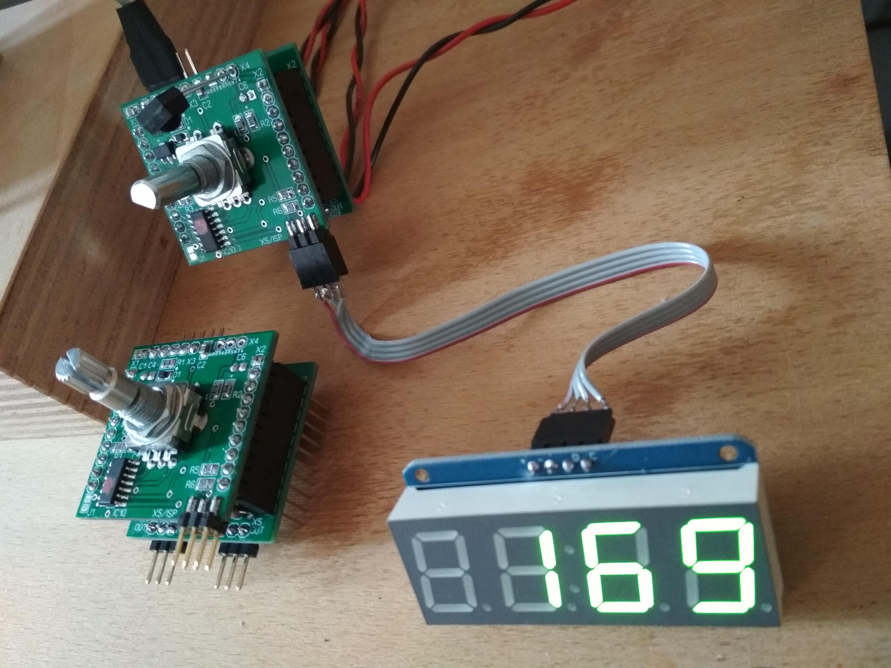

I just finished mine.
Works perfectly with remote and LED display.
I don't use galvanic isolation for the display, and I don't hear any interference.
I like what I hear 🙂
The documentation, the PCBs and the firmware is perfect.
I enjoyed to built it.
Thanks Meldano.

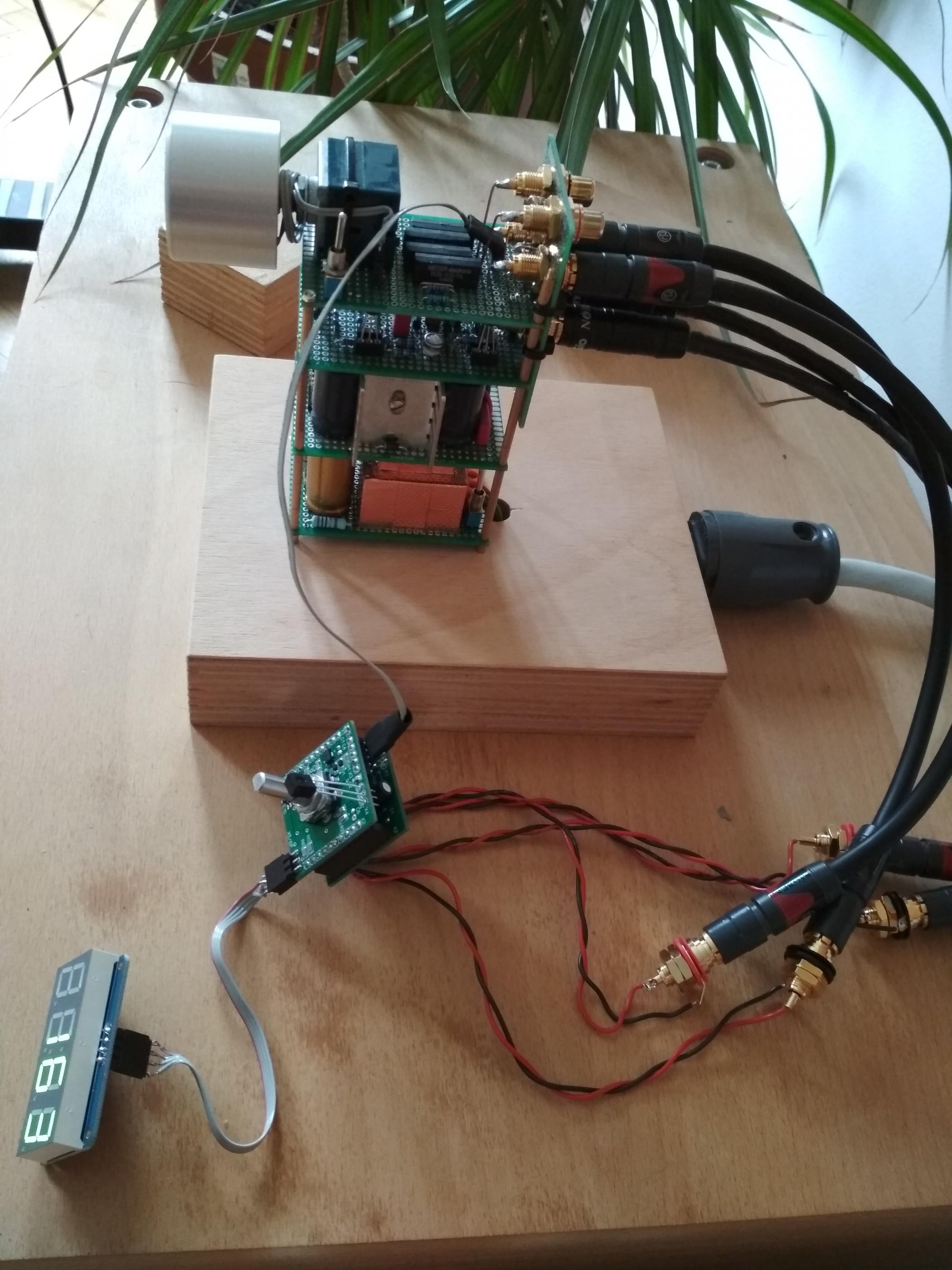

Actually it shares the PSU with my preamp, nothing special LM317/LM337, +/-12V. I put the volume pot on the preamp to the max, and I connected the muses before the preamp, but this is just a test setup.
I think the very low noise for muses chip is not important.
The 5V for the logic circuit is CRC filtered before the 5V LDO on the controller board. With jumper you can choose: feeding the 5V LDO from the muses supply or you can feed it from an external source.
But you right Quantensprung, an other stacked same size PCB, with LDOs like LT3045 and 3094 would be great.
