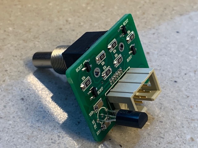

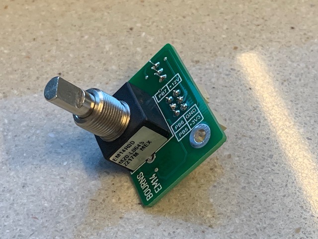

Very nice.
If you will use massive aluminum volume knob, apply a smidge of Teflon grease at shaft, where it enters encoder, speeding it with rotation and exercising pushbutton action. With a very heavy knob, it could squeak a little after some time.

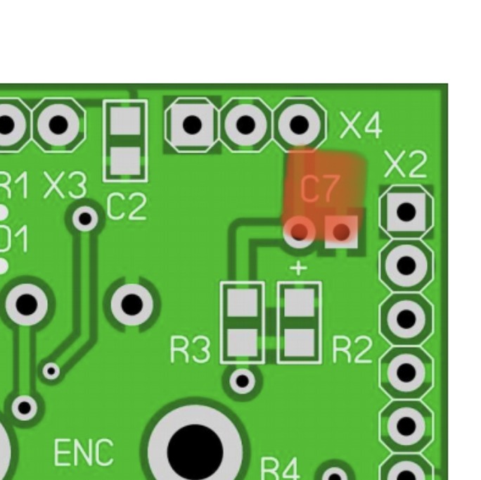

Hey Daniel, got a question regarding the v2 uC and Volume boards:
  • For the uC board the pdf manual says C7 47uF/10V, however there is no C7 marked on the board, only up to C6?
    Actually there is a 2nd C6, it is SMD cap right to the ST processor.
