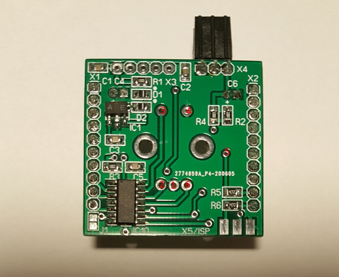

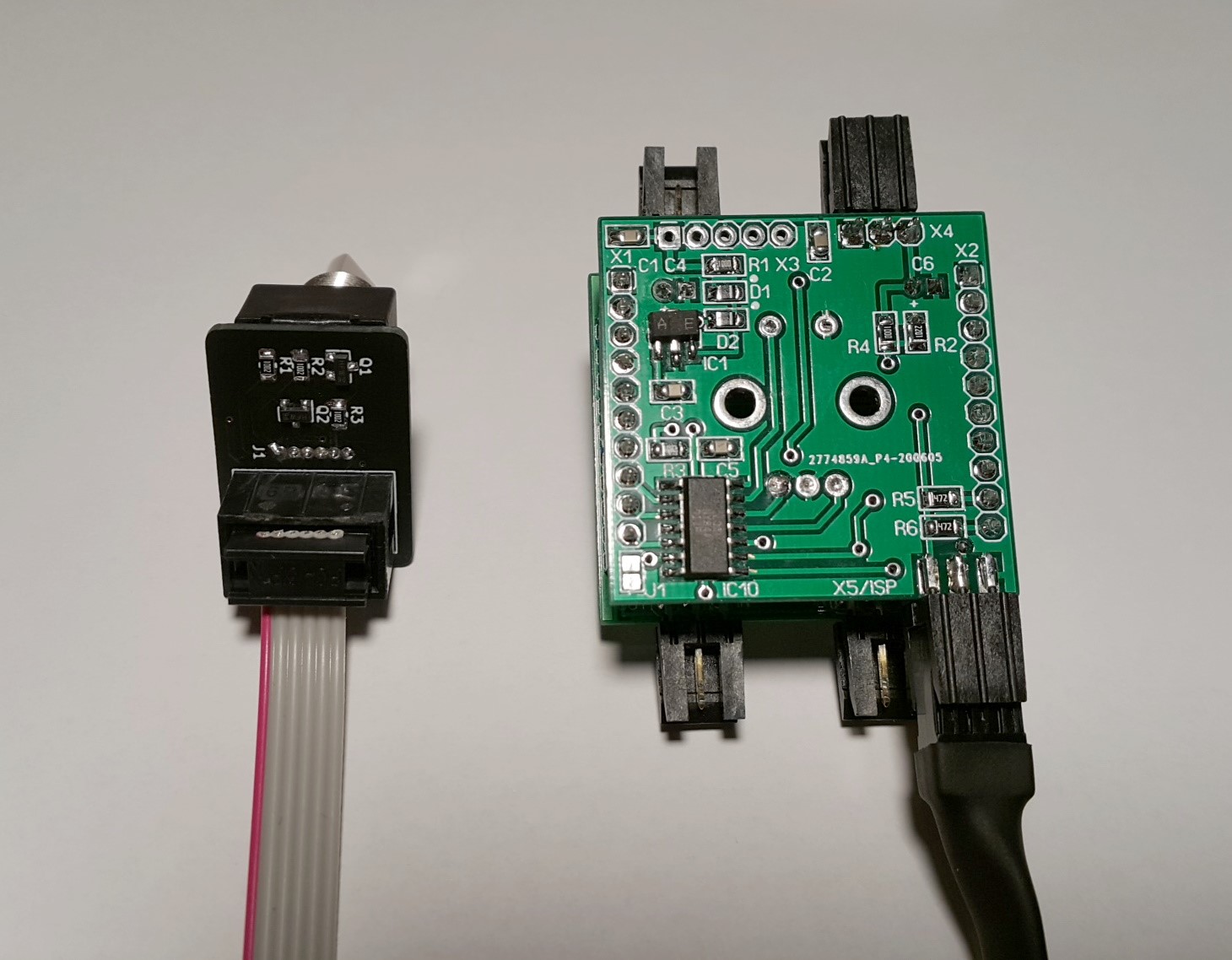

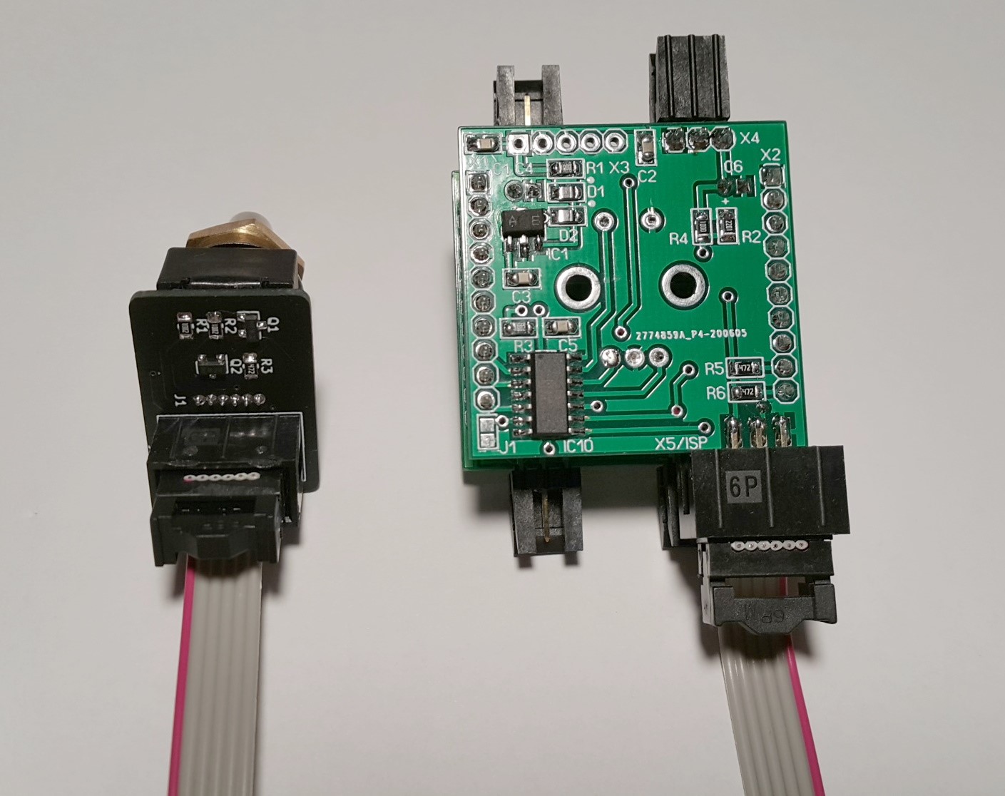

Bourns EM14 to Muses adapter
I understand that I may be the only one in the world annoyed enough with the original PEC-11L encoder to go this route, but here are details and gerbers anyway. With this adapter, Bourns EM14 encoder can replace standard encoder in any device.
Adapter PCB can be connected to the Muses volume control using connector at position for additional display (if you don’t use one, and by cutting some traces) or by soldering wires to the corresponding points. If we consider flat cable red marked wire as 1. then corresponding connection points are marked at controller PCB picture. This encoder seems perfect.
