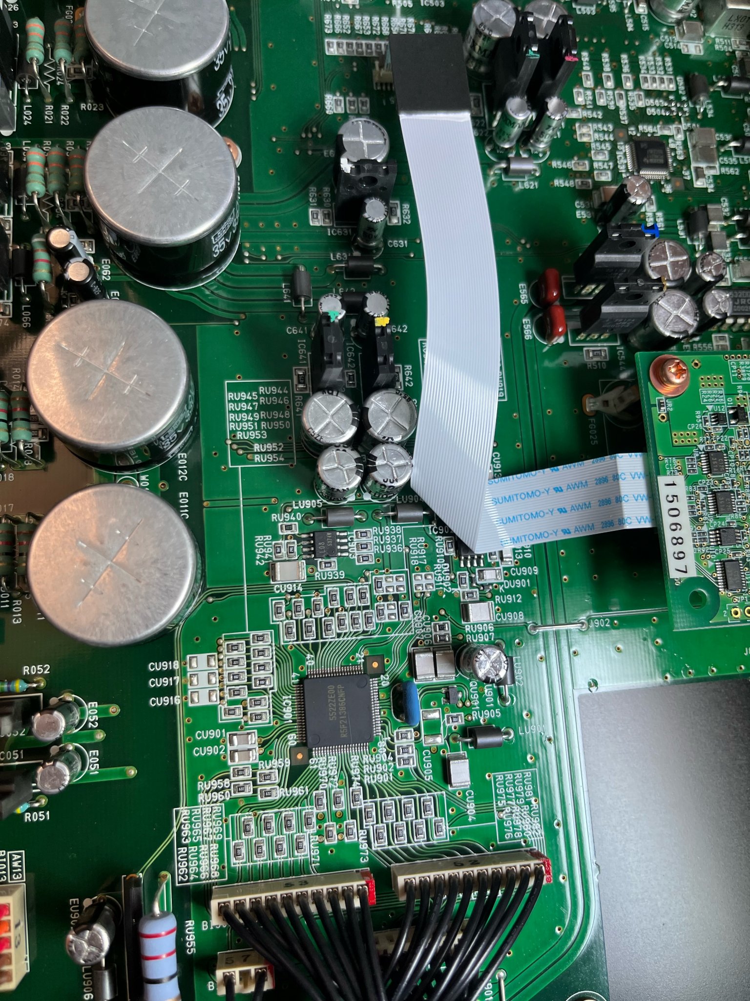

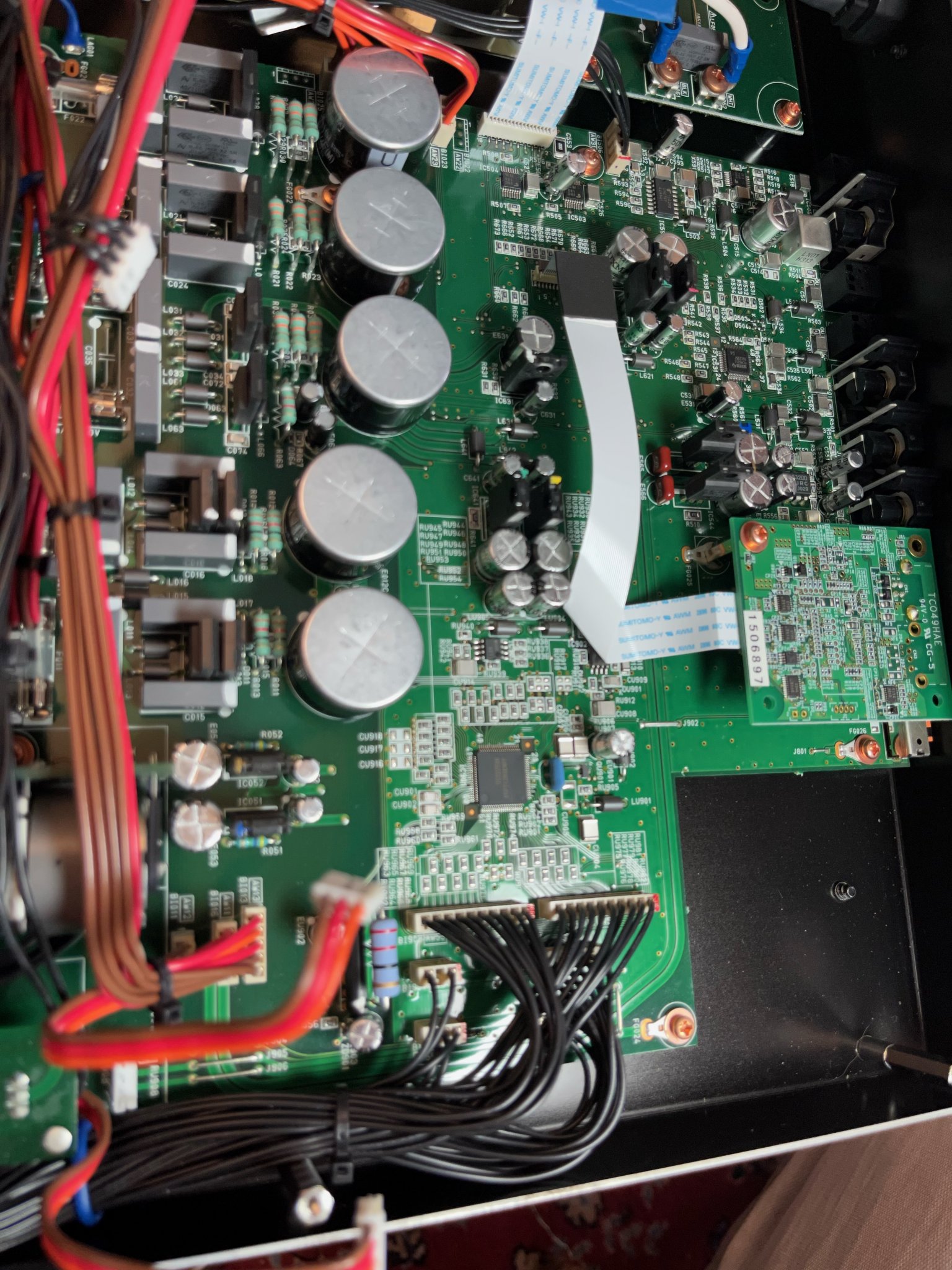

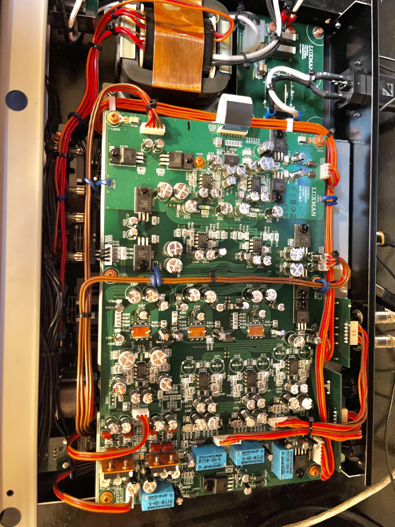

Hello, community! I have a dac which uses 3 muses 72320 for volume control of headphones, rca and balanced. Suddenly rca and balanced stopped working, headphones are working fine. I measured 5v DC on ADR1 and ADR0, after I connected them to the ground, it started to work. Also the responsible relays were not switching and I had to bridge them to the working relay. Please help me with any advise, where to look!
