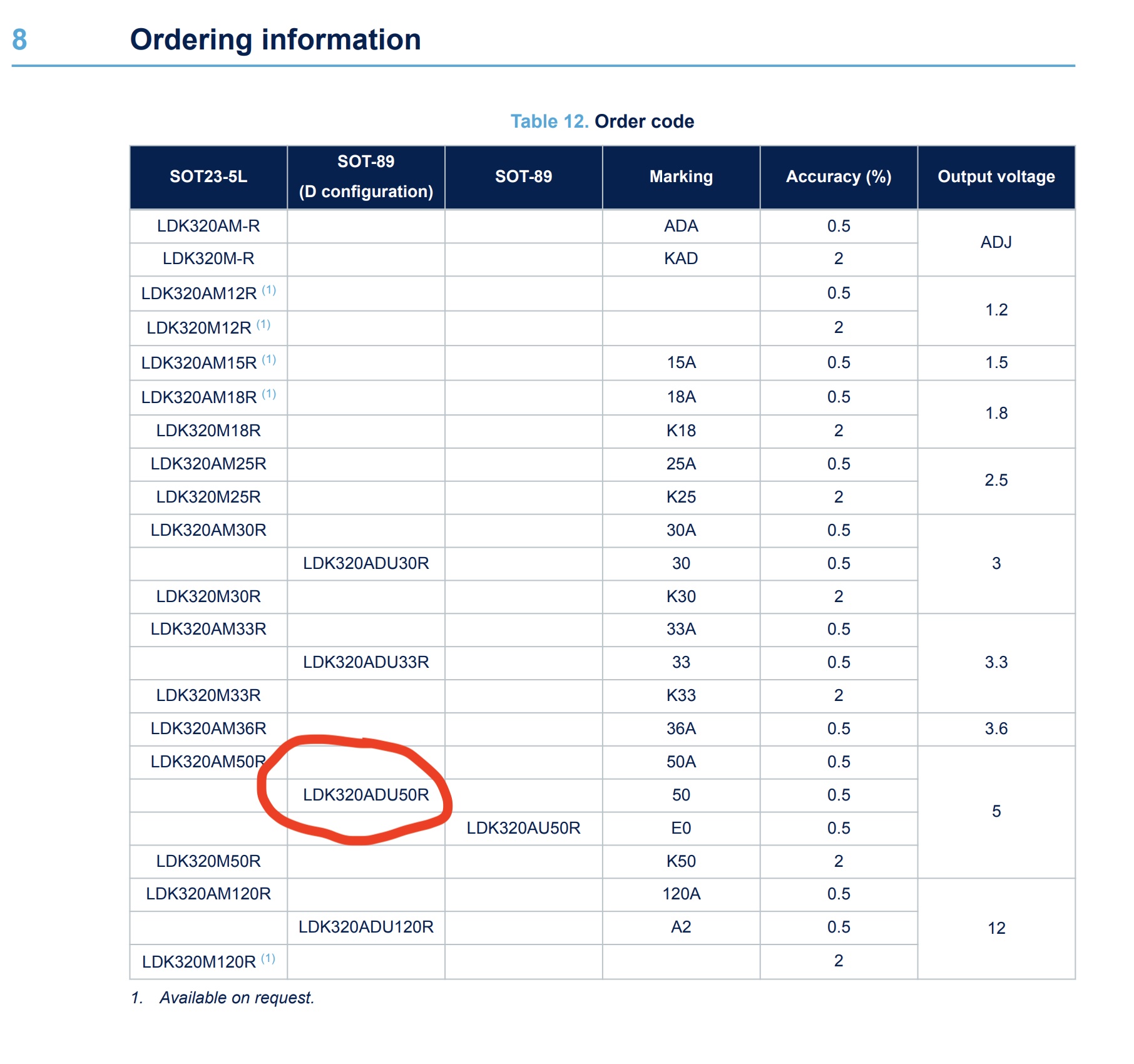

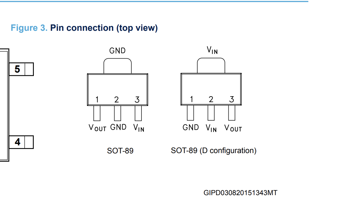

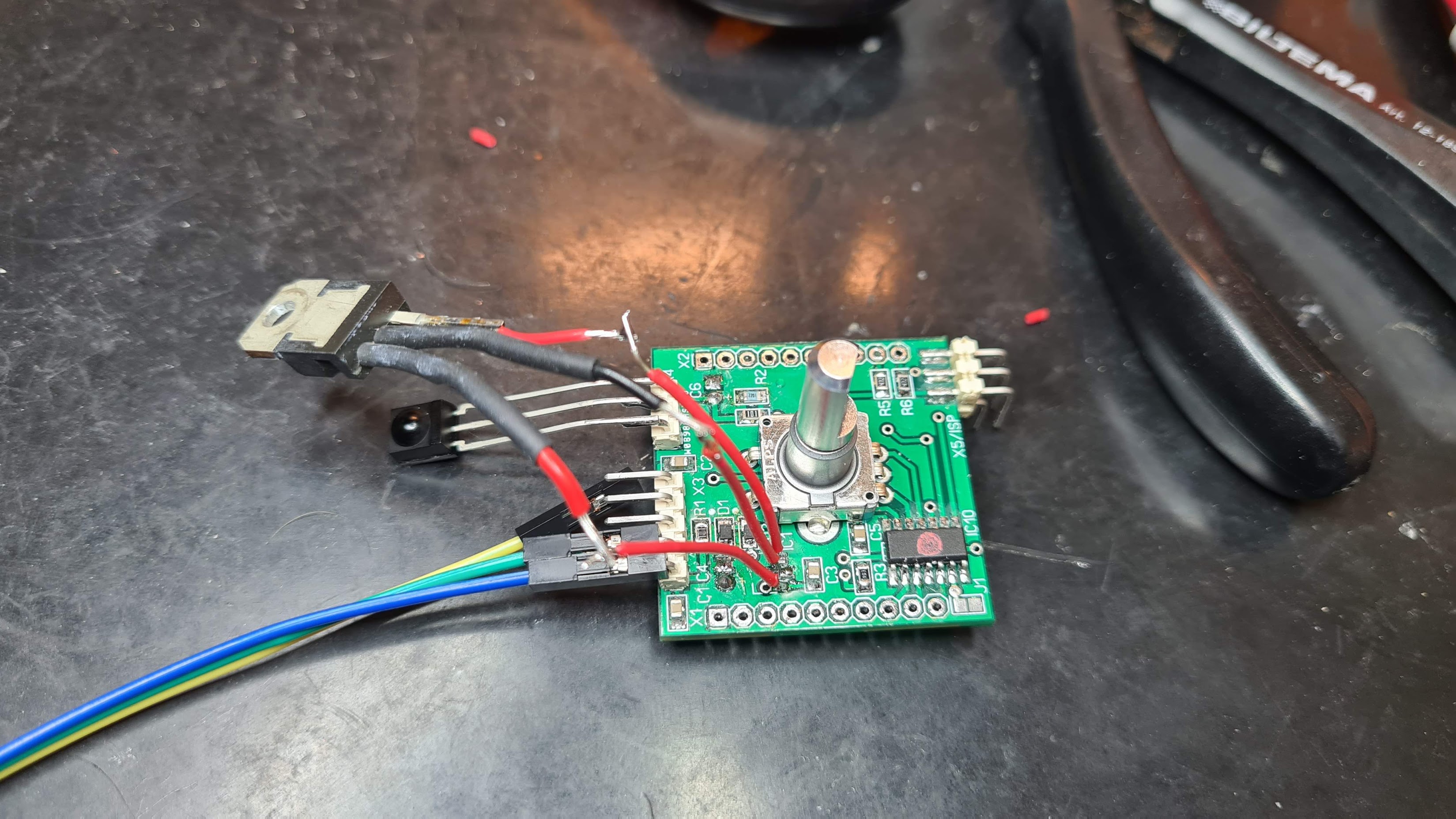

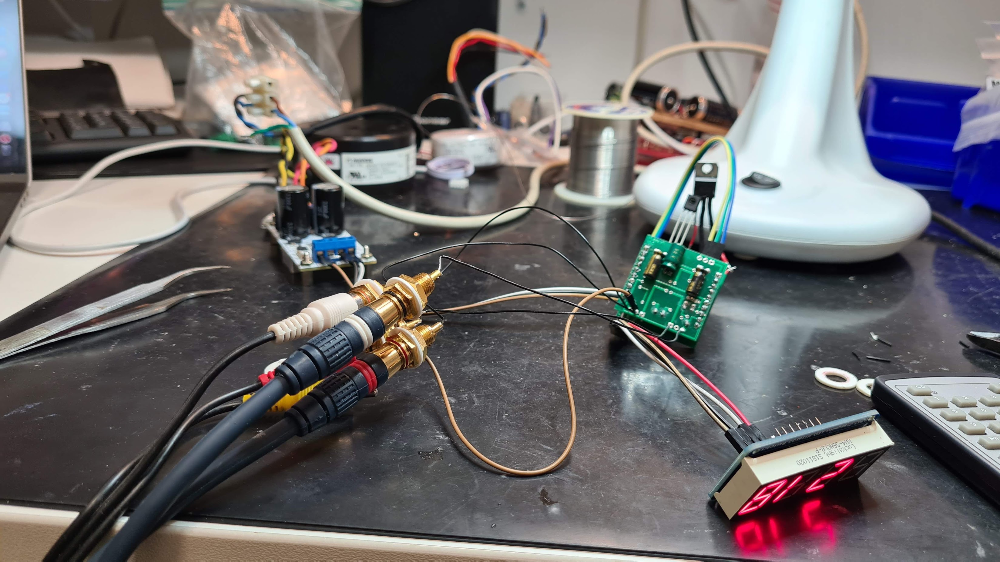

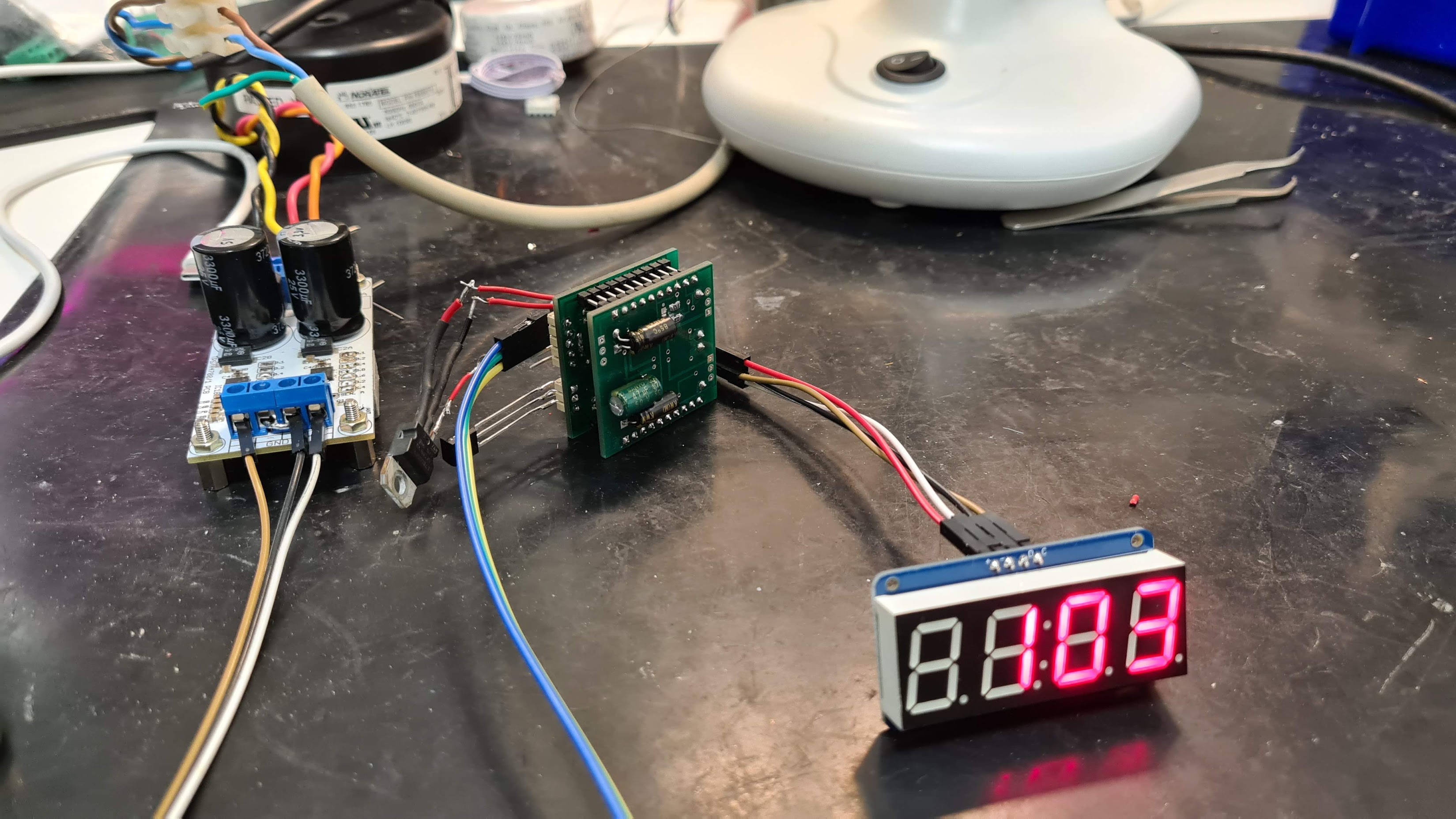

I built two of this and both are working fine with or without the display (Adafruit) and with or without using the LDO. After I solved my noise problem and doing some experimenting, I observed that it work if the supply is less than +-15 but with the +5V external (from a different supply). I was unable to "fire" it up if I use less than +-15 and internal +5V.
The specs says +-8.5V to +-18V. But I am not sure why on my two units, I have to use external 5V if my supply is less than 15. Hope you find the problem!
Thats interesting but I dont think it explains this?
Only running the controller board now and the LDO circuit is fed with +14v (also tried +10v). Ideally I assume approx 6-7Vdc would be perfect for that purpose.
No display connected
Of course I can crank it up some but I cannot understand how that would improve things?
Only thing I can come up with is that Mouser sent me LDO with different pinout? (D-config)
This was what I ordered
https://no.mouser.com/ProductDetail...f//tDZEZckA==&countrycode=NO&currencycode=NOK
https://no.mouser.com/datasheet/2/389/ldk320-1374943.pdf
Not sure how I can check that yet, and could that cause this problem?
