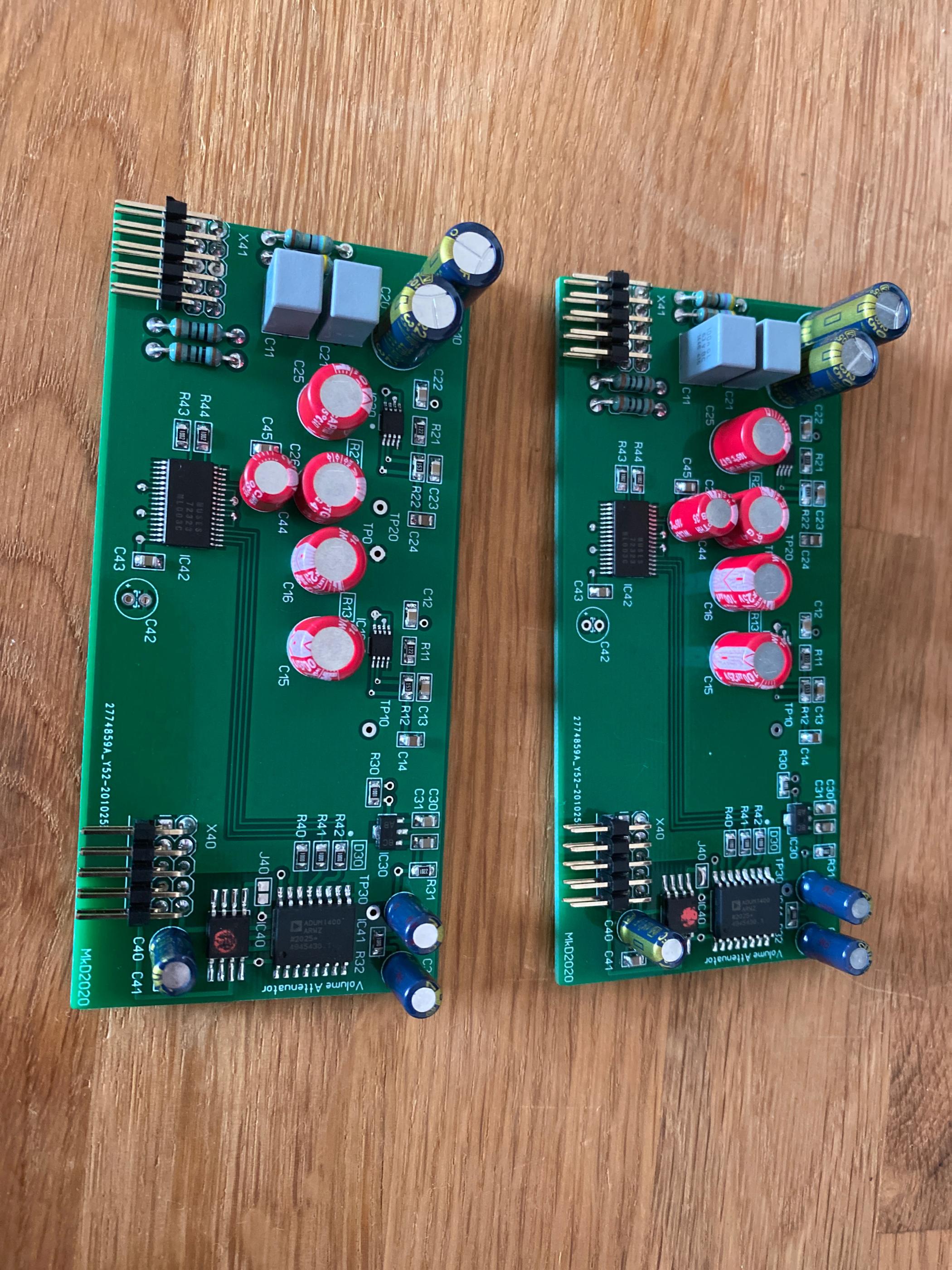

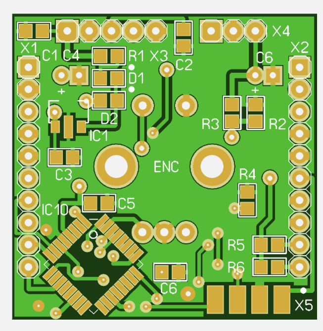

What size are the smd resistors and transistors on your EM14 to Muses adapter board,
if I may ask?. SOT-23 or other? Nice little board, by the way.
Resistors are 0805, same as on the Muses board. Transistors are SOT-23. Any NPN transistor would do. It doesn’t have to be BC817.

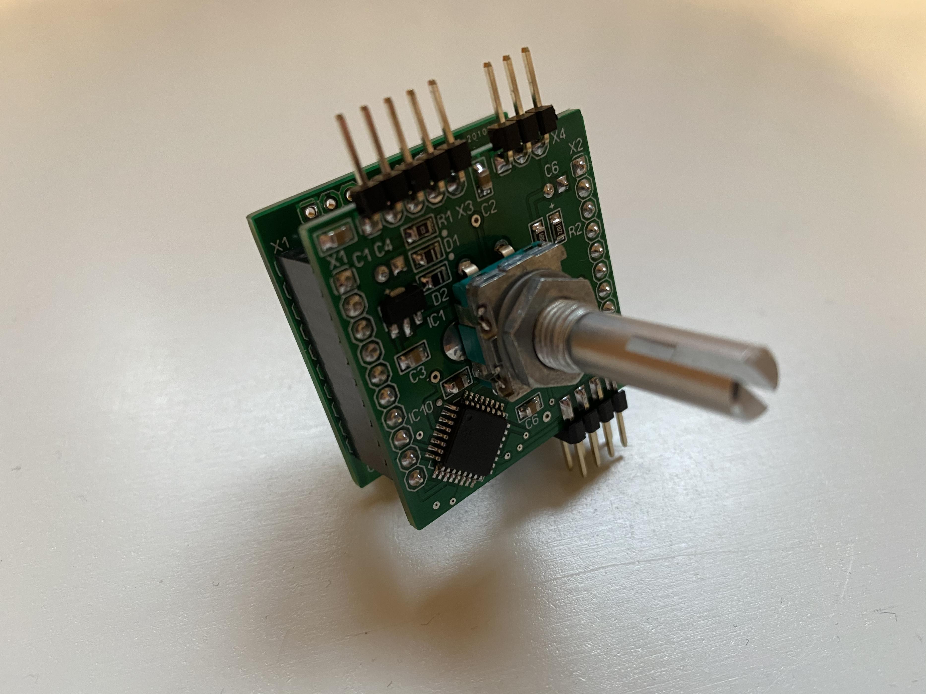

BTW: Actually I build a new controller board with a STM32 and many features like conventional pot, programmable steps, optional input channel switching, Muses 72320 or 72323 option...
Very interested in the new 72323

The PSU in the manual was only for testing (LM317/337).
Pass Labs use the NJR 78/78
I tested the NJR, LM317/337, LT3045/3094, TPS7A49/TPS7A30
In my main system (Pass clone) I prefer the TPS types.
My college prefer in the same Preamp the NJR.
Meldano do you have a link to a NJR regulator?
Features list for v2.0
• Mech. compatible to v1
• modern mcu (stm32)
• Infrared learning capabilities
• 0..-111,75dB in steps of 0,25/0,5/1/2dB
• Mute function
• Individually adjustable user parameter (volume step size, startup volume, balance, no. of input channels…)
• Balance
• +/-10…18V voltage supply
• 2,4,6,8 volume channels possible because volume boards can be cascaded
• optional 1..4 input channel
• optional analog potentiometer to adjust volume
• reduce distortion from mcu with deep sleep mode
2/3 of features are ready/tested. Documentation is “on the way”
I think I need around 2 month to complete the firmware. After that I will order a couple of boards.
