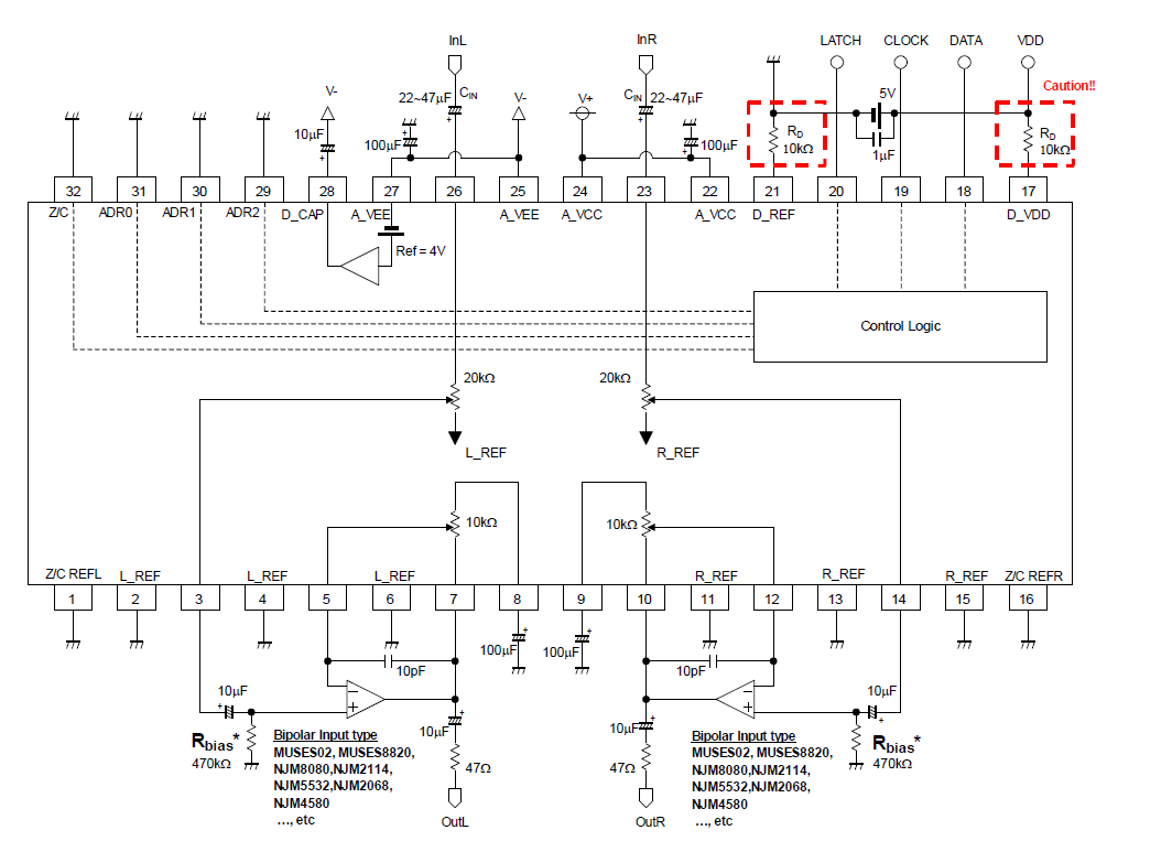

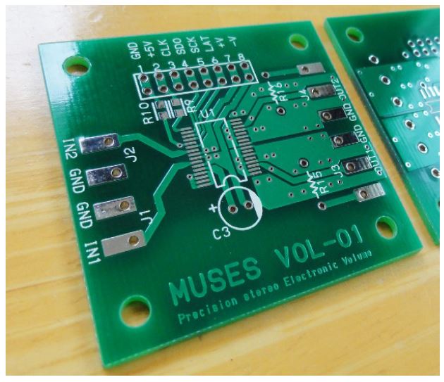

Muses seperate L+ R ground
Has anyone experience with seperate grounds for L and R channel?
I drawing PCB's at the moment based on the example below.
That way, I have from the source onwards, fully seperated grounds. Mono preamps and monoblock poweramps.

Hi Bensen,
The link gives no indication of separates grounds.?
From my point of view this is not feasible with a chip, because the power supply cannot be shared. This is intended for the complete chip and not for the individual channels.
An XLR solution with two chips would be possible, I think.
Hi Bensen,
From the picture I attached (post #508), you can clearly see seperated gnd for each channel. When going through the datasheet, also here it looks if power and audio ground are not connected?? The internal pot is ground is going to L_Ref and R_Ref. I'm aware that the internal pot is made with FET's (or similar), so I would not be a surprise for me if the power and audio ground have to be connected internally in order to switch the FET's.
I don't (yet) have experience with this setup.

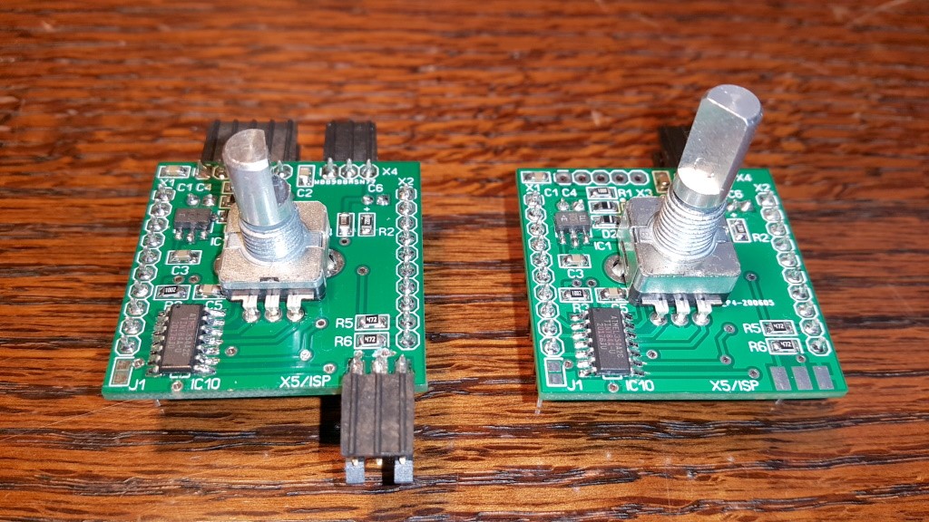

I’ve assembled Meldano’s Muses volume controller for my preamplifier. Volume control works fine but I was very unhappy with how many turns one has to make to adjust volume while changing between inputs of a different level. With original PEC-11L encoder, one full turn is 20 pulses what makes 10 dB volume change. Besides, physical sensation on the volume knob was very flimsy and unnatural, compared to the ordinary potentiometer.

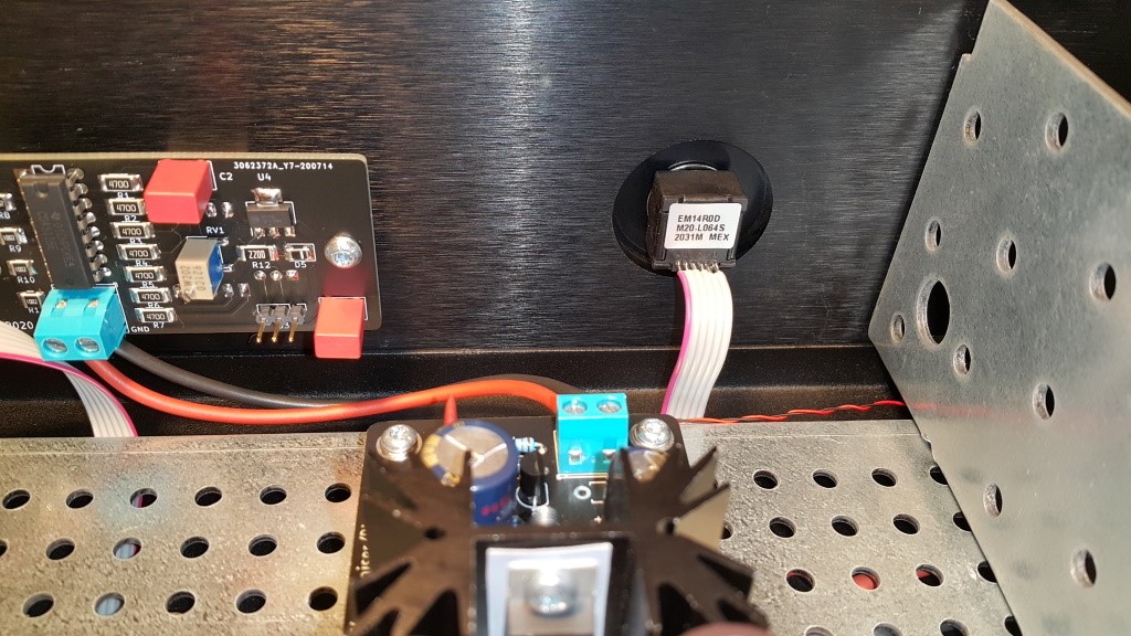

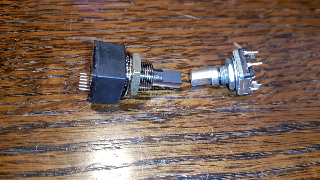

So, I decided to try another encoders. There is a new encoder with ball and spring detent mechanism:
https://eu.mouser.com/ProductDetail/Bourns/PEC11H-4220F-S0024?qs=7MVldsJ5UayW2mw8xYm74g==
It has, slightly more, 24 pulses per rotation. That is better but not good enough. Physical feedback was like stepped attenuator. However, there was some play at detent neutral positions, like 1/3 of step. Other than that, it was a big improvement.
Bourns has encoders with up to 256 pulses per rotation, but with switch only up to 64 pulses.
EM14R0D-M20-L064S Bourns | Mouser Europe

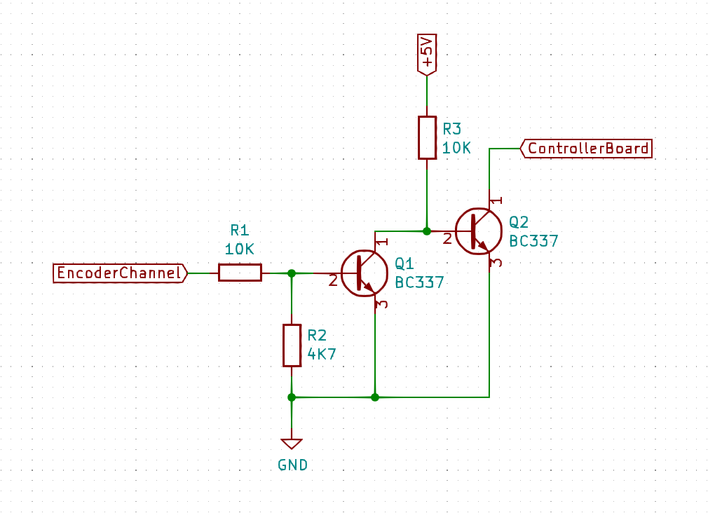

As those encodes have active outputs, simple adapter with 2 BJTs per encoder channel must be used, as controller chip works only with connecting input lines to the ground (as is case with PEC-11L type). This encoder gives excellent results. Volume control works like very fine potentiometer with 32 dB regulation per rotation and physical feedback is very good with smooth travel.
For this test, adapter was soldered directly on the controller board but I will make adapter PCB that fits to the encoder, as I like my builds to be tidy. Encoder is on the preamp front panel and is connected with flat cable to the volume control board.

Please share the shematic to adapt the bourns.

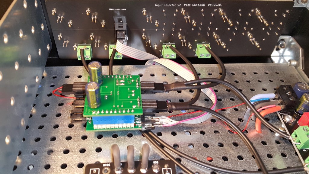

Actually I work on a new muses board with the new Muses 72323.
Maybe I will design a new controller board with input selection option and some
other improvements.

I intended to publish details along with PCB gerbers but, if someone is eager to try, here is used adapter schema for one chanell. I think it would be an excellent idea to have option for a better encoders on your implementation and wouldn’t mind if PCBs would be bigger because of that.
I meant that I intended to publish schema and gerbers for other members use, not specifically for you, as you really don't need that someone else prepare gerbers for you. 🙂
