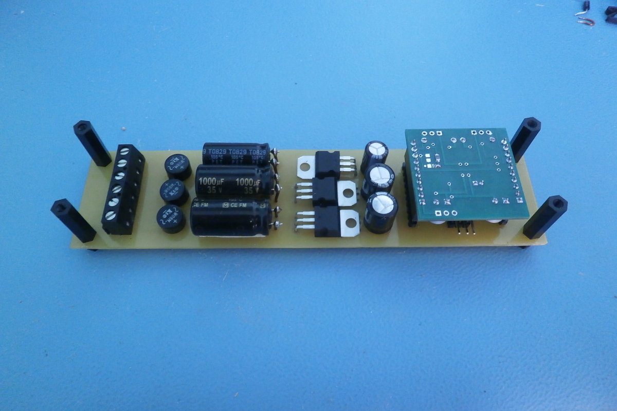

I'm currently finishing a psu with standard 7815/7915 (for analog Muses) with two 7805s (one for digital Muses and the other for the controller / display). I'm very much interested in comparing it with modern low THD LDOs (I have another Meldano kit with I-Select)

In the picture the psu and Muses pcb are placed under Salas I-Select

What is the best regs that not waste the volume controller please for the Muse chip , defintly the NJR 78/79xx or disearve a better (as I also have some other on hands : Ti, LT, etc) ?
The PSU in the manual was only for testing (LM317/337).
Pass Labs use the NJR 78/78
I tested the NJR, LM317/337, LT3045/3094, TPS7A49/TPS7A30
In my main system (Pass clone) I prefer the TPS types.
My college prefer in the same Preamp the NJR.

A short explanation of the design of my Stand Alone Potis. The used OpAmp (a NJR) by the way, is only used by the Muses chip when it is in gain mode.
This mode is not used in my version. So it has no influence on the sound and could simply be left out.
The coupling capacitors can also be removed if it is ensured that no DC voltage is present at the input or output.
