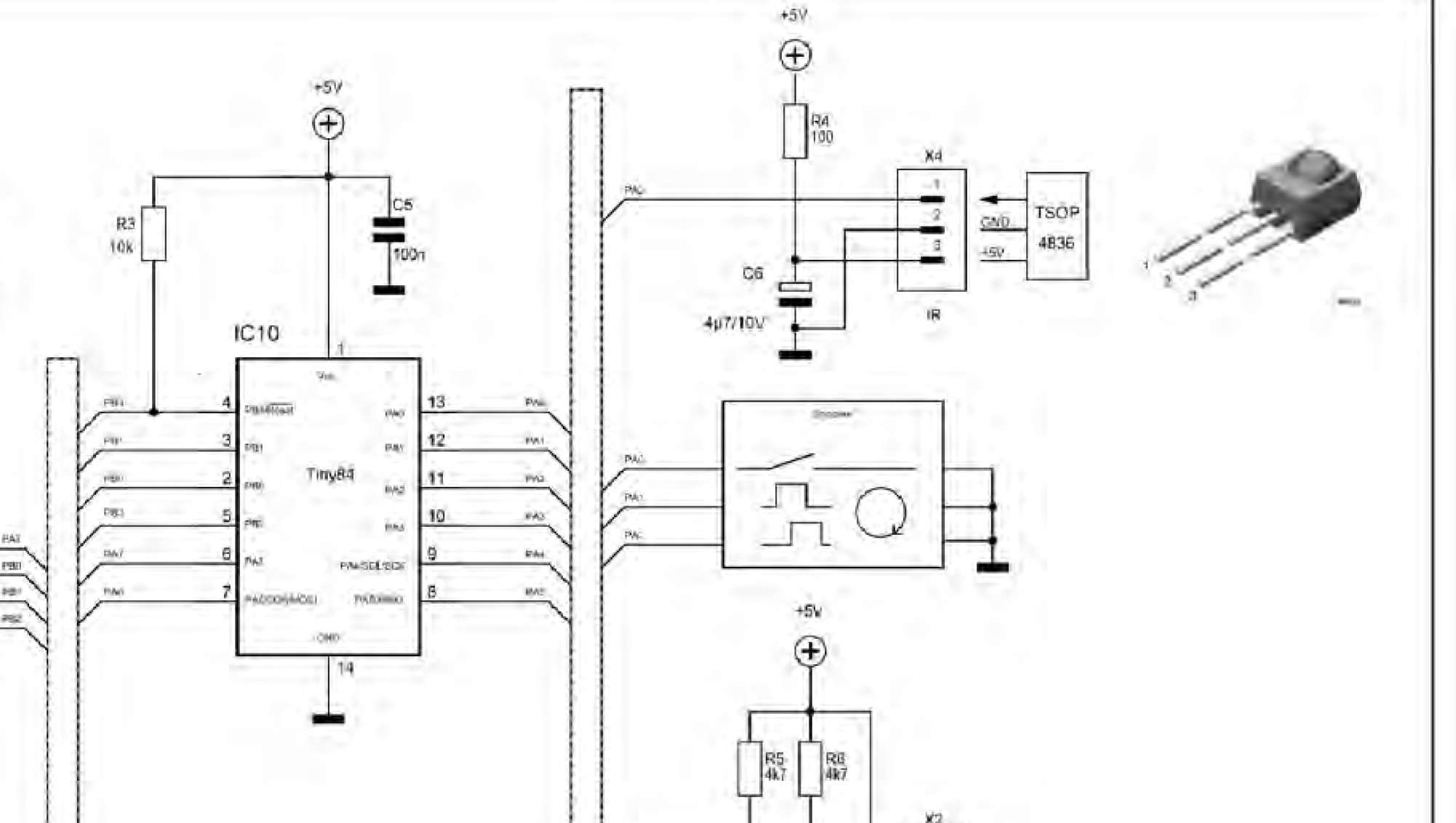

I added the IR receiver but not the digital display. One thing I can't figure out is how to program a remote. Can anyone assist with this? I tried to follow the instructions to no avail.

„ The controller can be taught to many common IR codes. Below the setup is described
1. Turn on supply voltage by pressing the encoder button
2. Release encoder button
3. Press button for "volume up" shortly on the remote control 4. Briefly press "volume down" button on the remote control 5. Briefly press the "mute" button on the remote control
In the case the 3 keys have been successfully detected, the controller will start as usual with the starting volume. The read codes will be stored permanently in the EEPROM.“
Point 1 means: Power on while pressing the encoder key

Thanks Meldano! I did hold the encoder down while powering on, but still no luck. I tried 2 different remotes.
A problem with your ir receiver?

OK I checked it over: there is 5v across pins 2 and 3 as expected. Pin 1 has continuity to pin 10 on the controller. Unfortunately the schematic I have is too blurry to read the fine print. Pins 2 and 3 have continuity to the correct sides of C6. It also measures 33K ohms across pins 1 and 3 as expected.
Is there a way to check the IR receiver to see if it's bad?
https://www.mouser.com/datasheet/2/427/tsop48-1766935.pdf
Yes it is pretty easy if you have an oscilloscope putting a probe on pin 1.
