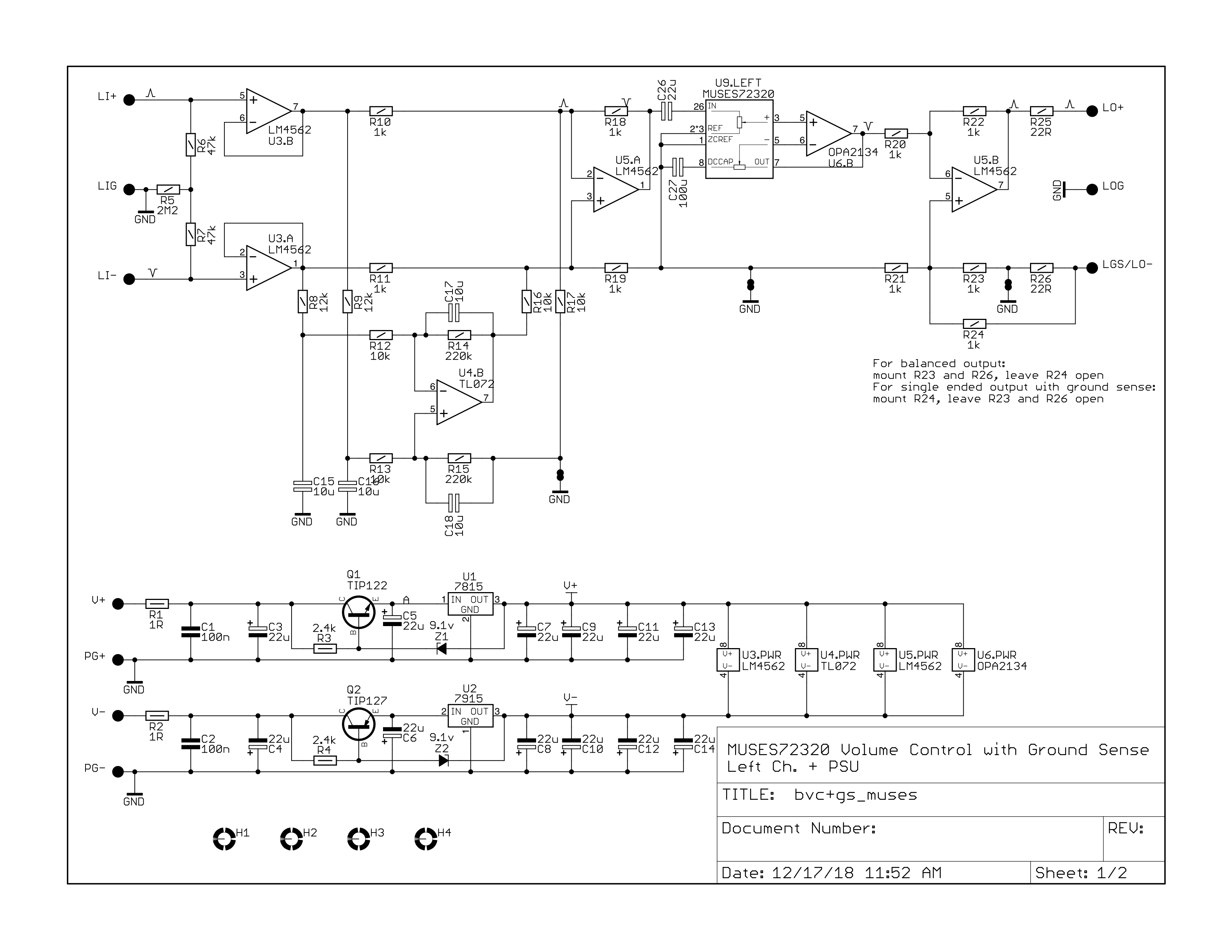

Attached is the schematic for one channel. Full schematic and other documentation can be found here.

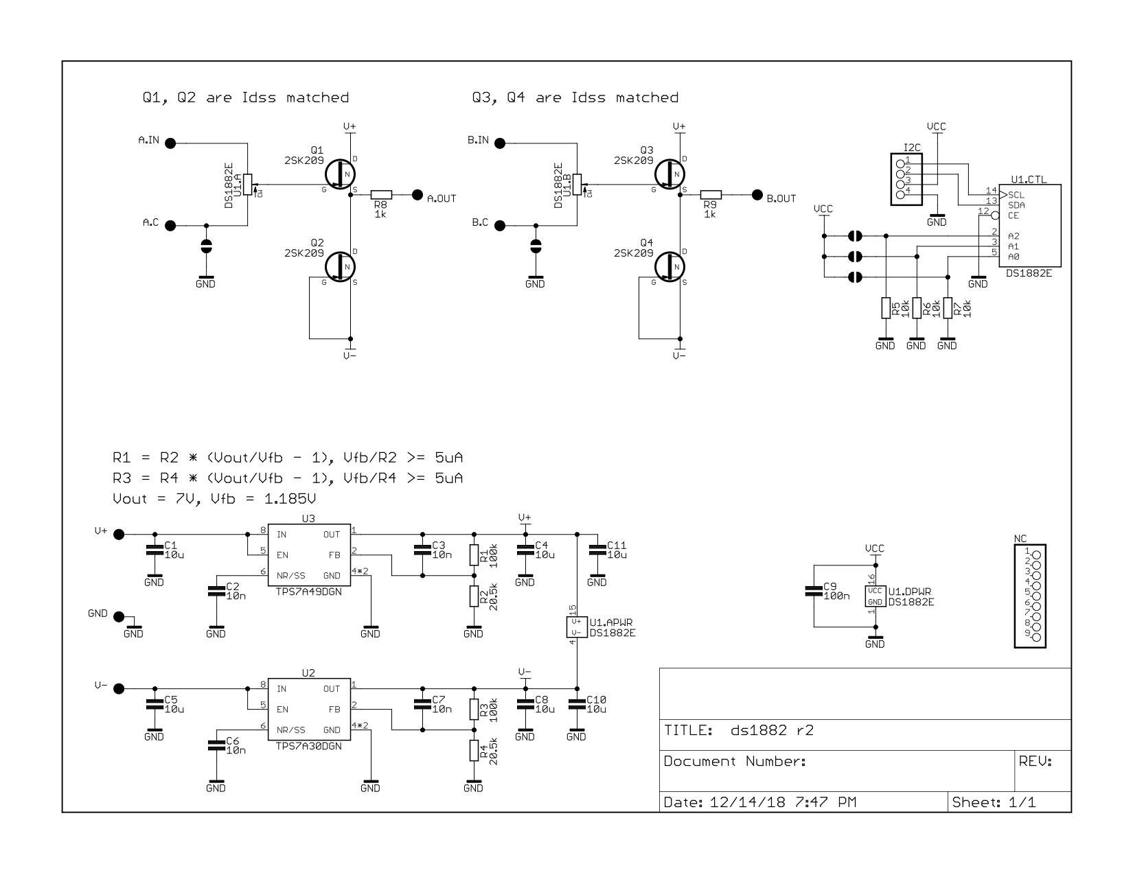

Maxim MAX5437 as an alternative to the Muses chip

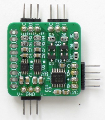

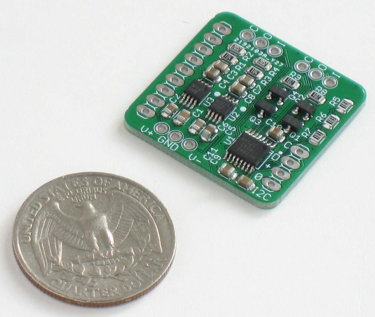

No experience with MAX5437, but AFAIK it is a linear digital pot. For volume control, it should work well as a negative feedback element for, say, an opamp. To use it as attenuator, a log pot would be preferable. I've done some work with DS1882, a very nice digital pot that I believe was used in some PassLabs amplifiers. It seems it doesn't like to be loaded heavily, but otherwise works fine.

I have no experience with meldano's boards - so someone who has please correct me - but the datasheet for MUSES72320 shows (page 10, application circuits) 10uF input coupling capacitors (Cin) for the JFET input opamps and 22-47uF for bipolar input opamps. This is probably a minimum.
Cin and the 20kOhm input impedance of the MUSES digital attenuators form a high-pass filter (HPF) with the corner frequency Fc=1/(2*Pi*Rin*Cin). For example, for Cin=10uF and Rin=20k, Fc=1/(2*Pi*2e4*1e-5)=0.8Hz. You want Fc to be well below 1/10 (some say below 1/100 for better stereo imaging) of the lowest frequency you want to reproduce.
Having said this, Theodosis O. above mentioned that input capacitor was "destroying the sound". I am curious to know what happened. Capacitors can distort - see, for example, Cyril Bateman's work - but I am not sure if Theodosis O. referred to that distortion.
Output coupling capacitors seem to be required if the downstream amplifier sources/sinks current into the MUSES chip. The application circuit includes them for bipolar input opamps (nanoamp input current) but skips them for JFET input opamps (picoamps). The value should probably be equal or bigger than Cin as long as your downstream amplifier has input impedance not less than Rin. Note that the application circuit shows 10uF for 470k load, which makes HPF with Fc=0.03Hz.
