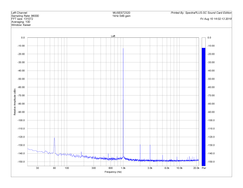

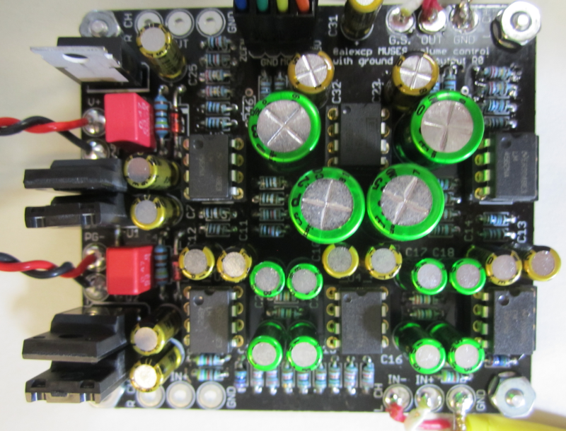

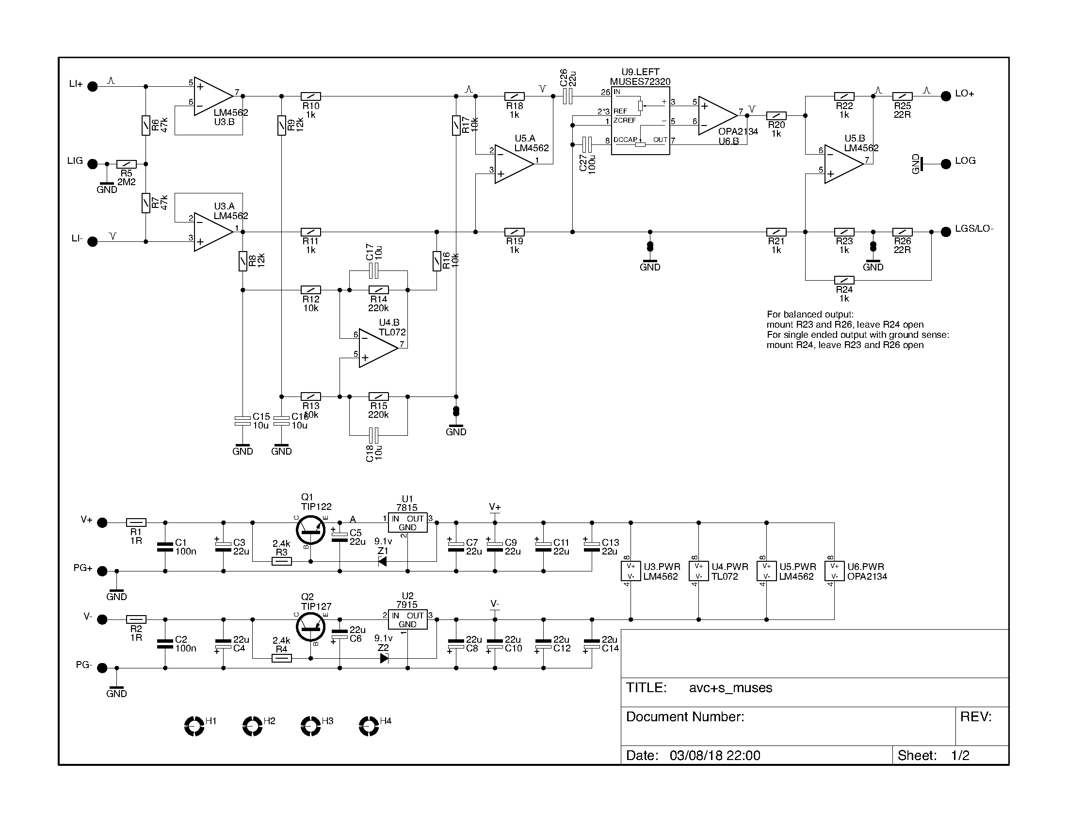

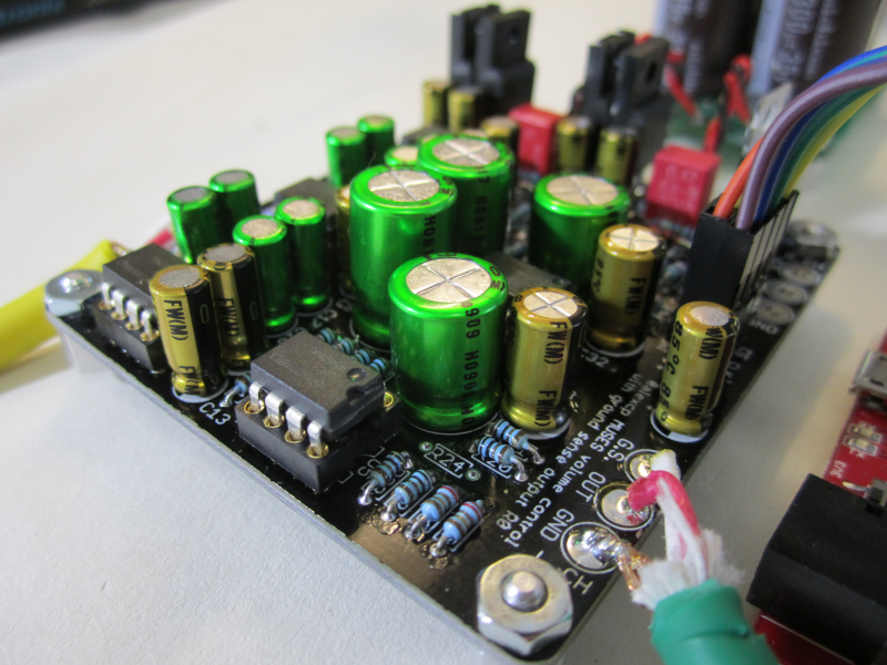

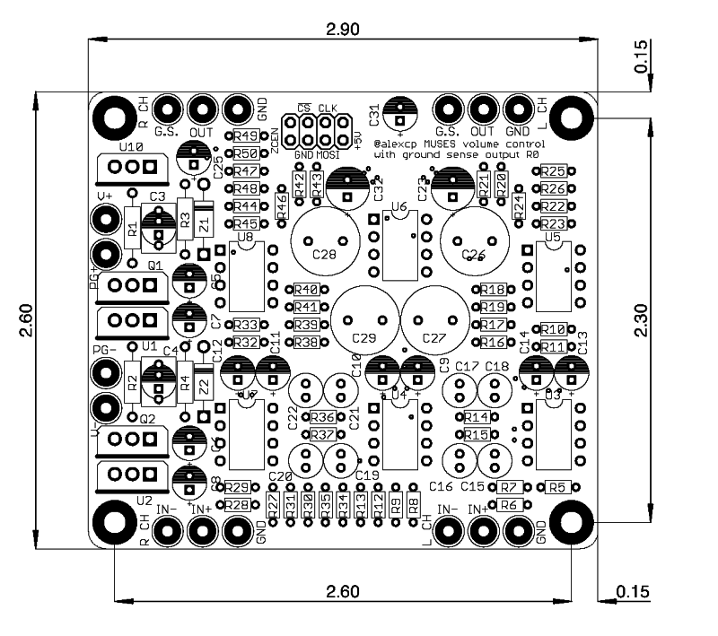

I made a slightly different volume controller with the MUSES72320. The details are in the separate thread. The control is done by an Arduino with an appropriate sketch. I attach some pictures, the schematic the board, and a FFT graph.
I love how you based on Bruno Putzeys preamp from „The G-word...”! Exactly What I’m designing right now. Please see my „Daddy preamplifier” thread here at diyaudio.com.
