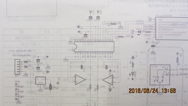

I purchased two 72320 kits with the MUSES01 opamps when I was in Tokyo two months ago intended to use them for separate L and R channels in my tube preamp. After assembly, I have to say this is possibly the best pot I ever had in this preamp - Blue Alps, DACT and Khozmo. The highs are crispy clear, the mid and low are with rich density, violin and vocals are singing in front of me. One can easily tune the sound by using different type of resistors on the output 33R. However, I have a problem.
Both pots work fine but one of them is generating a small "pop" from time to time. The sound is louder when volume increases. I swapped the opamps and there is no difference.
Can anyone tell me where to look at for this problem?
One more question. The kit uses + - 15V power supply and there is a 317 like regulator on the +ve rail to generate a +5V supply. There is a jumper for users to provide a separate +5V to the kit. Does anyone try it? How does it sound?

I purchased it as a kit and this is the circuit.
There are 22uF bipolar coupling caps at both of the L and R channel input but no coupling caps at output. I've just soldered a 1uF bipolar at the output but the pops are still there but significantly smaller. Yet, my concern is one of the pots do not have this pop while the other has. Where to look at the possible fault?
I would put caps at the outputs as well. Otherwise, DC can go back into the MUSES from the amplifier you're using after it if it's not AC coupled.
Try something larger than 1uF and see if it helps.
I guess you tried swapping sides with the volume boards to see if the "pop" is isolated to one board or one side of the amplifier?
