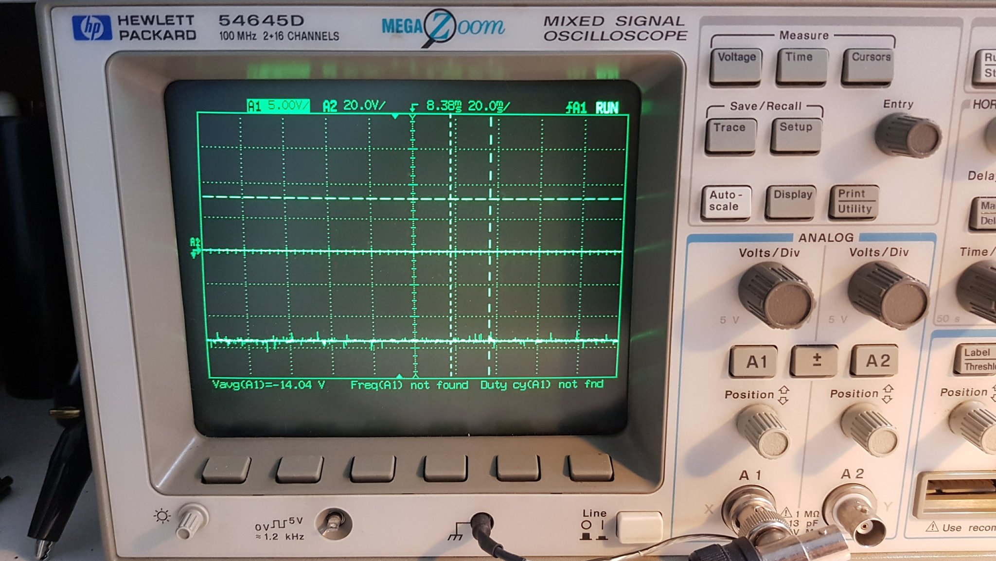

Photo 1 is the signal present on the jumper.

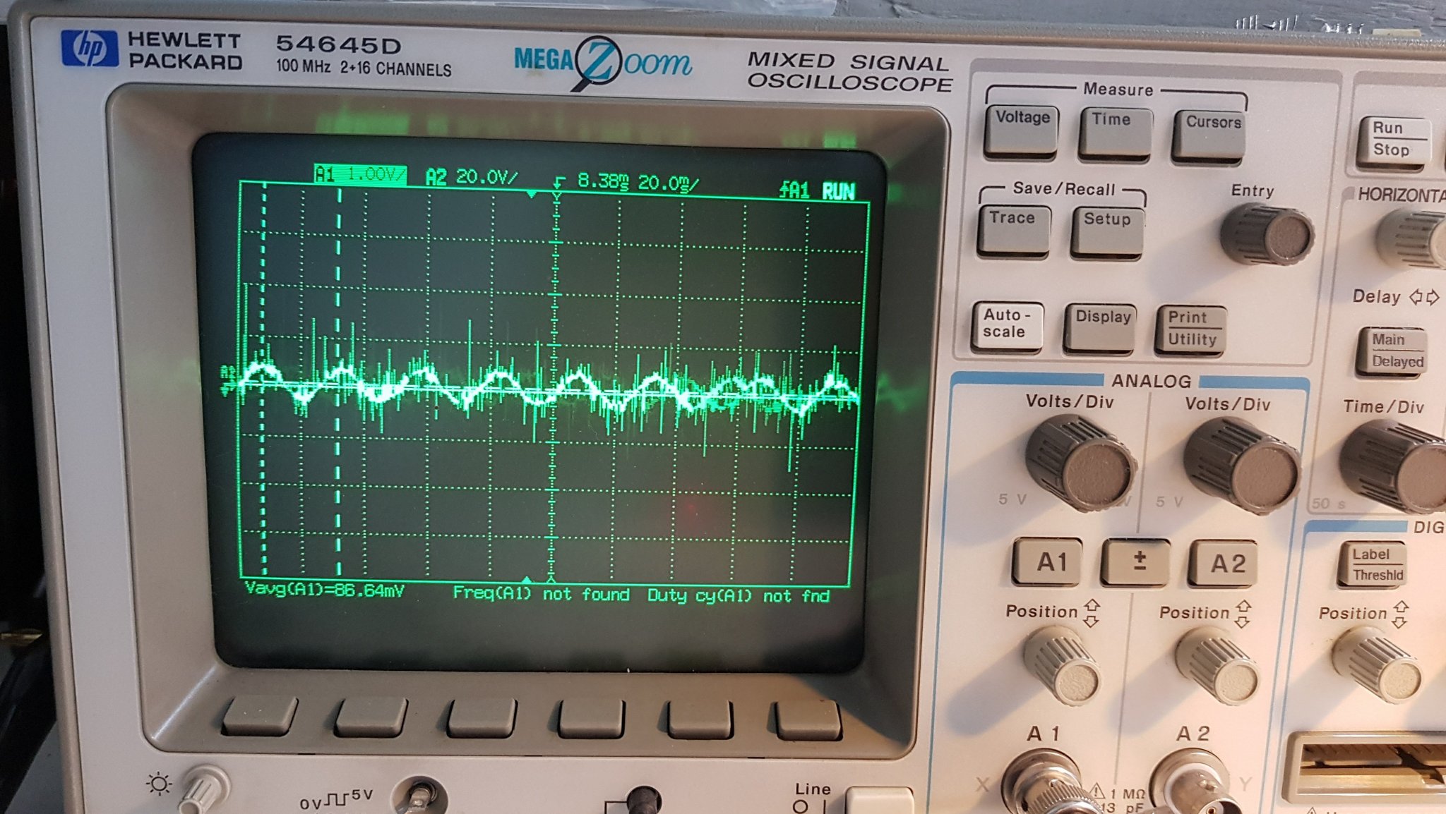

Photo 2 is the signal present on NE5532 Pin1 and Pin7 closest to the optocoupler. There is no audio present on any of the pins
The other NE5532 has a audio sine wave on the optocouplers Pin1 and Pin7

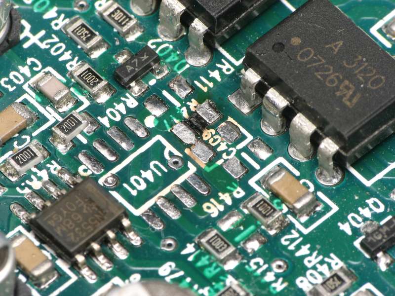

I found a photo showing the op-amp closest to the optocouplers as U401. I'm going to refer to the first op-amp as U400.
U400, pin 7 drives U401 pin 3. If you don't see audio on U401, pin 3, post the DC voltage on all terminals of U401.

I cant see any NE5532 marking numbers on the PCB, so I measured both.
NE5532 closest to the optocoupler:
Pin 1: -13.88v DC
Pin 2: 1.194v DC
Pin 3: 0.7v DC
Pin 4: -15.44v DC
Pin 5: -12.55v DC
Pin 6: -11.60v DC
Pin 7: -14.07v DC
Pin 8: 15.44v DC
Other NE5532:
Pin 1: audio signal (about 1.4v Peak to peak)
Pin 2: audio signal (about 0.8v peak to peak)
Pin 3: audio signal (about 0.8v peak to peak
Pin 4: -15.44v DC
Pin 5: audio signal (about 0.8v peak to peak
Pin 6: audio signal (about 0.8v peak to peak)
Pin 7: audio signal (about 1.4v peak to peak)
Pin 8: 15.44v DC
They are connected between U401 Pin2/ Pin3 and U400 Pin1/Pin7
Looks like the sine wave is getting drained down at U401 Pin2 and Pin3 pads (Pin2 and Pin3 are still disconnected)
3.65Kohm between U401 Pin2 and GND.
3.3Kohm between U401 Pin3 and GND.
