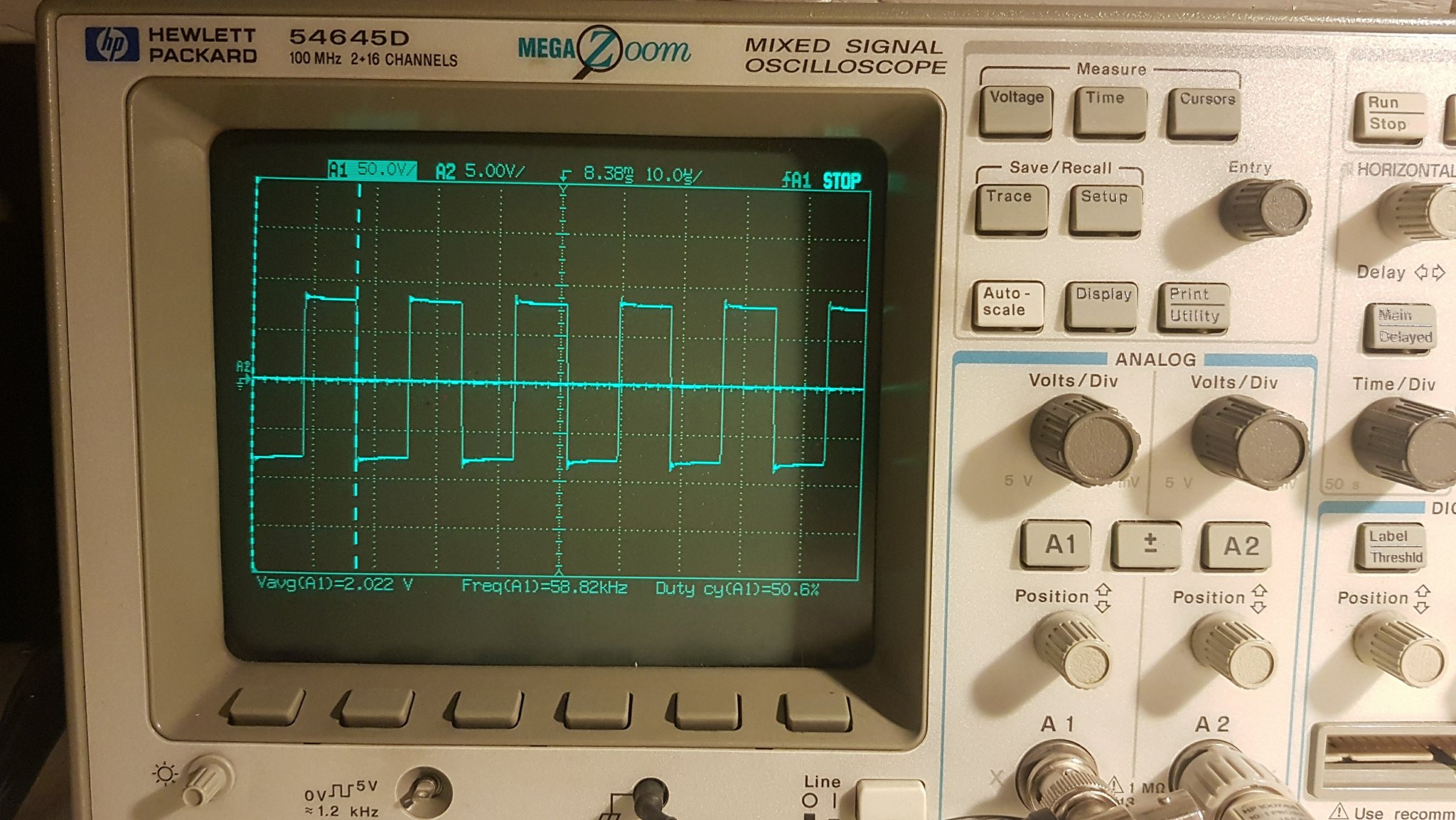

Output fet switching seems to work, I soldered one fet per bank (2 banks).
Idle current draw is pretty high, about 3.8A at 12.6v. U401 heats up pretty much, output inductors get quite hot.
The fet switching seems very clean for one fet per bank.

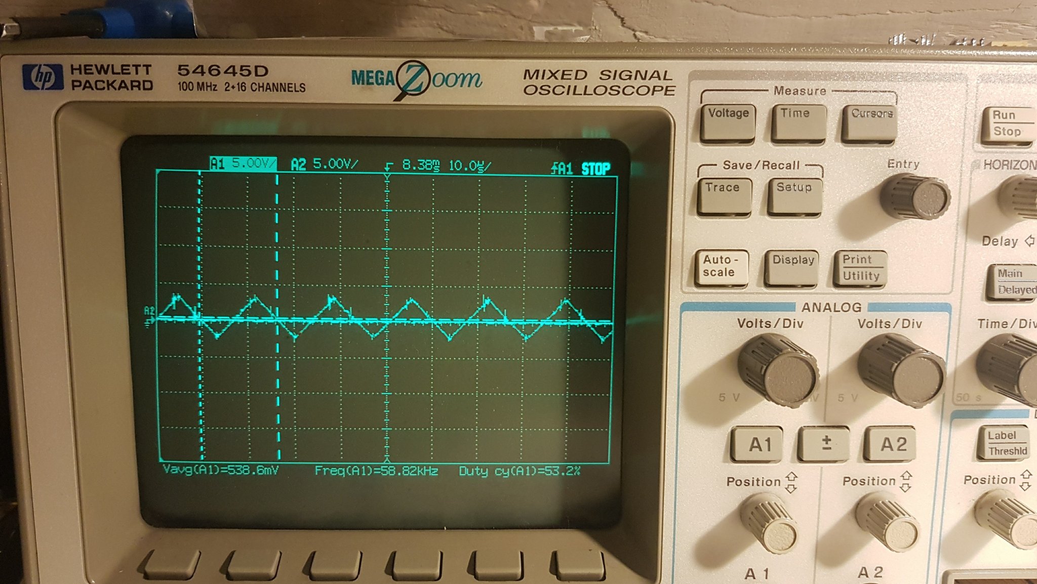

Unfortunately there is a perfect triangle wave on the + terminal (photo attached)
Other photo attached is the output fet switching.

I never measured the temperature but I know the inductors will get too hot to hold continuously.
The op-amp is very nearly driving a 100 ohm load at full rail to rail (±15v) continuously. Not a great design but it's generally reliable.
