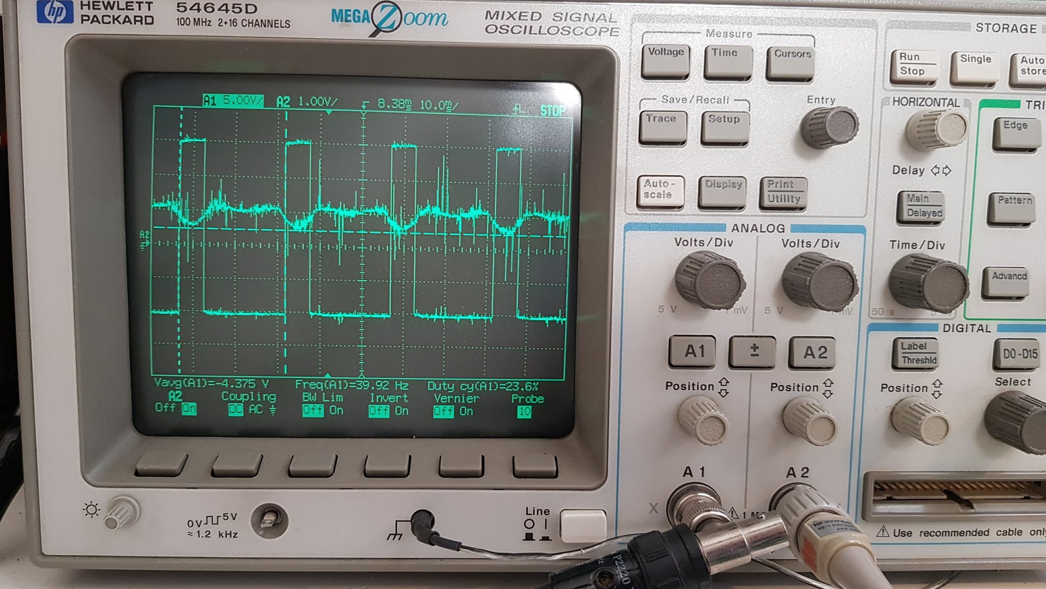

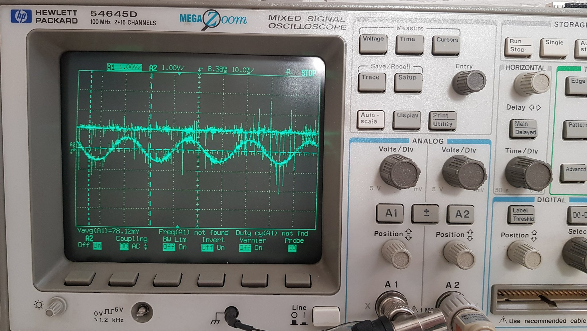

I found a critical thing.
The offset at U401 Pin2 and Pin3 explained in #110 is not supposed to be there I think.
I used an other device which can give a little stronger RCA signal. There was a low duty-cycle PWM signal at the optocouplers input.
The first photo is a sine wave (U400 Pin1 and Pin7), and the DC line is U401 Pin2.
IF the Utop from U400 Pin1 and Pin7 is rising above the DC offset at U401 Pin2, it starts to oscillate at the optocoupler (photo 2).
The strange wave is the signal at U401 Pin2 in that case.
So, signals above the DC offset from U401 starts to result in a pwm output. Directly explains why the dutcy cycle is so low.
Means that the DC offset at U401 Pin2 and Pin3 needs to be eliminated
