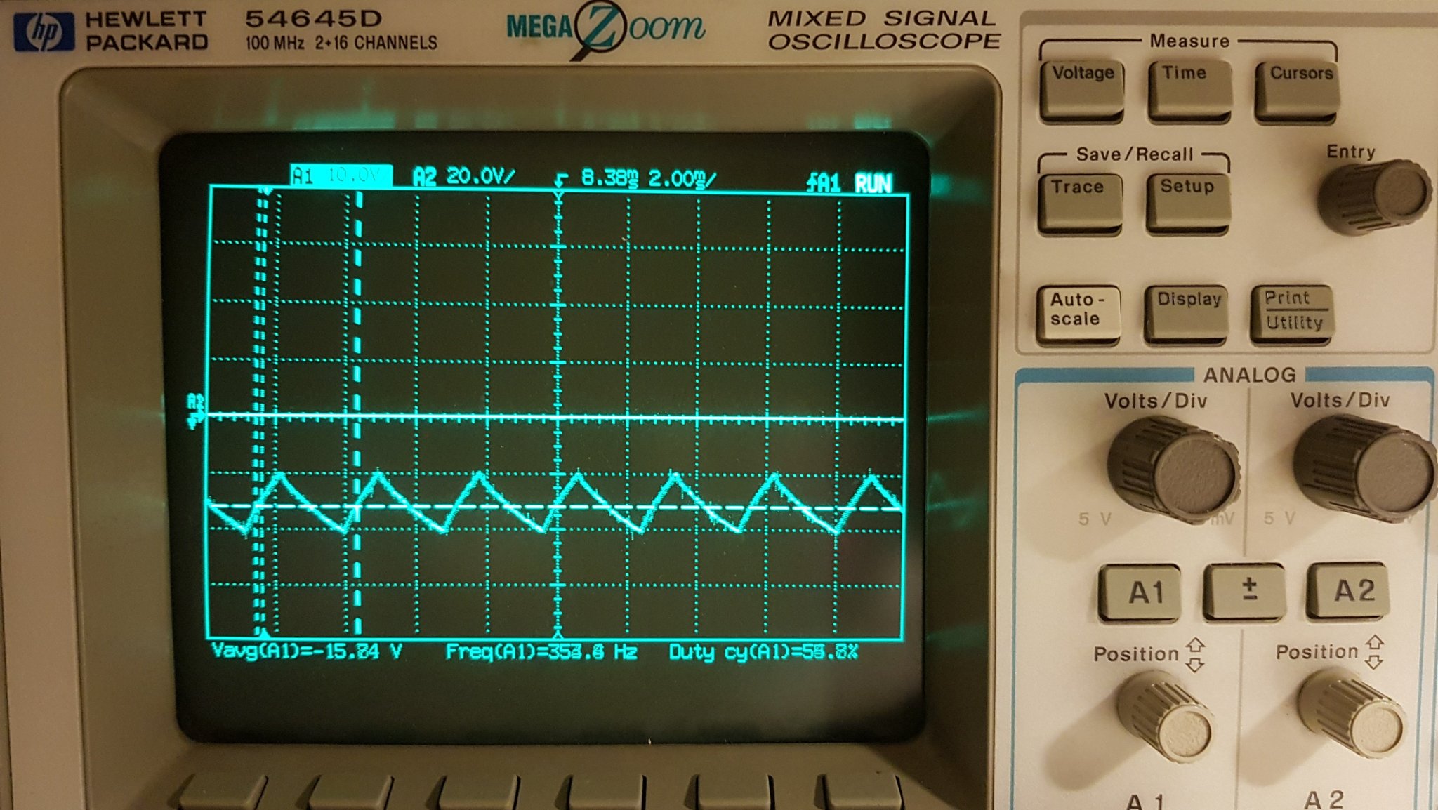

I re-measured.

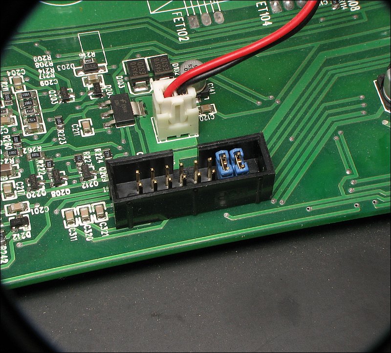

I think the connector of the separate filter board was plugged out for a part, readings are different now. Seems like the filter board influences a lot in this kind of mtx amplifiers.
There still is a 1k resistor and a jumper between 7805 regulator GND and C118-
C118- reads strange triangle wave - 15.76v
FET191:
Pin1: -6.66v strange wave
Pin2: 82v rail
Pin3: -0.5v same triangle wave as C118-
Both NE5532 output section.
Between Pin4 and Pin8 reads 30.5v and are still heating up.
Red LED400 and LED401 are still burning red.
In the photo attached is C118-

Jumper resistor between 7805 GND and C118- is now 1.8ohm.
Resistor does not heat up.
C118- now measures 0v (GND).

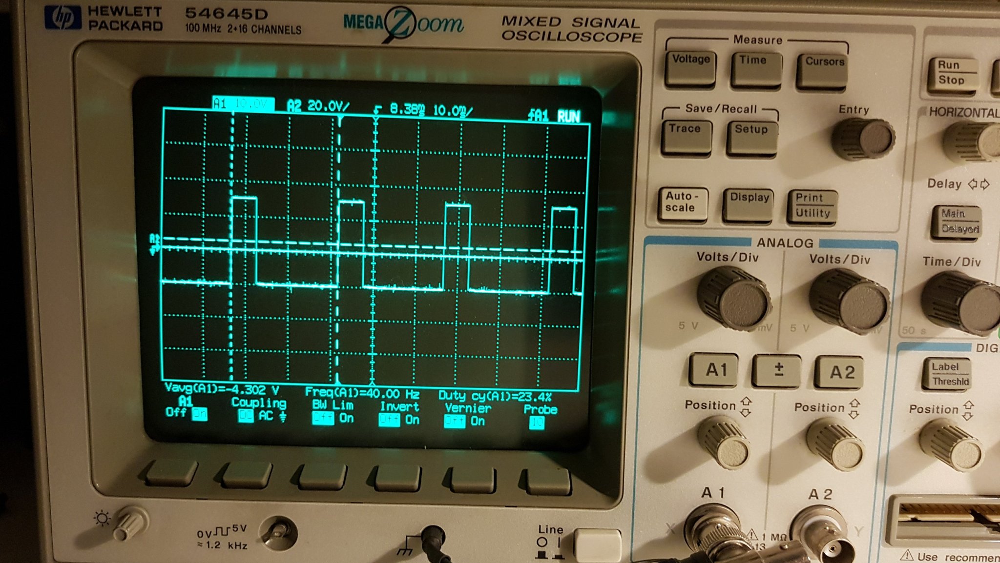

Nothing has changed. The amp had been layed down on the shelf for 1.5 month. Due tue personal matters I could not find time to repair amps.
Took it of the shelf this weekend, and boom, square wave gone. Tried to find the source of the output pwm generation, but I get no square wave activities out of it.
Also not with the jumpers and audio signal on the RCA.
