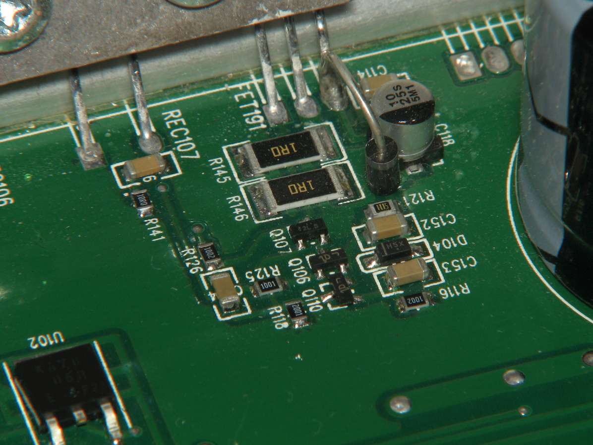

I've never seen anything like this.
In some of these amps, they started to add the Zener shown on FET191 that helped to protect the components on the board when the regulator failed (which was a common problem). This could not have worked if this was the negative regulator.
As this makes totally no sense, and this seems very strange, I think that my scope's channel possibly might be on reversed polarity due tue a previous differential measurement.
But, the readings that I had on FET191 were:
Pin1: strange waves +-39V DC
Pin2: clean -82v rail voltage
Pin3: sawtooth wave looking +-29v DC
If the scope was reversed, this means all readings from above would be reversed too.
Which means FET191 would have 2x negative voltage on the legs and a positive rail voltage.
I will check again later today when I'm back home. I will send more photo's of the board and double check the voltages.

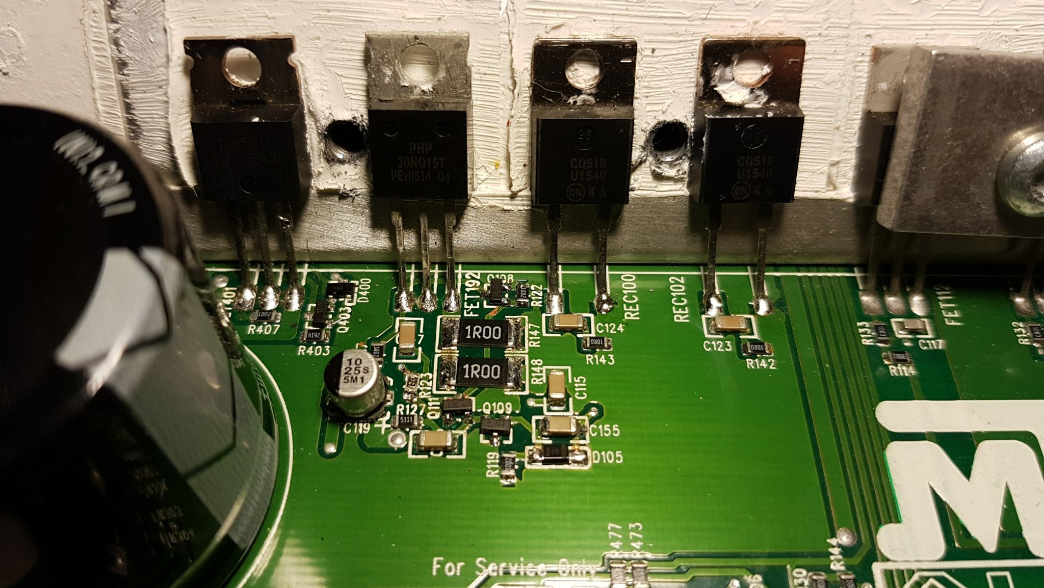

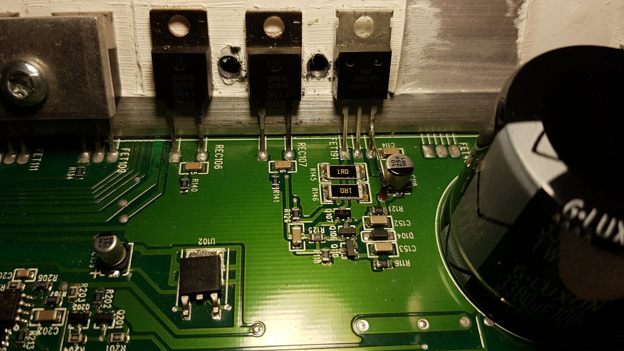

It appears that you have an open ground somewhere.
If you can't find the trace and the 1k works well enough, you could leave it. If the resistance needs to be lower, you could use a 1 ohm 1/4w. If there is a problem causing the ground to have voltage intermittently applied, the 1 ohm should open. Test a 1 ohm 1/4w connected directly across B+ and ground to make sure that it opens without burning. If the ones you have burn (mine didn't), use a flameproof resistor.
Something in the circuit is defective or the jumper resistor value is too high. The output should be 15v.
What's the voltage measured directly across C118?
