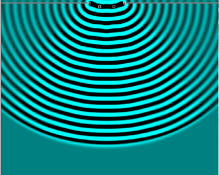

I didn't want to let this go unanswered, but a proper answer is beyond the scope of a post. I did a quick and dirty mockup to help make a point.When using a waveguide (e.g. 12” wide 90x60 dispersion), which topology would result in the most uniform dispersion between M and T?
I've assumed your waveguide was 12" tall as well. Sometimes it is assumed that a narrow vertical pattern gives a shorter looking waveguide but optimising the mouth requires further investigation.
Looking at the first attachment, where I have set a wavelength equal to the size of the woofer, the radiation appears to be not far from 60 degrees.
Interference appears to be playing a part in this. I had an example prepared for my earlier post (second attachment) where I curved the source. The radiation appears to be slightly more wide. I'd put this not to the source pushing wider, but to a reduction of HOM.

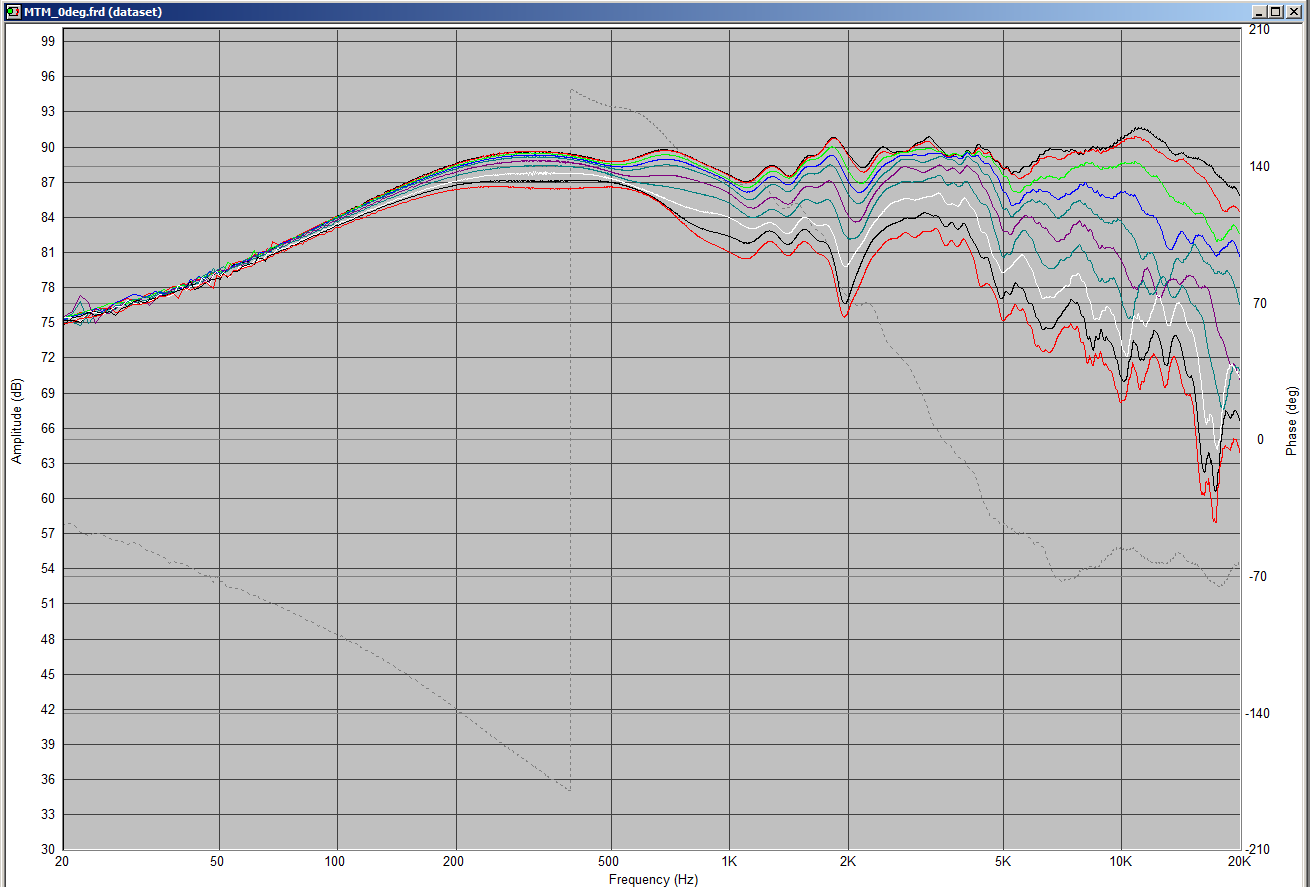

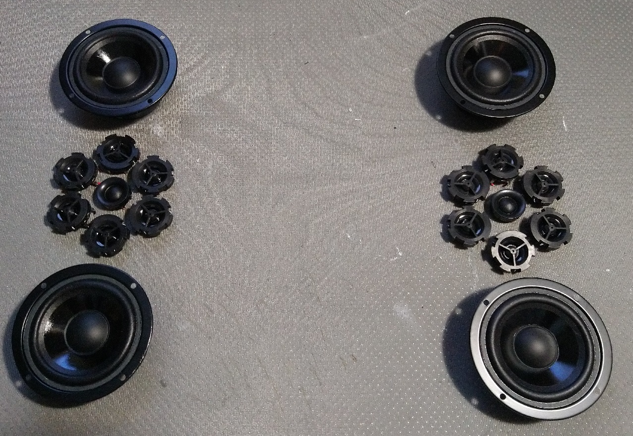

I'll join adason in posting polars of my MTM 🙂 (horizontal, no vertical) edit: the steps are 10deg

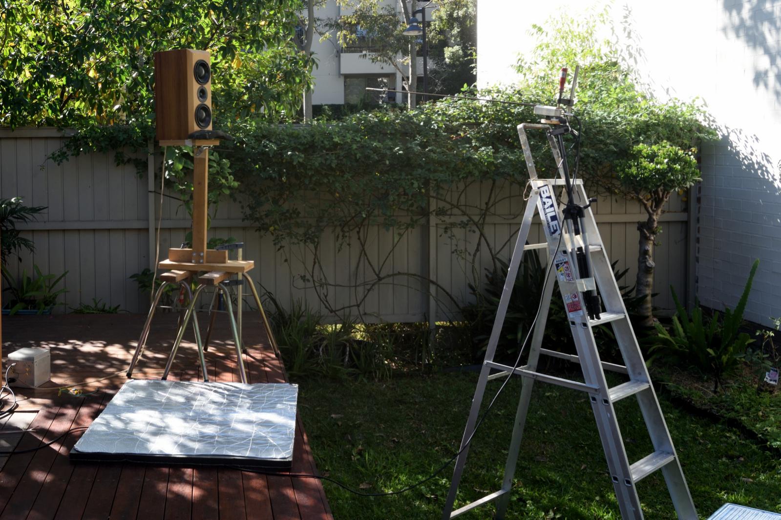

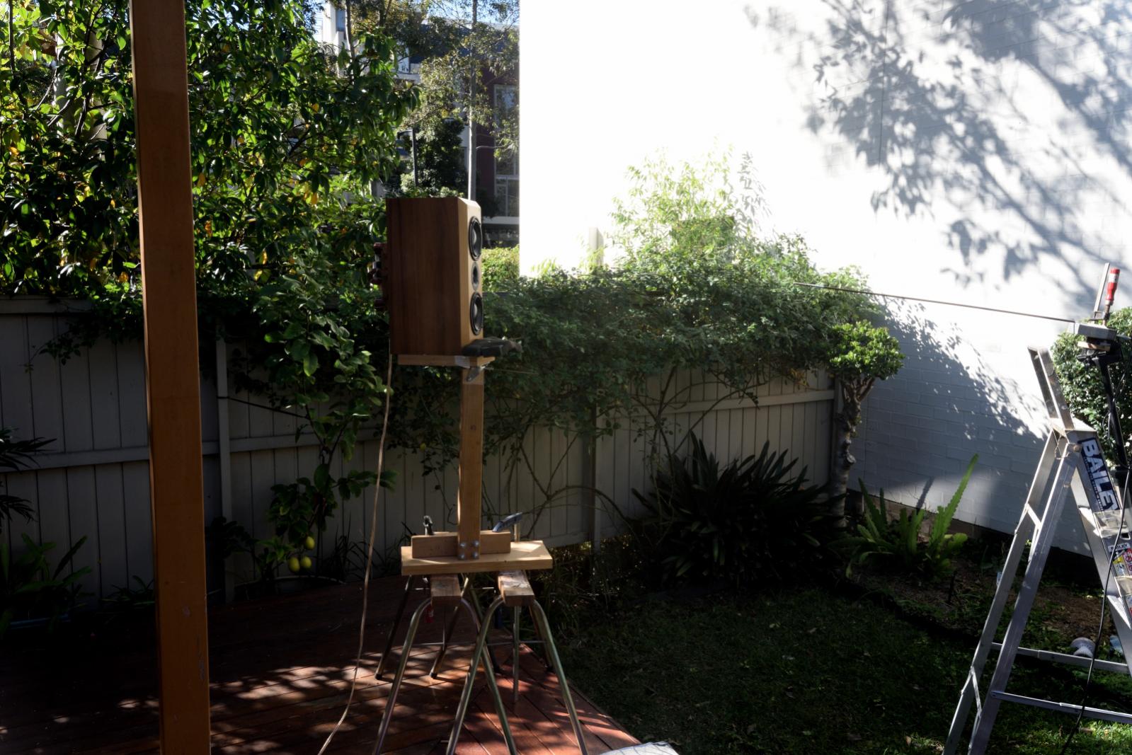

The pictures show the test setup when taking them. Not ideal and I do need to come up with a better system.
From 270Hz down they are actively crossed to a couple of Vifa M26WR09-08's The design goal was never for them to have bass extension.
The crossover frequency is (horror of horrors) 2.8Khz fourth order bessel (acoustic). Which coincidentally (even more horror) is exactly 1 wavelength based on the CTC distance between mid and tweeter of 122mm...

Measurement graphs are always interesting to watch, and i can see that the area between 2-5khz is a bit hot, have you tried to decrease this output?
Yes it is interesting, that particular measurement is not characteristic of most of the measurements I have done, it is normally a bit hot between 1 and 2Khz, and there is actually a notch there, and on reviewing this one I was thinking that that notch could be reduced.

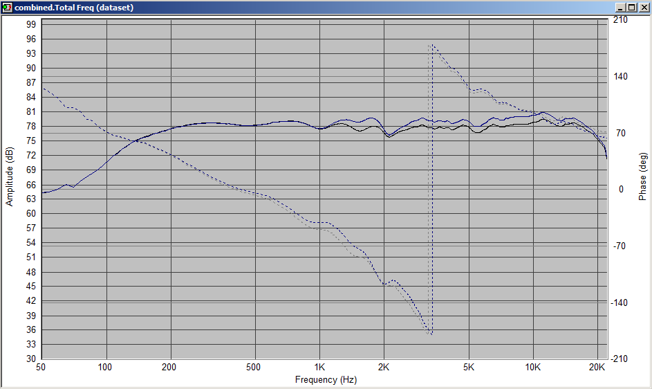

I took full 180 deg horizontals of each of the three drivers with the intention to do a new crossover, but I found some anomalies in the measurements and was going to re-do (that was about two years ago) and I still haven't done so. I need to make a better turntable as this one gets unstable post about 100 deg, also need a bit bigger space!!
Attached is a graph showing a different measurement with a sim of a new crossover I did a few years ago (but never got around to implementing) Not even sure I can find that particular version. I believe that should have been the same crossover, so I'm not sure what happened the day I did the polars, as I normally get very consistent measurements.
I did more measurements later of the individual drivers for the polars but not of the speaker, I suspect there may have been something wrong that day.
If I do a new crossover, I'm going to try and get a bit more efficiency these have close to full baffle step comp factored in and have a hot spot in room around 500Hz.

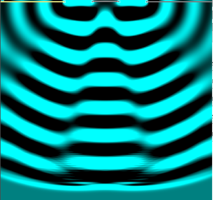

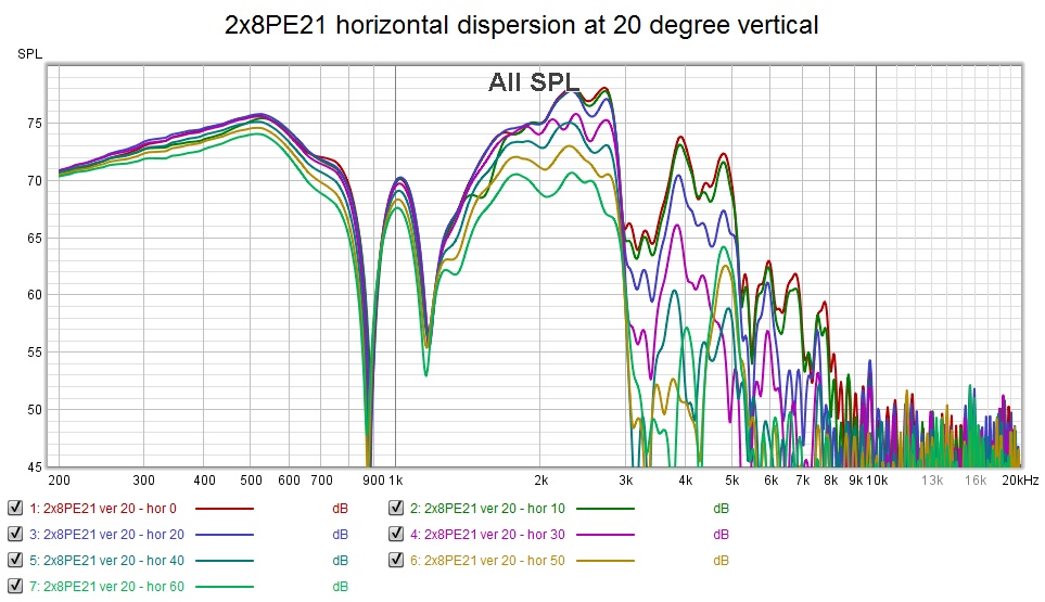

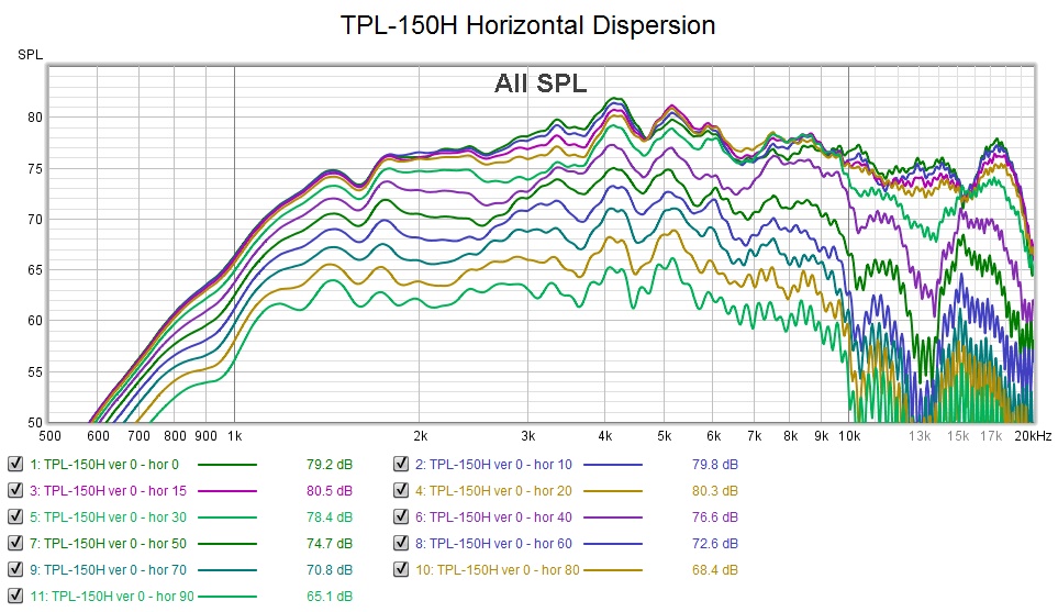

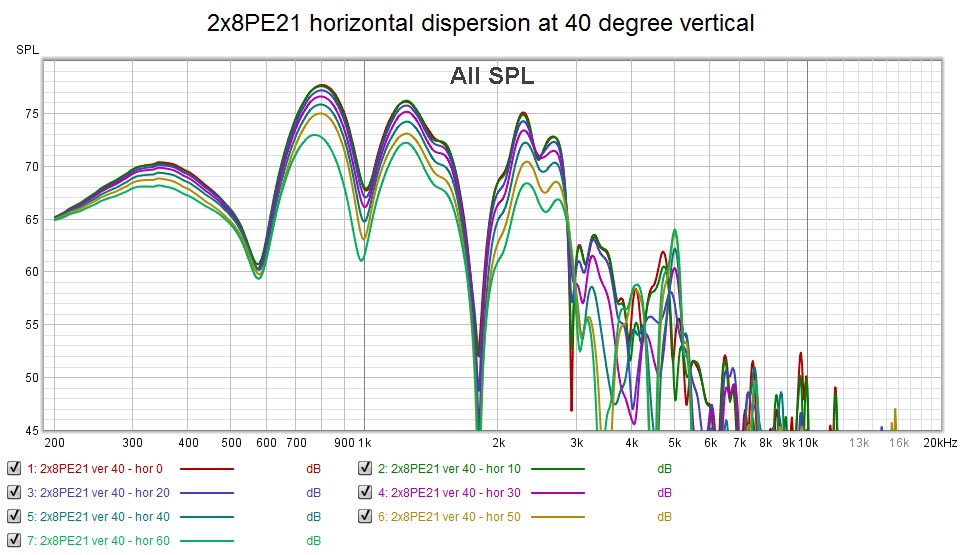

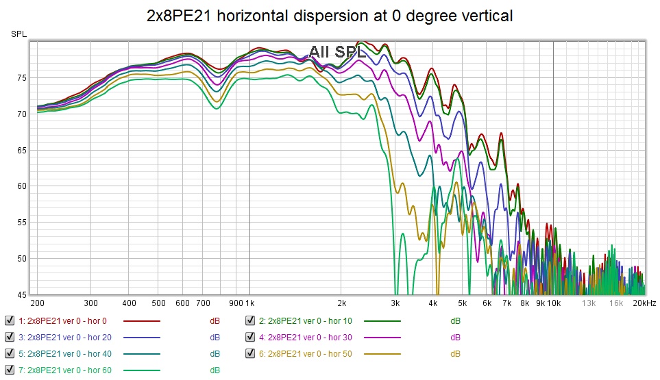

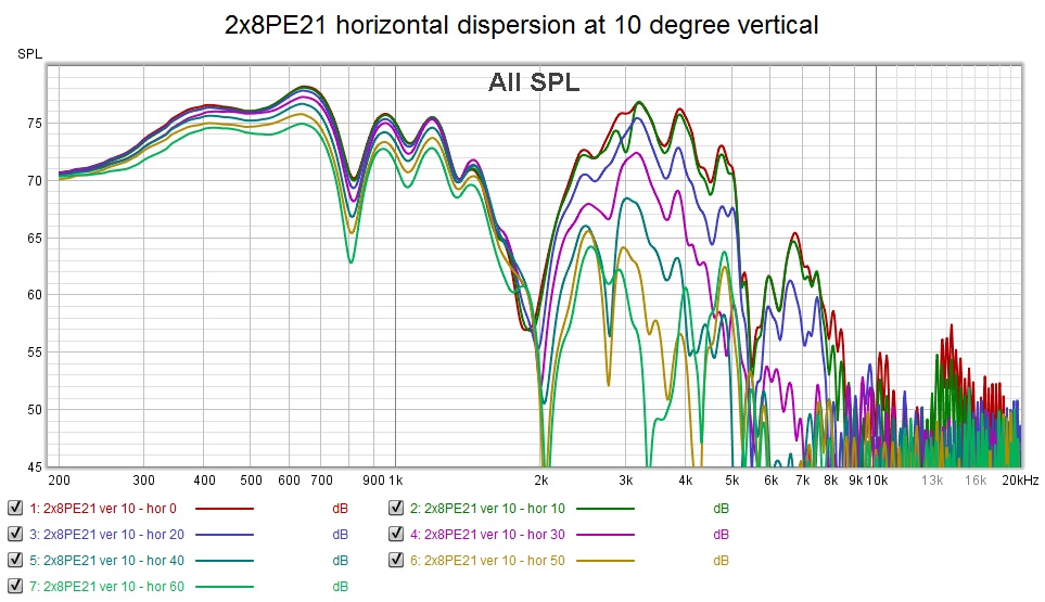

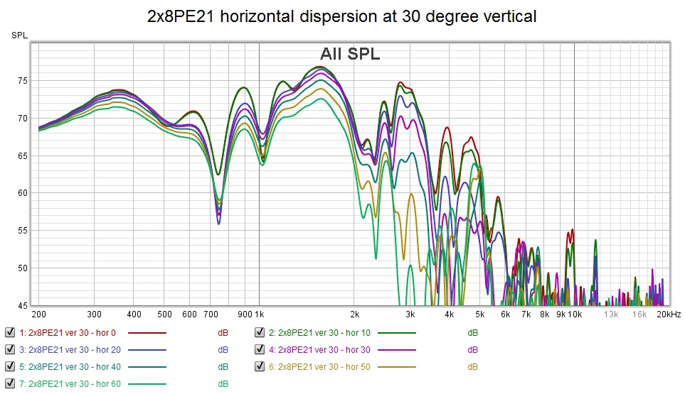

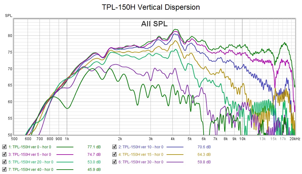

Here are some measurements I took. TPL-150H plus two 8PE21 in MTM. Measured the TPL alone, then the the twin 8" alone. Horizontal and vertical.
Where do you think I should xo them at, slope? What do you think of the vertical dispersion?
2x8PE21 horizontal dispersion at 10 degree vertical.jpg196.3 KB · Views: 276
2x8PE21 horizontal dispersion at 20 degree vertical.jpg192.1 KB · Views: 128
2x8PE21 horizontal dispersion at 30 degree vertical.jpg191.8 KB · Views: 116
2x8PE21 horizontal dispersion at 40 degree vertical.jpg183.1 KB · Views: 119
