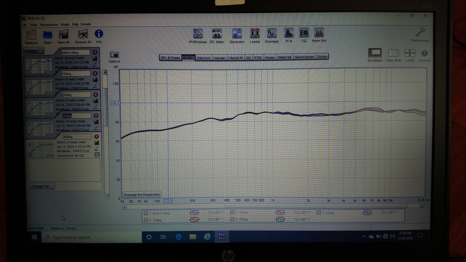

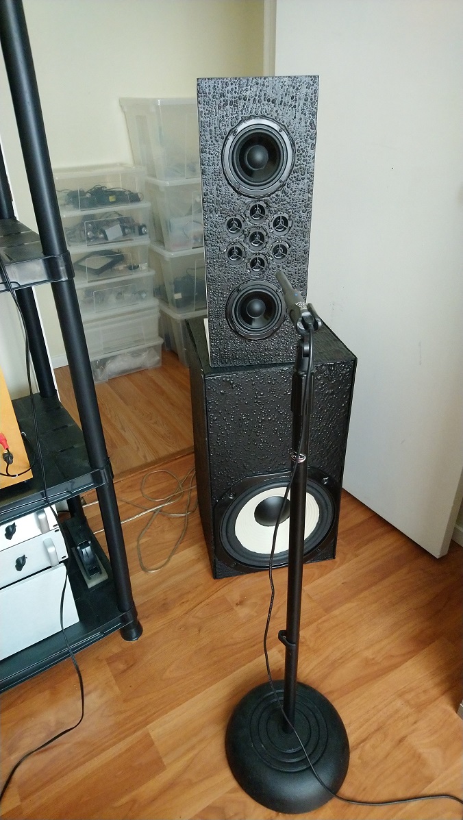

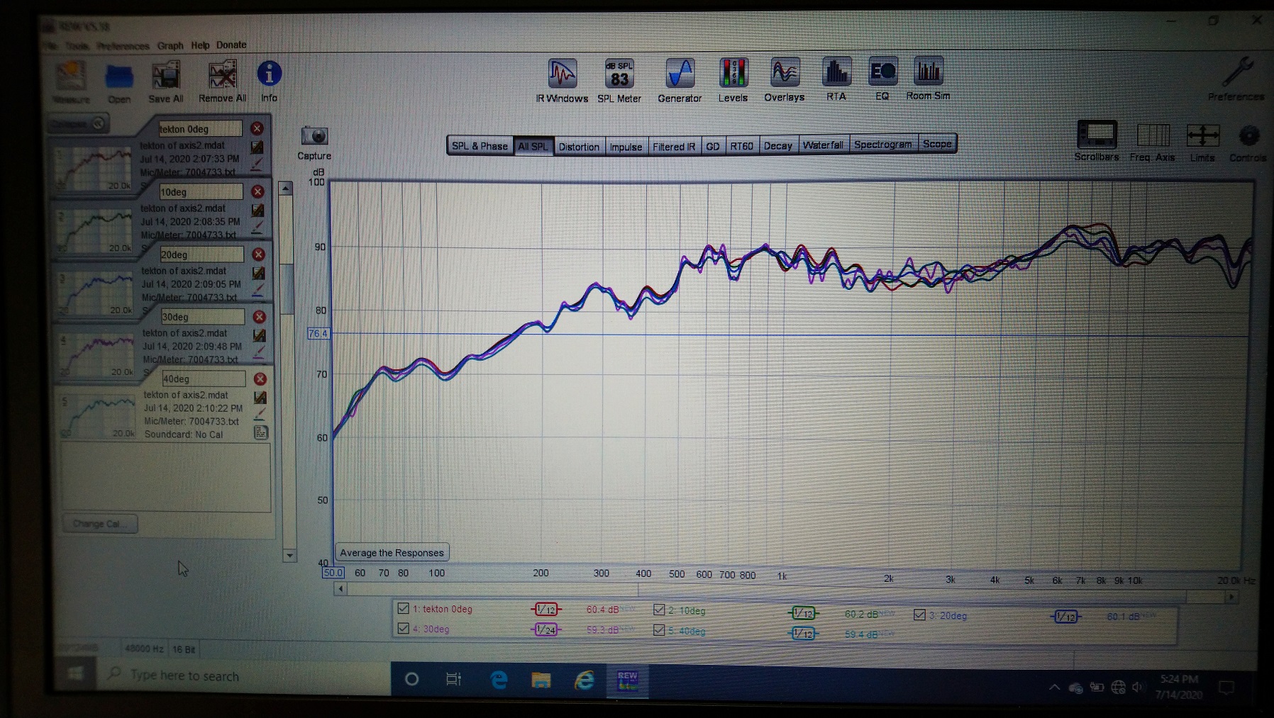

What do you think of the vertical dispersion, especially the twin 8"? Does it look like poor measurement (measurement artifacts, like reflections)? On vertical axis it looks good, but past 10 degrees it looks kind of nasty to me. Not sure how concerned I should be.

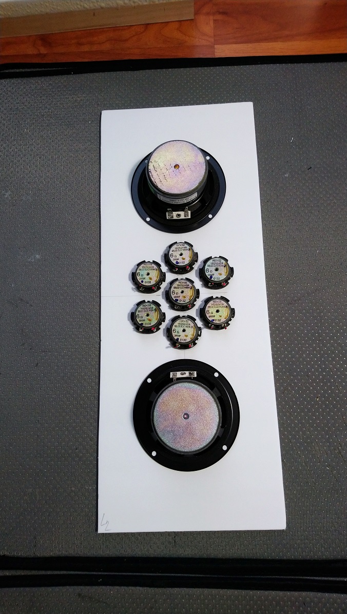

Where do you think I should xo them at, slope? What do you think of the vertical dispersion?
I'd cross over to the TPL-150H somewhere around 1250hz to 1750hz ( based on your posted polars ).
Build some test boxes ( 1 for each component ) and then swap back and forth between a TMM and the MTM arrangement.
Choose the configuration that you like best.

Is your assessment based on horizontal dispersion only or vertical as well? How do you read verticals?

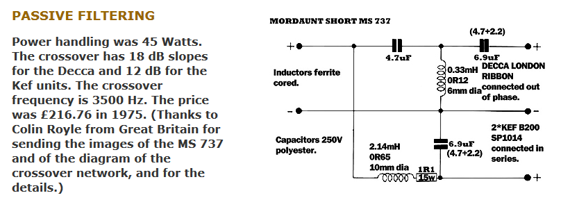

It's all been done before, of course. So maybe is a good idea.
People used to use 1 or 2x 8" bass and a Decca Kelly ribbon back in the day.
Double it up to TMM or MTM style:

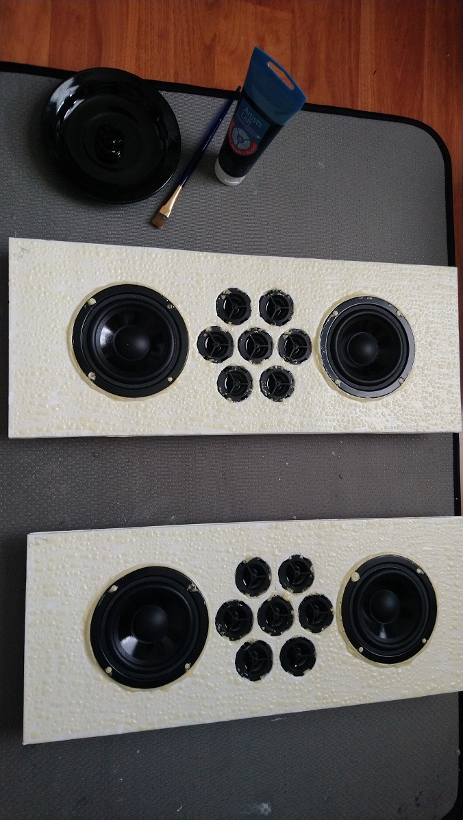

Yes, it's been done before. Here's a commercial speaker: Divin

I sit at 2 metres rather than 10, though. Which is one of the largest question marks I have.
It looks pretty - as does MTM ;-)

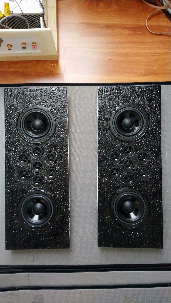

made some progress
made some measurements today and did some easy listening
measured response is just MTM, no woofer, hence some early roll of due to open baffle cancelation (I plan to finish sides)
it has impeccable of axis response
sounds great too
sounds great too
Thanks I'm guessing that there are room effects in there as well. It's better than I would have expected!

i have not tweaked the crossover yet, i believe that hump at 6-7kHz can be cured by inserting resistor to the third section of those flanking four tweeters on each side, they are coming in too hot
first section is just one central tweeter
second section are those above and below, in series, thus double the impedance
but third section are four series/parallel, so the same impedance like one tweeter, so obviously they need taming
