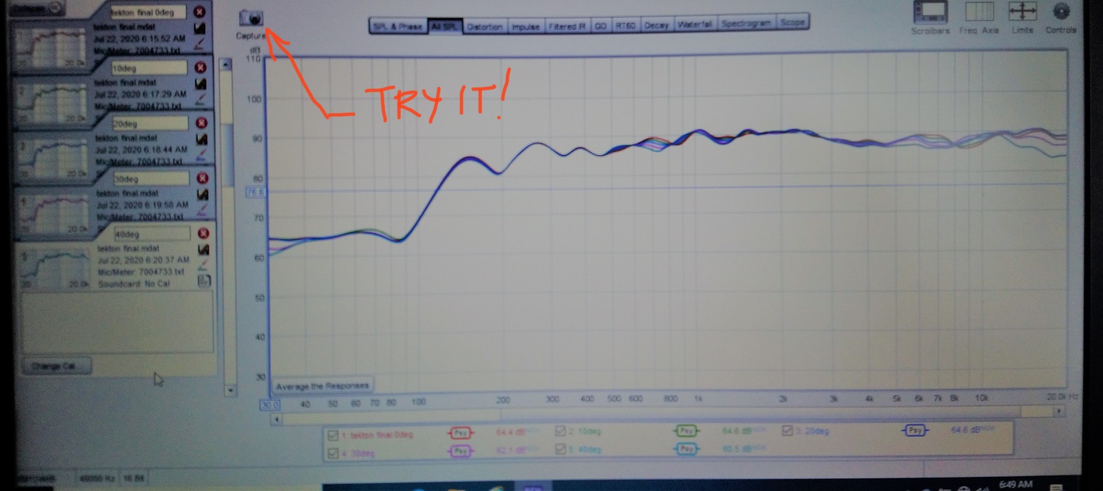

That MTTTTTTTT...TM looks great! I have always wondered if the compound eye approach would sound good. I guess it does!
Btw, instead of snapping a photo with your phone, try clicking the “capture” button.

Hi X, thanks for the info about the capture button. I know about it. Since i have multiple dedicated laptops, the one with rew and soundcard is not set up with internet. I could transfer the capture with memory stick, but its just easier to use phone. I guess i am just lazy this way. I may improve over time 🙂

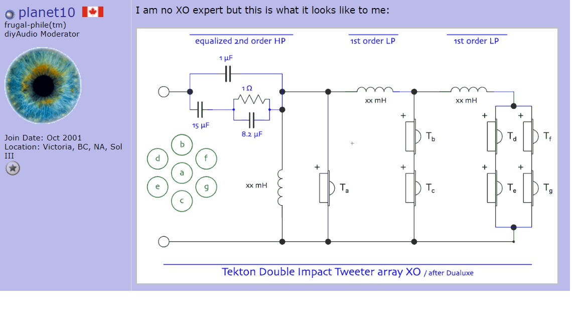

Adason,
Great work. I'm interested.
I realize back on post #98 you told me you "do not shimulate", but I'm looking into it to learn. Attached planet10's depiction of the Tekton xo, which you linked to on #99.
Would you mind sharing which drivers you are using and the inductor values marked "xx mH" you are using, as well as any other parts you might have changed from this. I do not have the drivers nor the xo parts, and would like to shimulate to help me understand the design.
