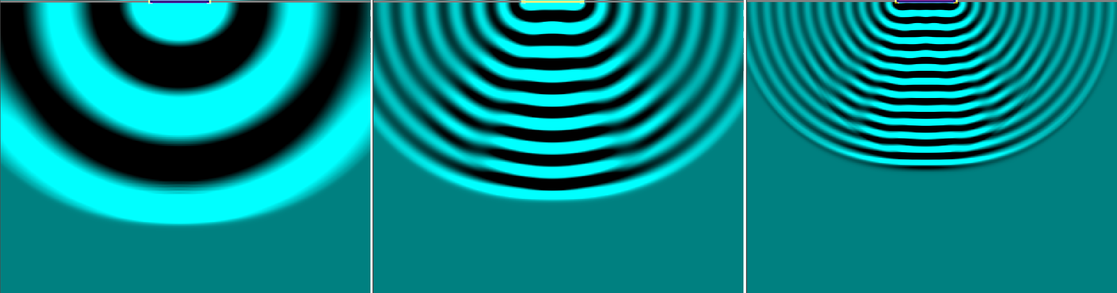

Seems reasonable. I see here an apparent virtual source behind the radiator, indicating primarily spherical radiation, and some higher order modes due to diffraction. Otherwise there is directivity.

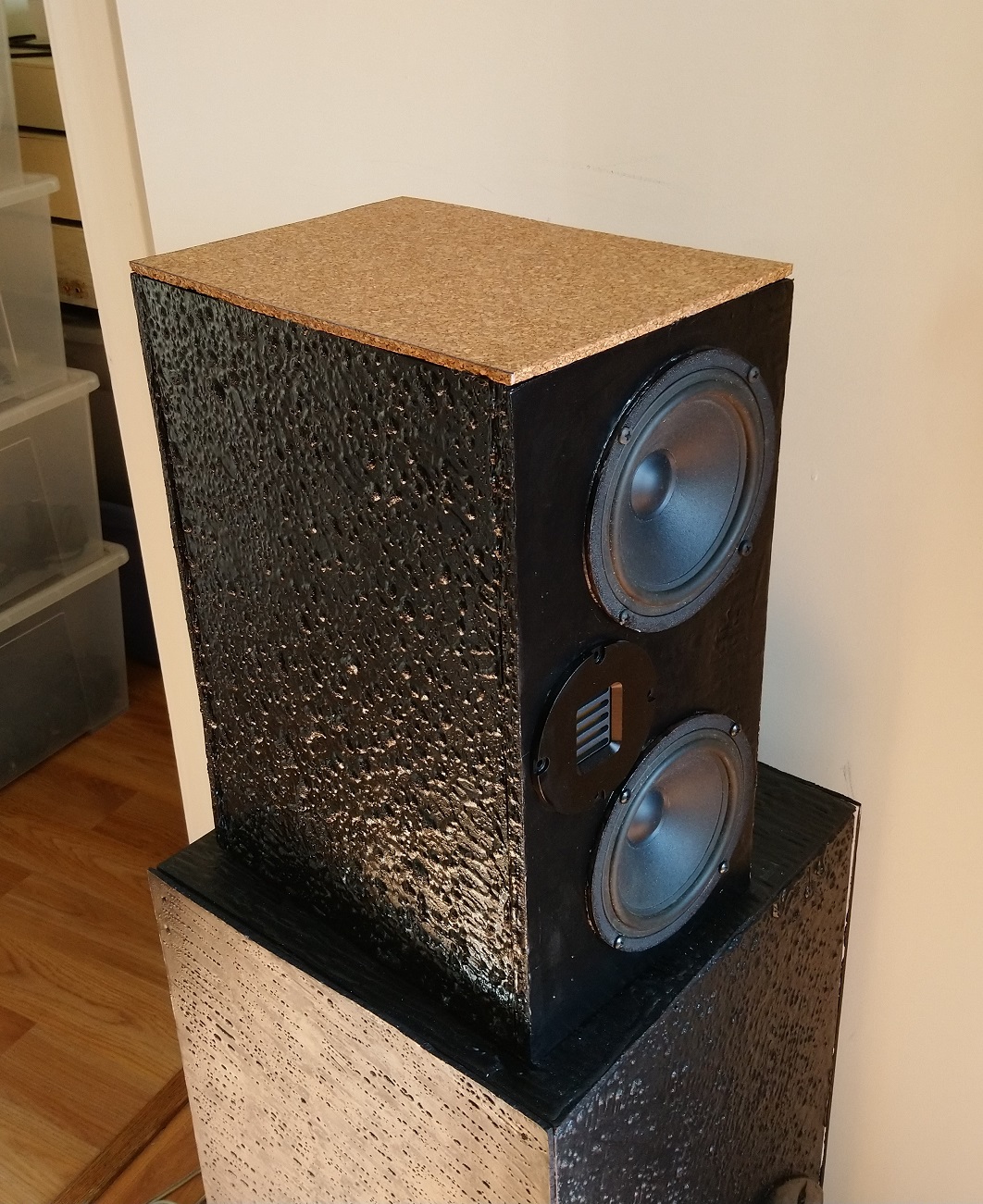

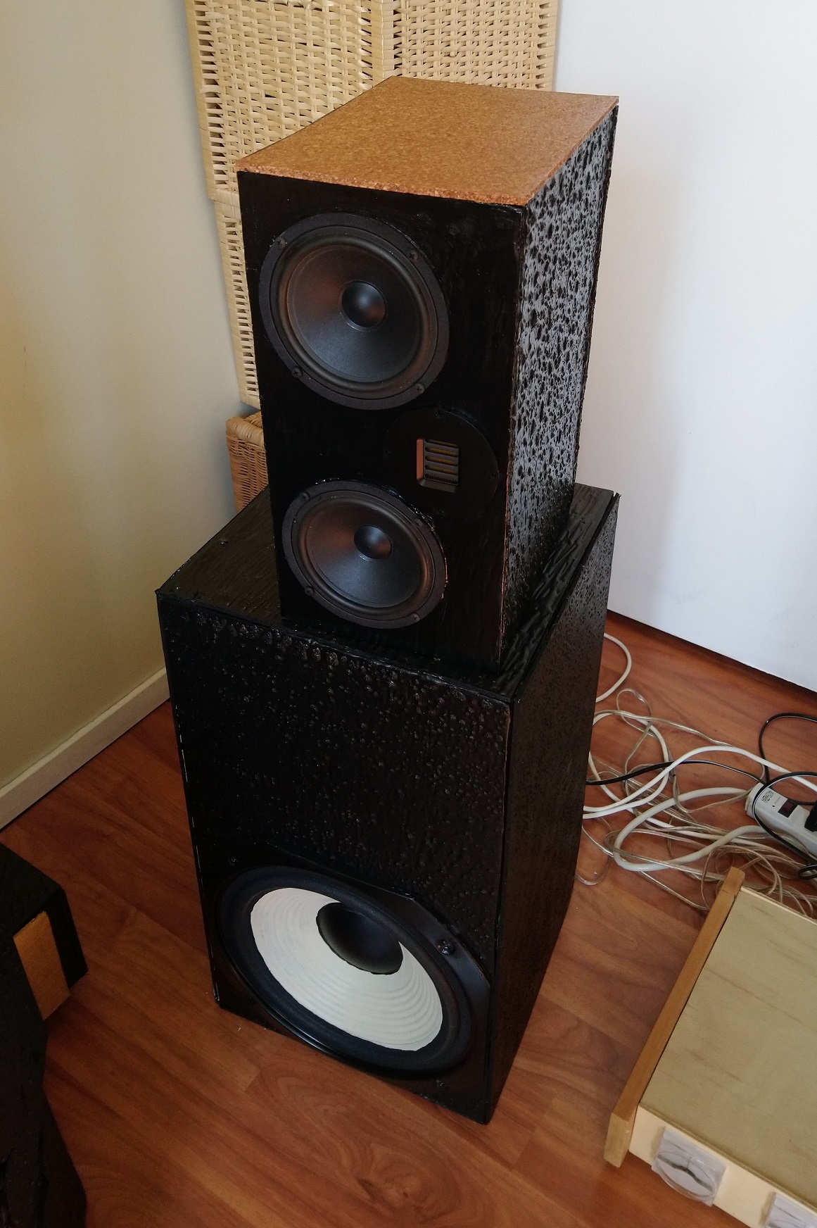

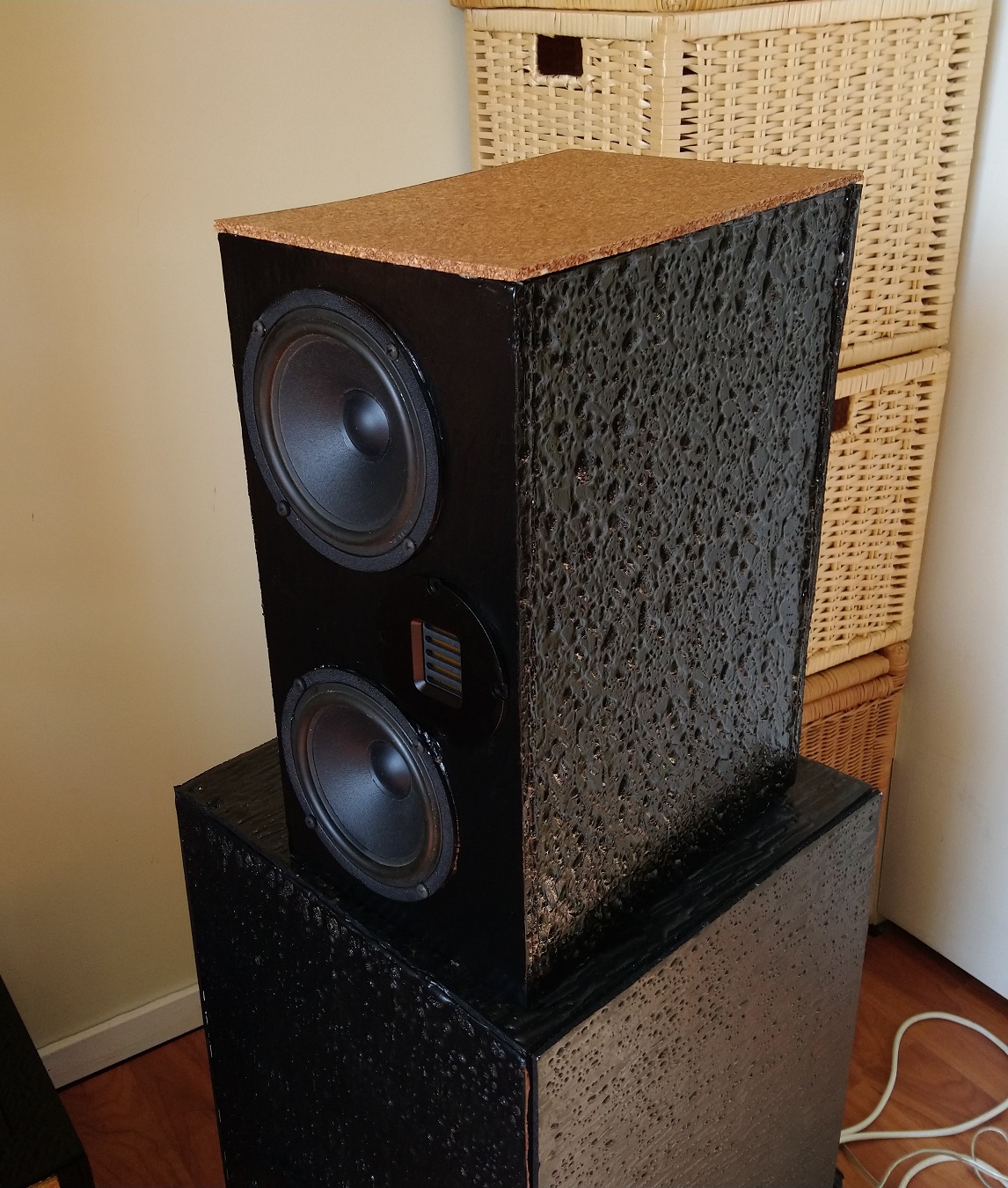

here is my vifa mtm, with amt tweeters, the most neutral speakers i made so far

Long ago Speaker Builder magazine published D'Appolito's "Swan" design. It used an MTM on top of a large bass box. I remember he wanted you to cut the top and bottom off a Dynaudio tweeter so the M-M distance could be as small as possible. I still have the drivers in a box if I ever get a free moment to build it. Given that the Dynaudio tweets aren't available anymore, I'd be hesitant to cut the plates, even though I have a pretty good metal shop.
music soothes the savage beast
Joined 2004
suit yourself! (you are obviously wrong, you can make any speaker flat on axis)

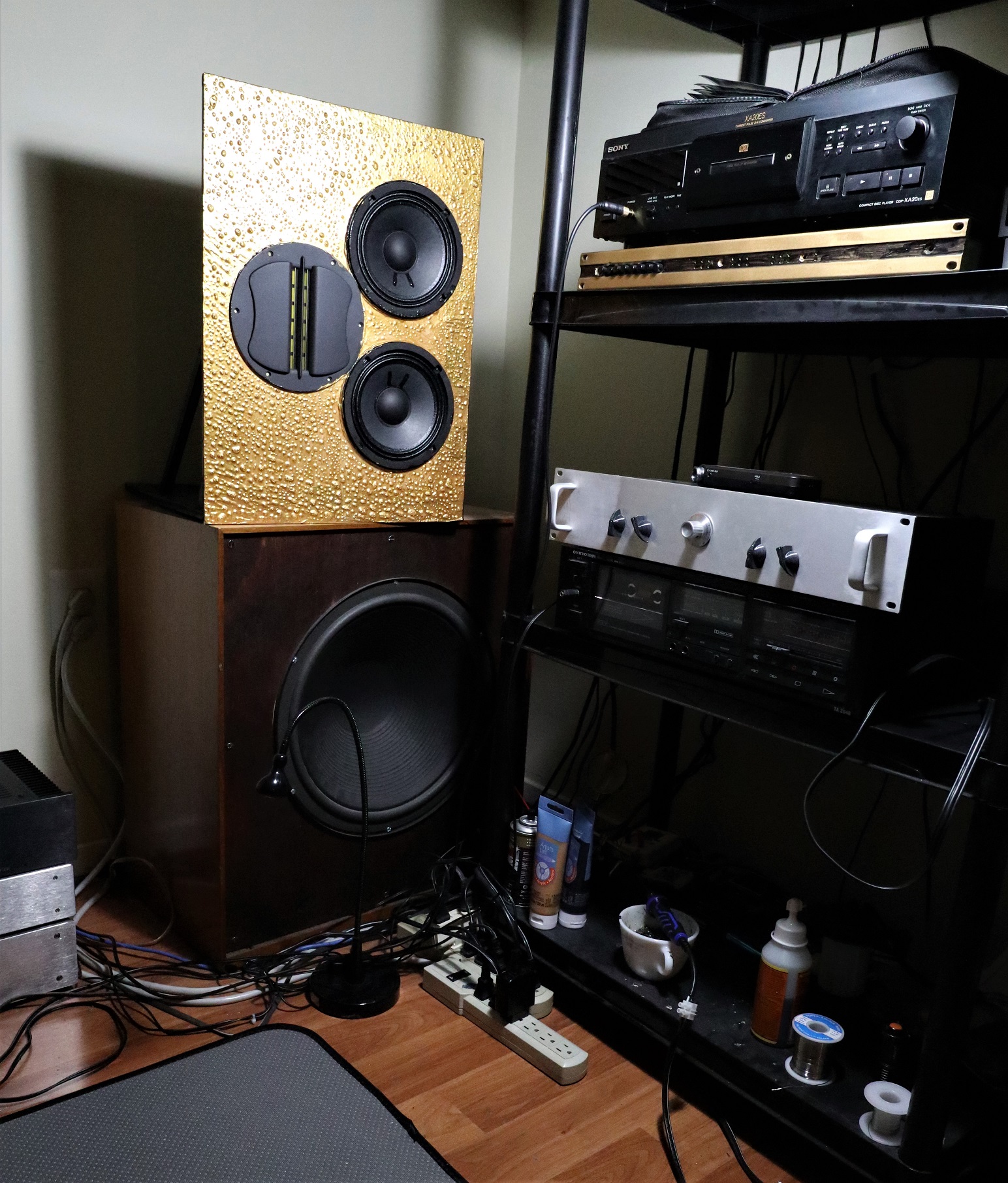

ok, this is last post with pic, even I have made many other mtm based speakers
i made mtm with dome mids, and even removed front plates to make spacing with tweeter much closer
now this is my best speaker so far, resides in living room, it actually is 2.5 way mmtmm, on dual 15" woofers
