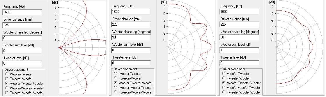

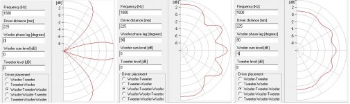

Large tweeter: Beyma TPL-150H. So midranges are 450mm (17.7") c-t-c which is the closes I can get them without cutting into the horn. That's a wavelength of about 750Hz which is too low for the TPL. I'll take the even order LR 4th order or higher for experimentation.
What's you view regarding time alignment vs phase in MTM? Playing with Xdir I see I could get very nice polars with the above separations, xo at 1600Hz, by introducing phase lag of 90 degrees at xo point and reducing woofers by 6dB vs tweeter. Polars look good, but time alignment would be lost.
forgot to add the attachment!

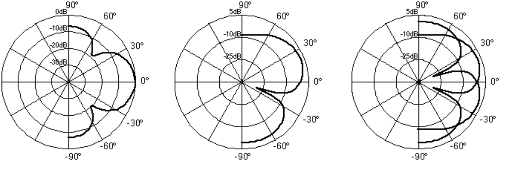

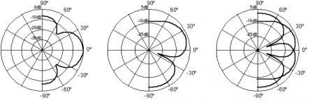

Showing the 90 degree phase style. Based on the images in GMs link I mirrored one image to show the effect.
a) Linkwitz-Riley, full output in the forward direction, this is symmetrical so mirroring it achieves nothing in particular.
b) A single MT with 90 degree phase difference.
c) An MTM based on 'b', more even dispersion. Done this way, the peaks and nulls line up.
