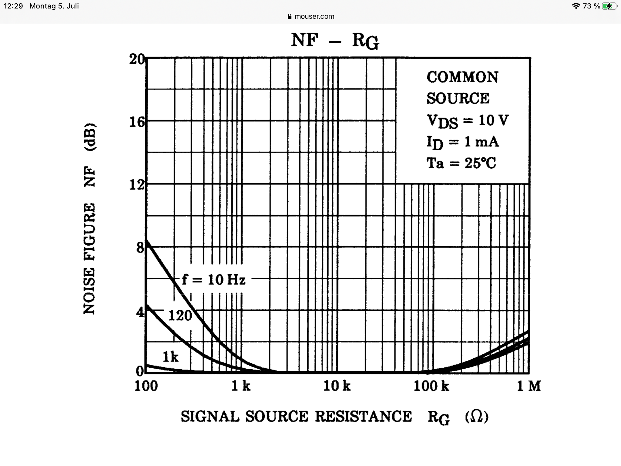

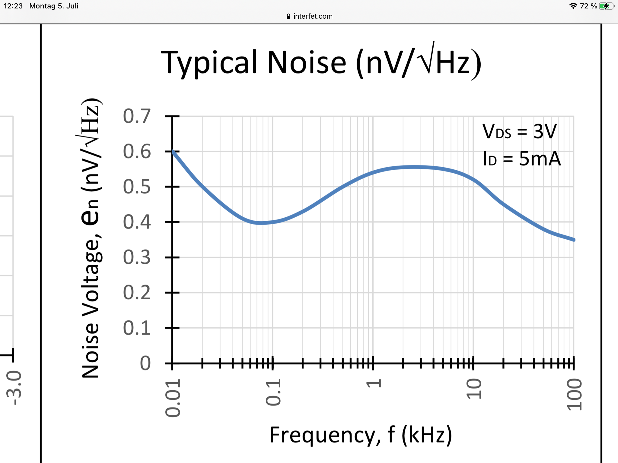

Joachim,
Is the choice for IF3602 based on noise ?
If soo, would multiple 2SK369 in parallel not give similar results ?
Thanks,
Patrick
Thanks,
Patrick

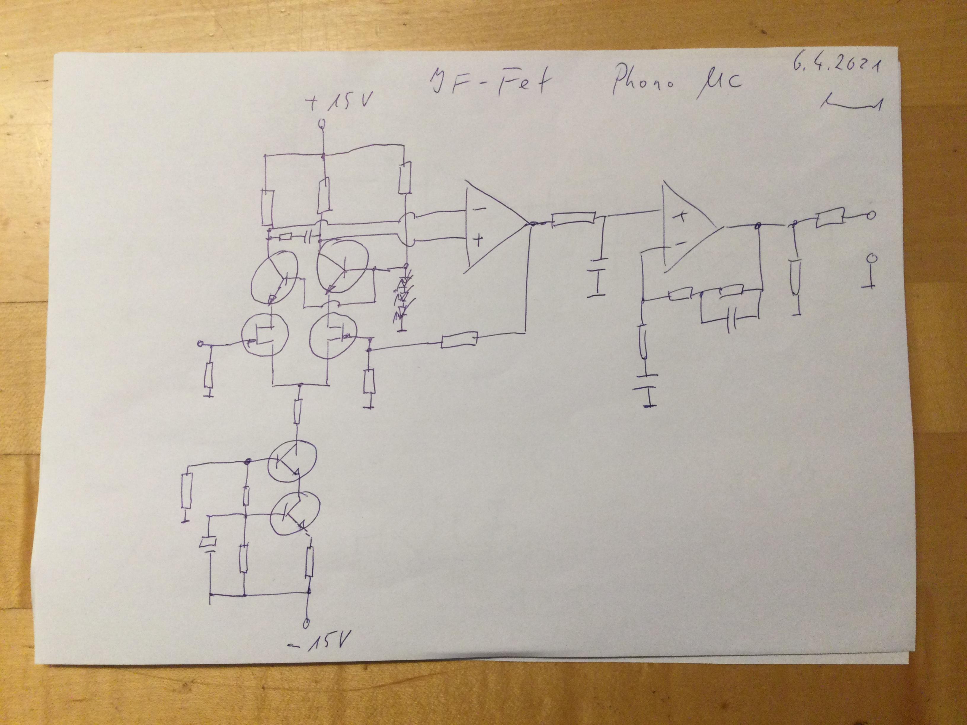

Of you want to get 750mS you need a massive amount. In theory it is possible though. We called that paralleling for low voltage Noise Faulkner Circuit in the old days.
Using the Spice Model from Interfet, I calculated the Yfs of the IF3602 to be ~ 160mS at 20mA.
The same can be achieved by 4x 2SK369 in parallel, each running at 5mA.
Capacitances are the same or somewhat smaller.
And I think noise is same too, at least at 1kHz.

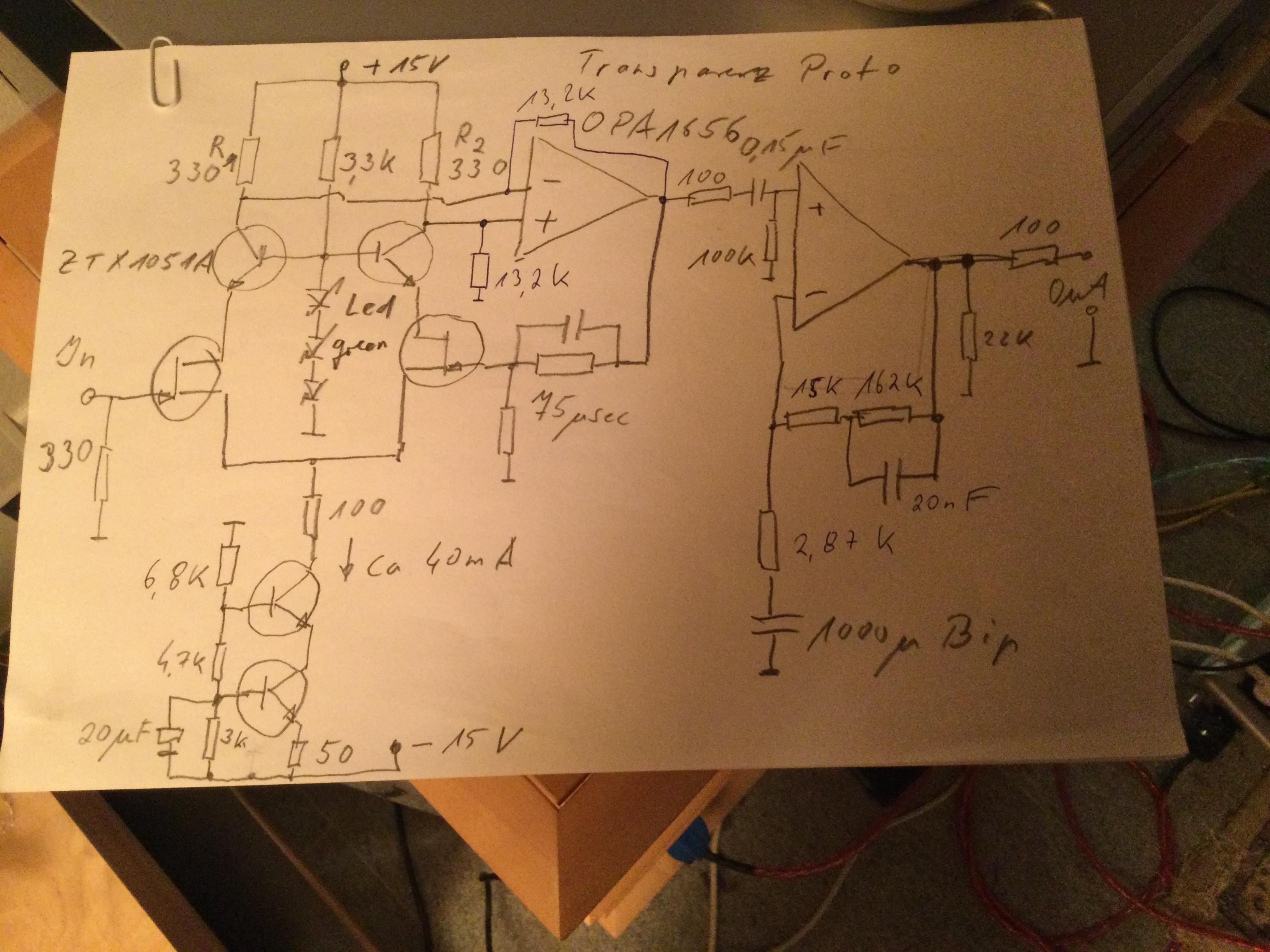

I do not know exactly why but I like the sound of the Interfet. It is very clean and open.
I will try to raise the idle too.
For example when I take away one green LED the Fet runs on ca. 2,95V. When I raise the idle to 100mA each half we burn 0,295 W ( V x I ). That is what the Fet just can stand in dissipation.
Sorry, both sided contribute to the heat so 50mA each is the maximum we can reach under those conditions. Anyway, I will measure the actual circuit to see what voltage is over the Fets right now.
