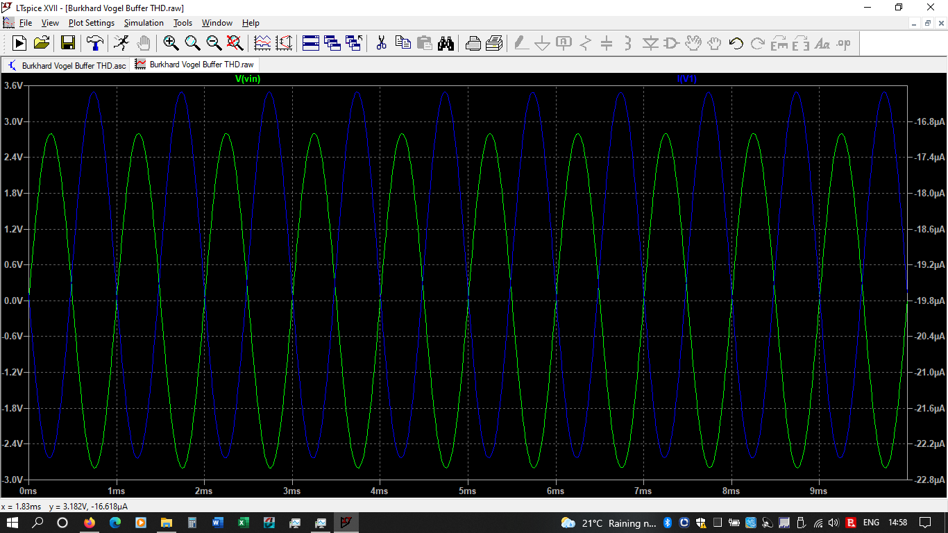

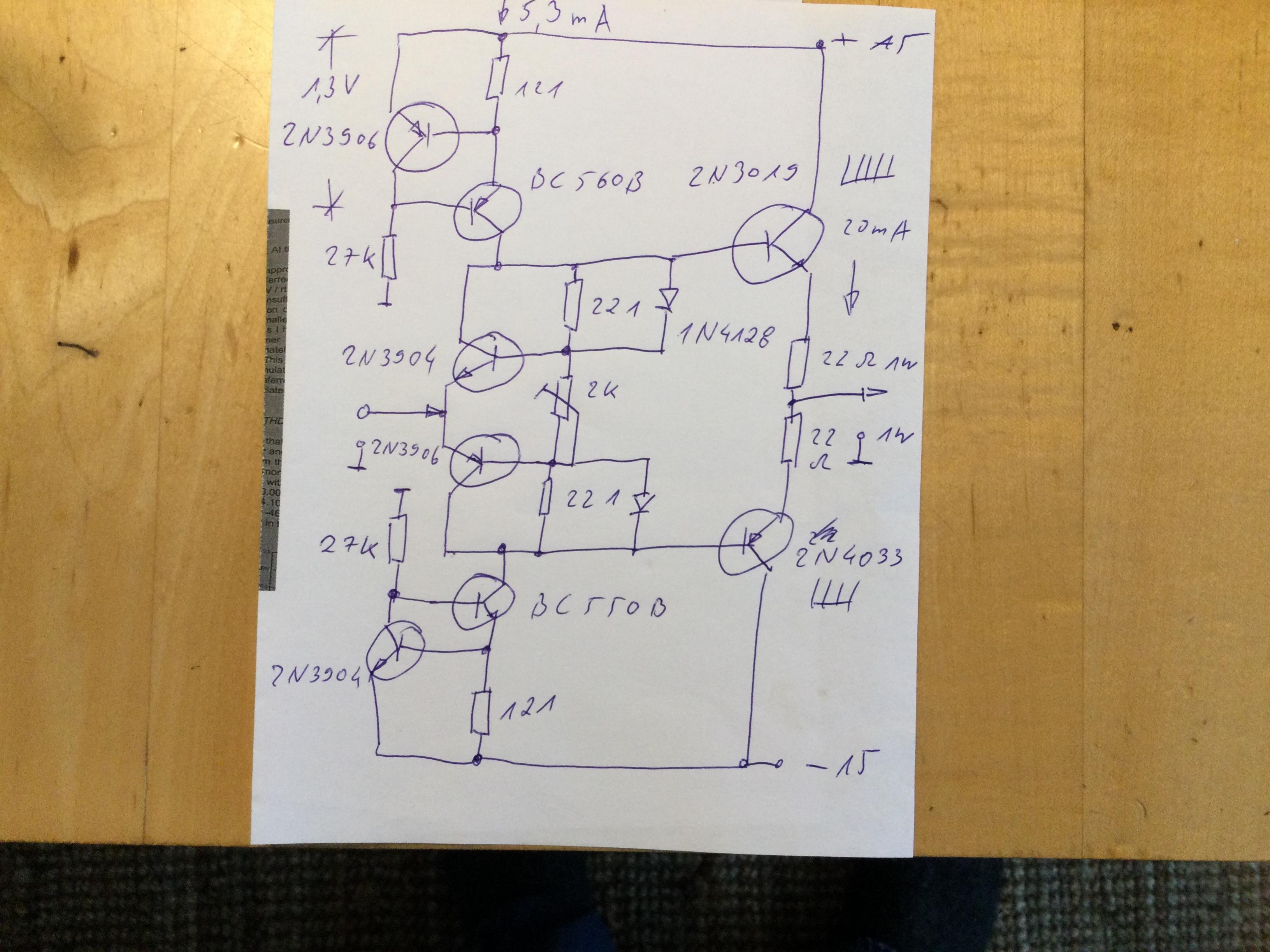

Buffer
I never promised you a rose garden but I promised to publish all buffer circuits I can find that are interesting enough just for completeness.
This one is from the new Burkhard Vogel book “ Balanced Phonostages “.
In the old days I would have called that an Allison Buffer because the signal goes into the emitters and not the bases. I would be fine if we could calculate the input impedance.

NotInput impedance is determined by the two current sources in parallel, not ?
Patrick
I fail to see beta in the in the model, but the result in post 11293
seems to reflect the simple proportionality Zin ∼ β*RL of a single
stage emitter follower, as expected.

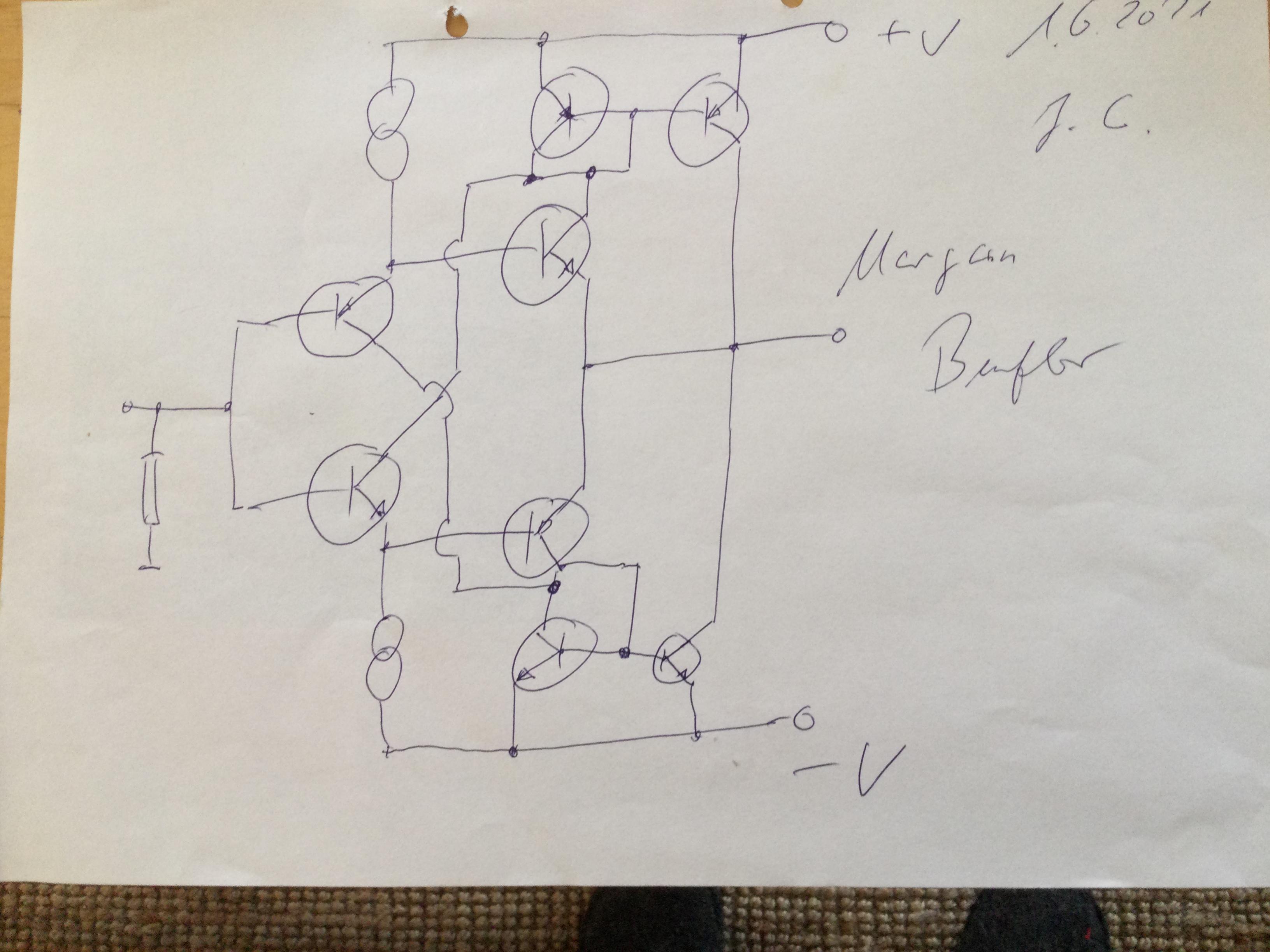

Buffer
Here is another buffer that I find kind of interesting. It is from the book Wideband Amplifiers.
Here the currents of the input transistors are mirrored into the output stage.
The author claims less idle and less distortion.
