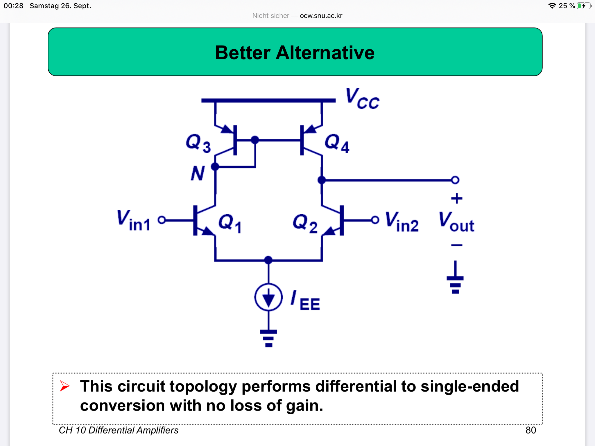

After some related telephone talk I want to add the source for the differential amp drawing of post
11210, it is Redirect Notice ,
seemingly Seoul National University, lecture chapter about diff amps, 90 pages.
In the context given I just had to find a simple diagram with picture search.
There has been some discussion here about a noise penalty in differential amps due to gain difference
("noise differential" has 39 results in this thread).
However if you use current mirror load on a long tailed pair full gain is on the single ended output.
Not sure the two current sources work with only one Vbe on the collectors.
Perhaps the sources in 11227 are referenced to the supplies and not to ground.

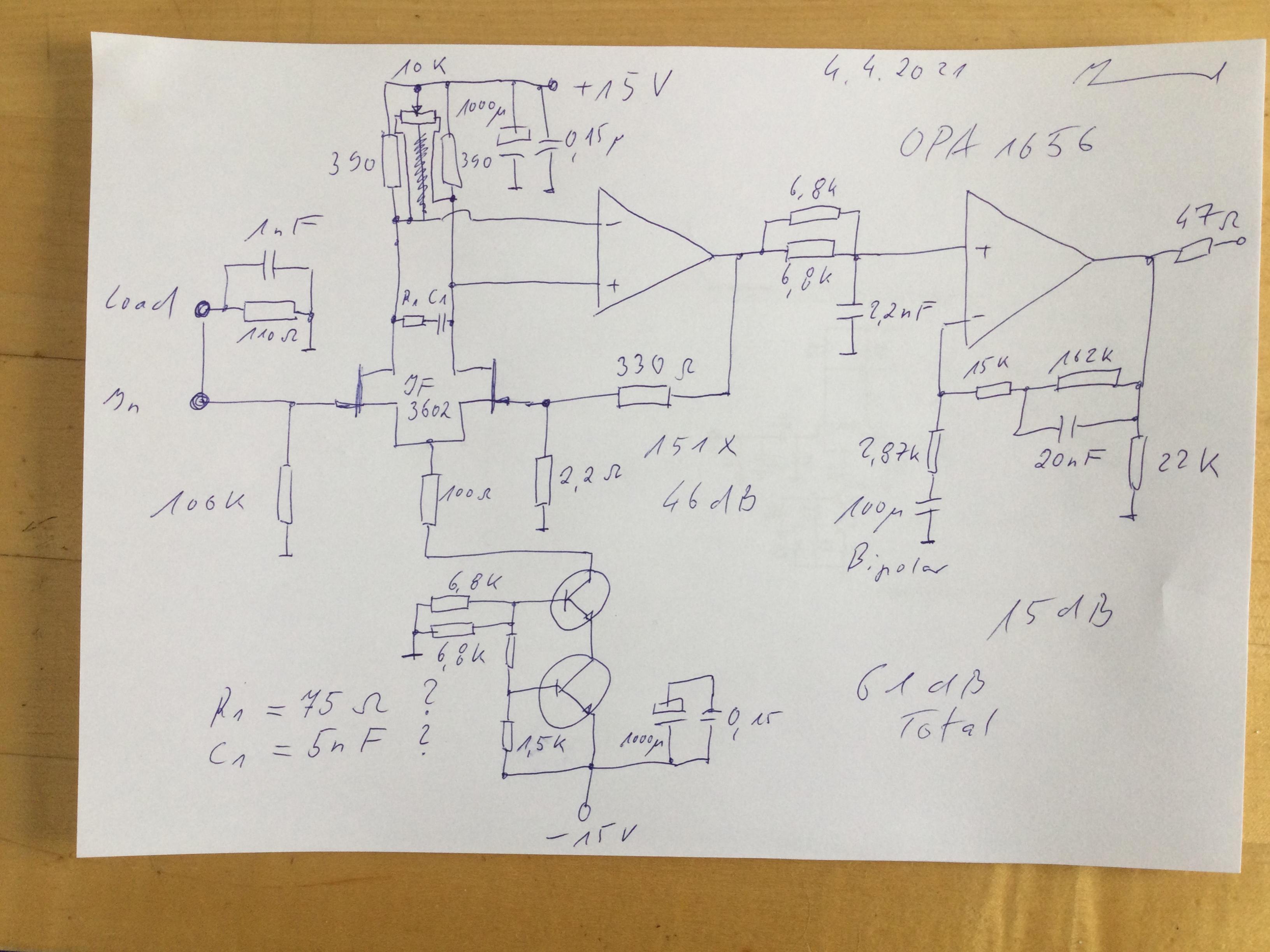

My version of the G = 1000 low noise measurement amp (for Ikoflexer).

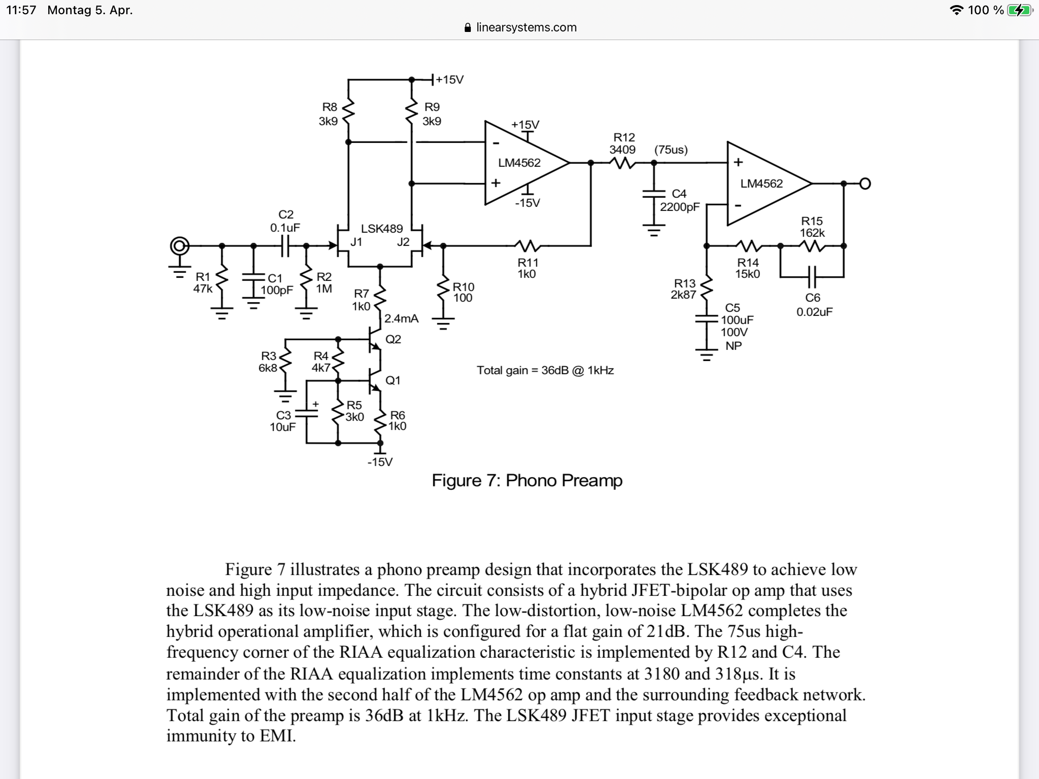

Then it occurred to me that the classic differential amplifier is a good way to go. The IF3602 comes as a matched pair in the can anyway. When I was searching for a circuit I found an application by Bob Cordell. Me getting lazy I used this circuit with some modifications to turn it into an MC phono instead of MM.
