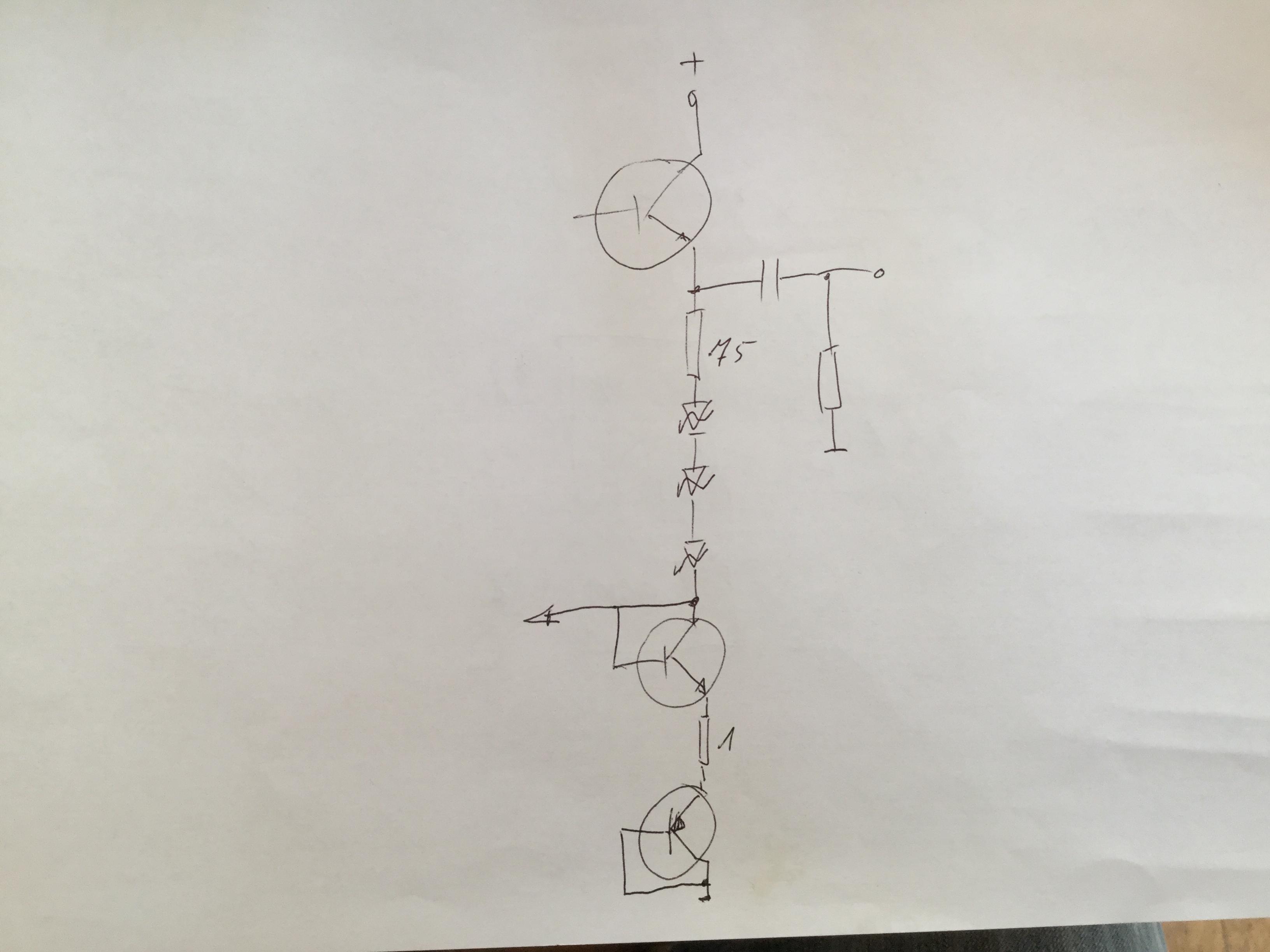

Here is an idea to lower the impedance in the feedback network. I know it looks weird and LEDs have unlinear capacitance. I wonder if a bias spreader could be used there too.

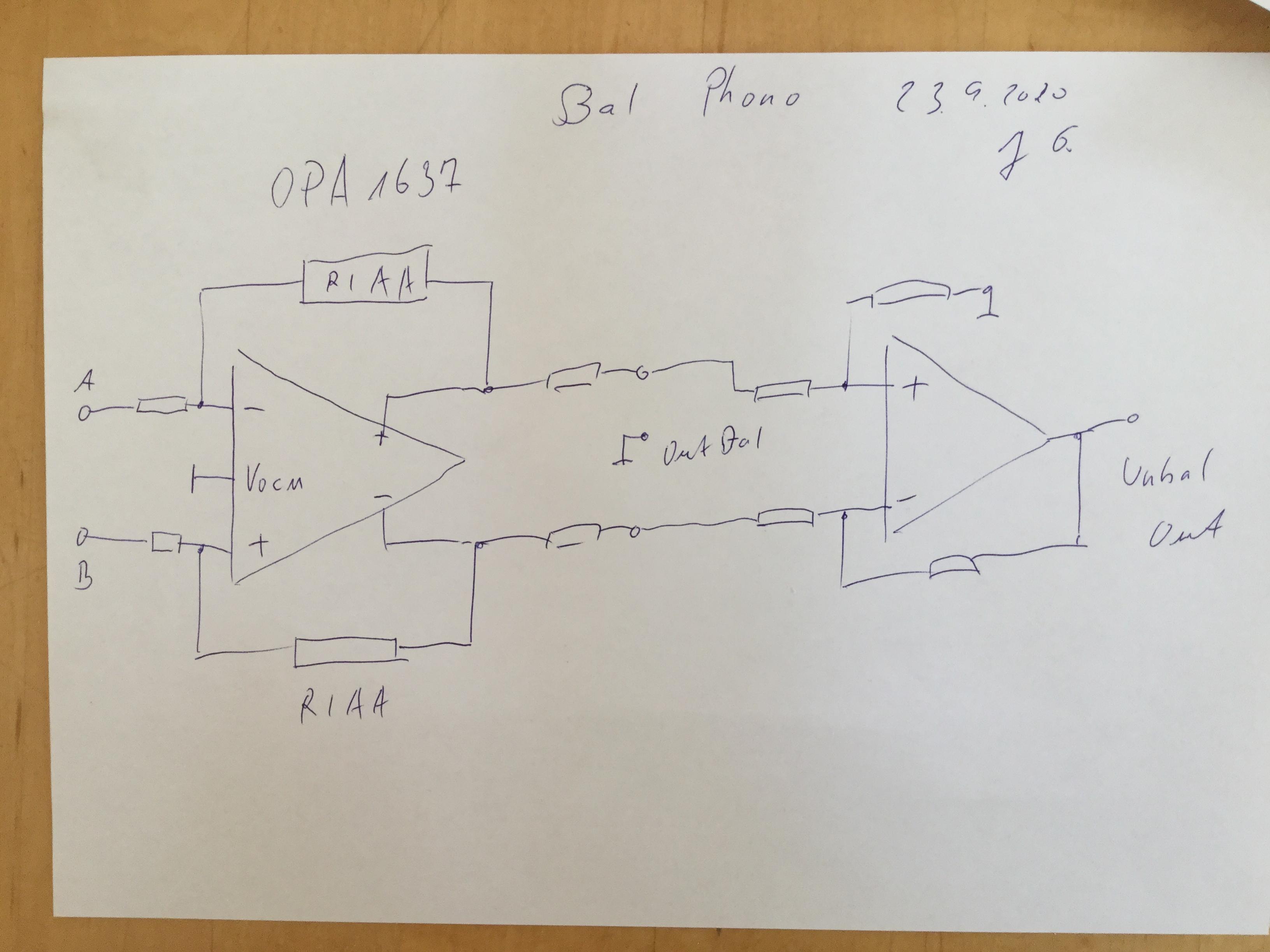

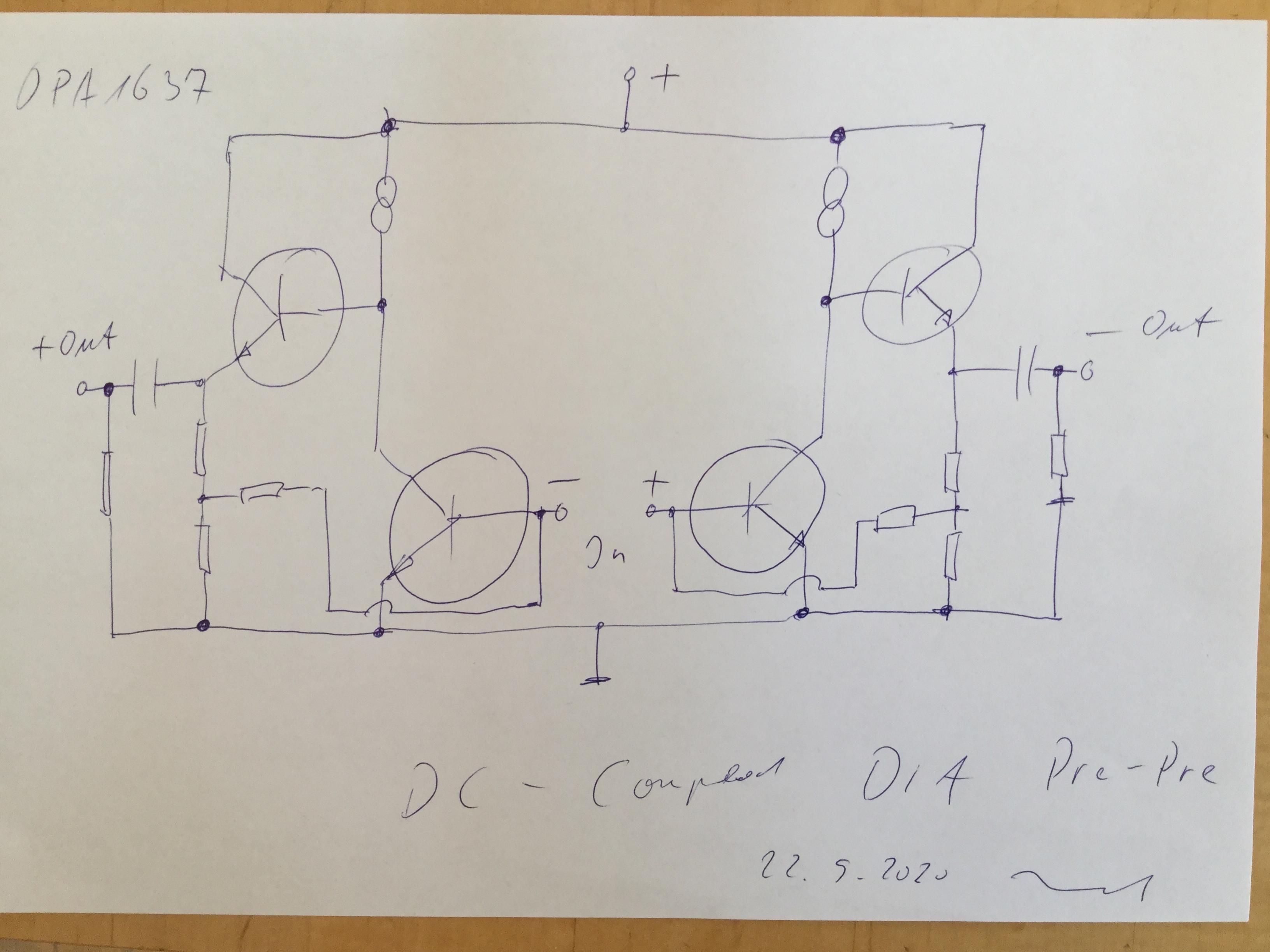

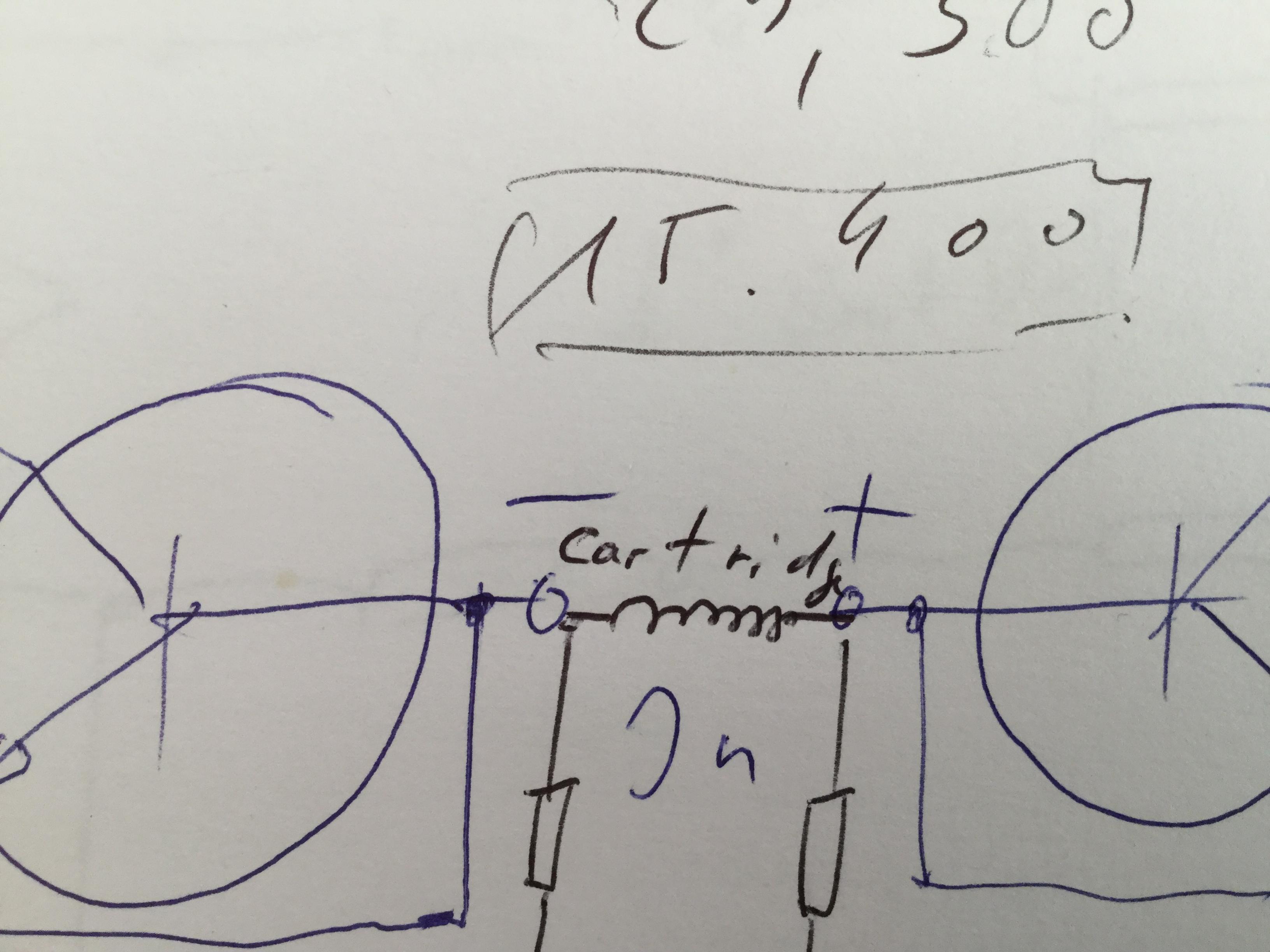

There is another way to make a direct coupled input. It is fully differential and does not have the noise disadvantage of a long tail pair. The RIAA could then follow with a differential Opamp as I did in my Phonostage article in Linear Audio.
