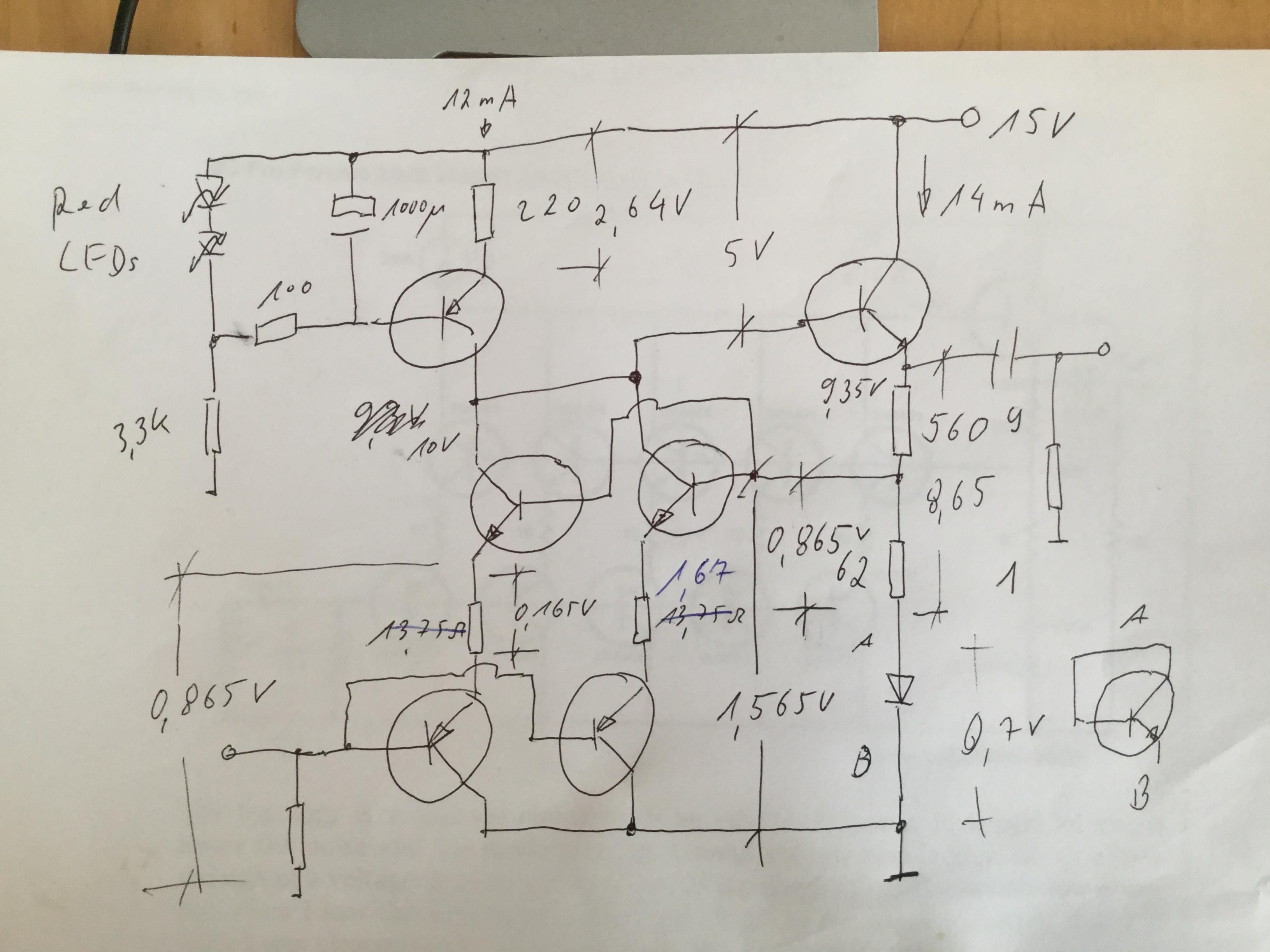

AS Audio asked in another thread if there is a phono amp available with adjustable input offset. For one there is the Paradise with a trimmer at the input.
Marvel has shown designs with input servo.

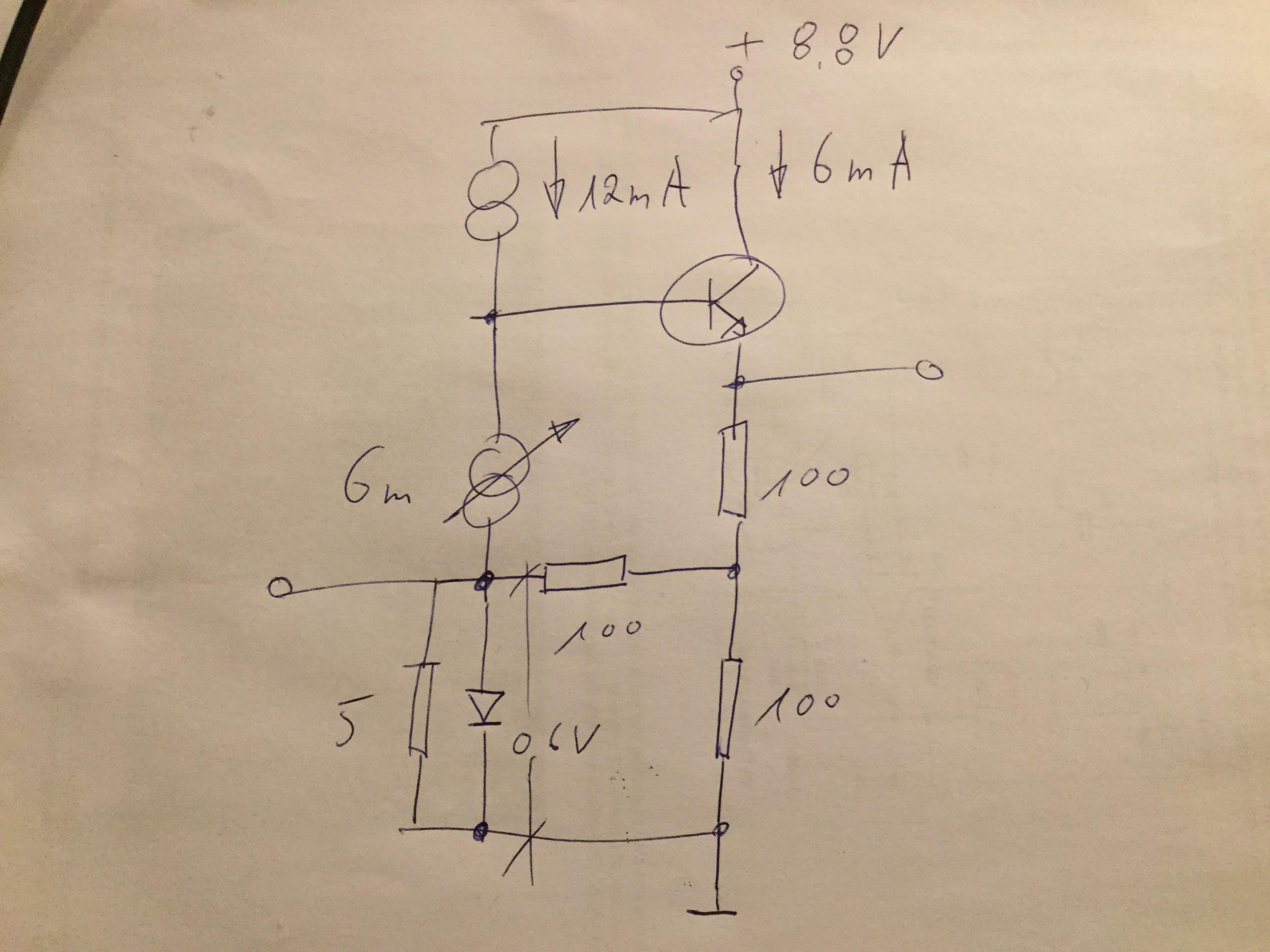

I am working on a single ended circuit that needs no input cap. Here we have PNP transistors at the input with an NPN Rush Cascode. It can be level shifted to bias the input transistors to Ube positive ( ca. 0,67V ). Than can be made adjustable. Do not take the circuit too serious. I am still working on the values. It should work though.
