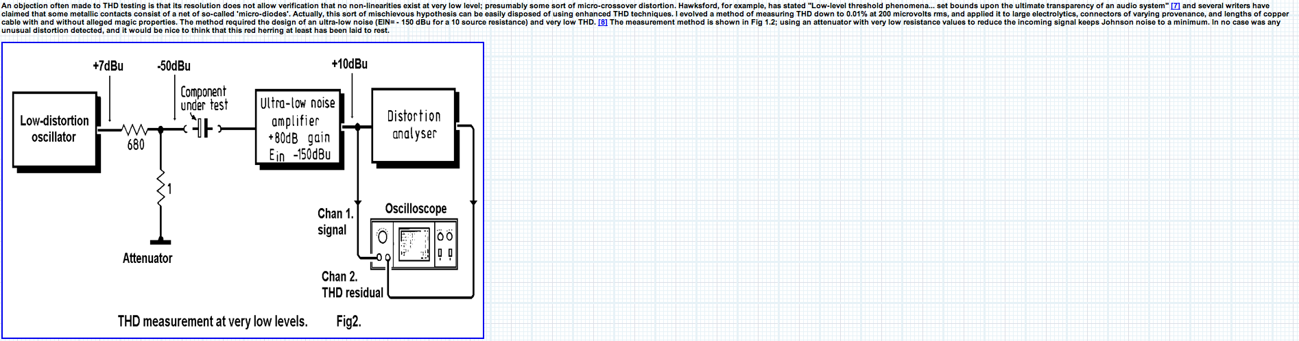

I am thinking why i get more distortion with the " New " Zetex.
Sergio sugested it could be the high input capacitance.
I do not think so because i use a 1kOhm / 6 Ohm voltage devider at the input when i measure this circuits.
With 6 Ohm source resistance capacitive loading should have minimal effect.
The voltage devider is also nesessary to reduce the noise in the measurements.
I have that trick from Douglas Self.
He even uses 1 Ohm but i wanted to mimic my Titan cartridge that has 5.5 Ohm.
Here is the basic method.

It was not me 🙂 , but I agree with Calvin.
The non linear parasitic capacitances may be the reason for the increase of the thd.
It is not only the source impedance that matters, the output impedance of your input circuit is also important. What is the value of the resistor connected to the collector of your input transistor?

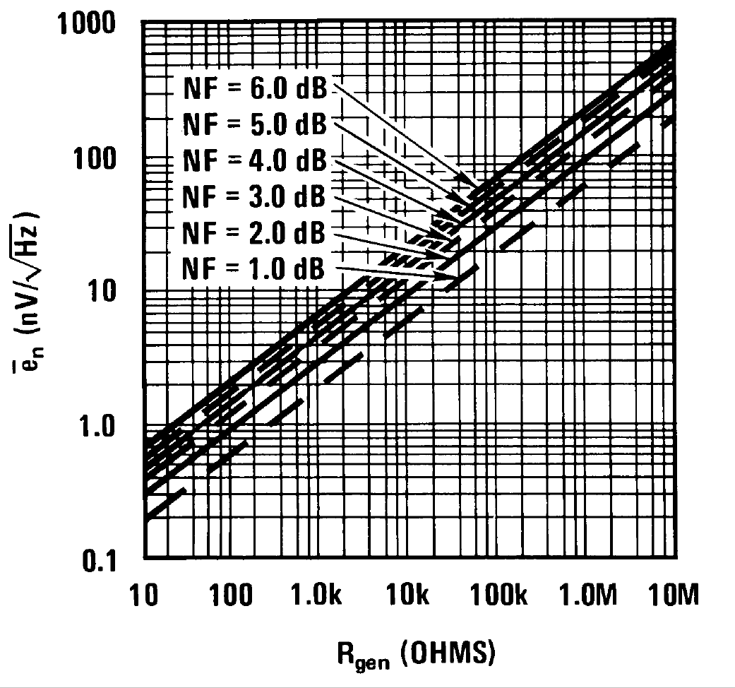

I wanted to explain my substitution method a little better.
Here is an older but still valid apllication note about noise :http://materias.fi.uba.ar/6648/archivos/AN-104.pdf
You can see that the noise of the preamplifier must be around 0.4nV / qHz ( shorted )
over a 20Hz to 20kHz bandwidth when an inplugged 10 Ohm resistor gives a worcening of 3dB.

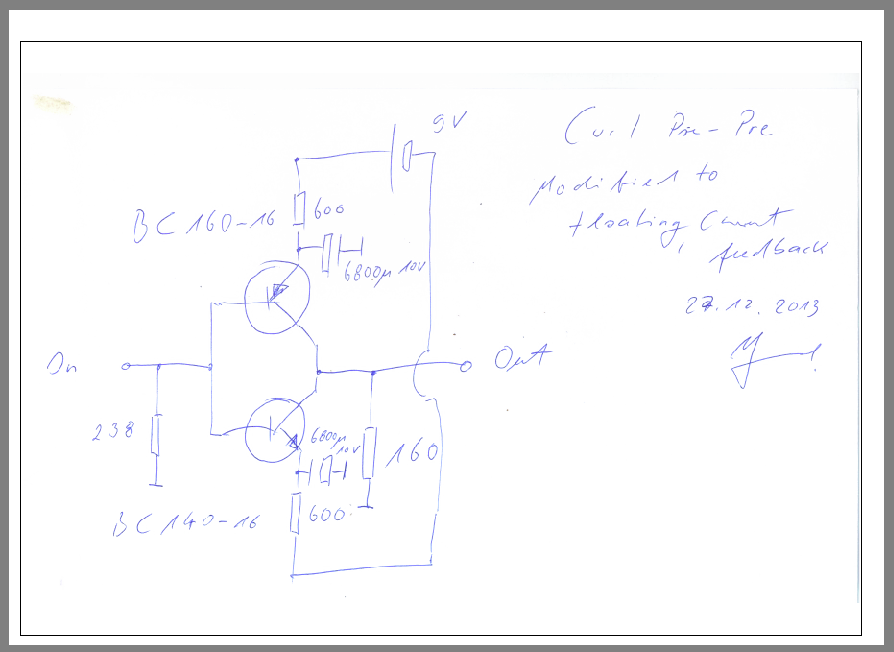

This is in priciple the circuit i use.
I added a CCS in series with the battery and made a balanced input.
Sorry, i can not disclose all the details this time.
There was design input from several people and a lot of know how exchange but in principle the circuit shown does the job.
Maybe some of you have a better idea.

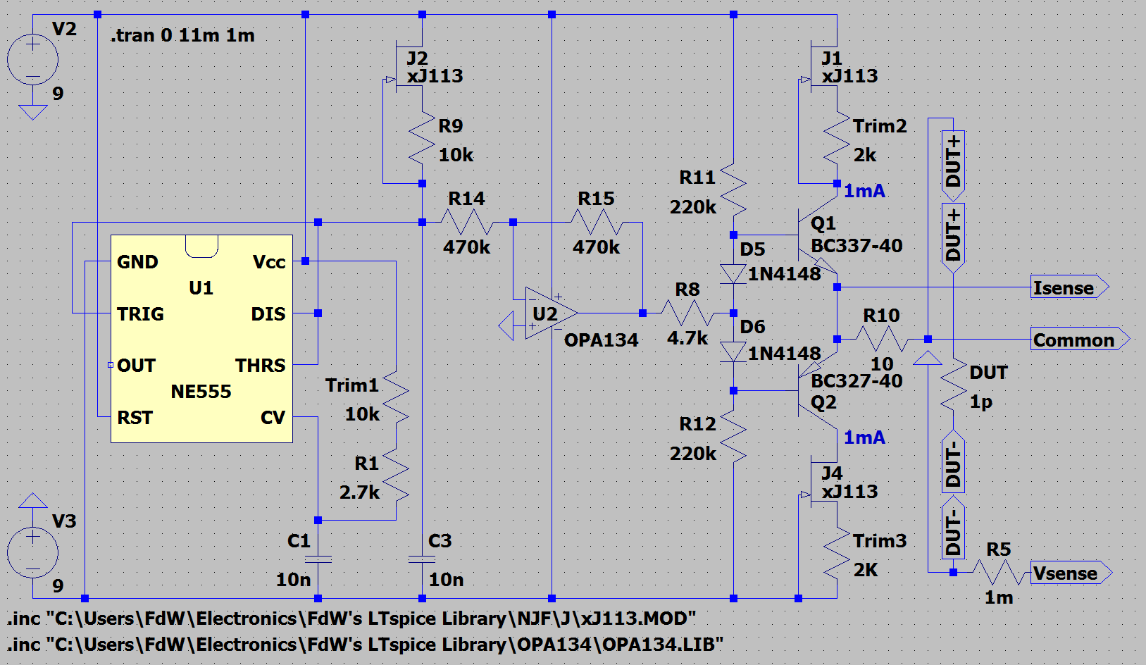

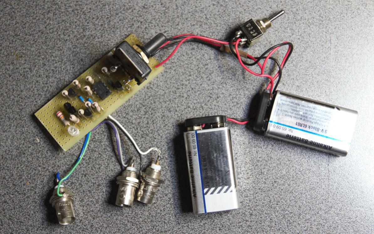

Today the ATL electronics specialist paid me a visit, and they had a present. The unit that they gave away is called an 'IGC' (or in our usual lingo an 'In-Circuit General-Purpose Curve-Tracer). The unit is battery powered, and exposes 3 B&C connectors.
1: Black/White = D.U.T.
2: Purple/Gray = Scope(X)
3: Green/Blue = Scope(Y)
The tester can be used to compare two circuits (one working and one that lost some of it's smoke), differences between the two circuits are visible through different traces that are displayed. This I.G.C. tester can very quickly pinpoint components or circuit parts where faults may be located.
The maximum voltages and currents that are injected in the DUT are
1mA +/-
5V +/1
This is safe for most (if not all) circuits.
I have started a new thread for this tester.
http://www.diyaudio.com/forums/equi...general-purpose-curve-tracer.html#post4070420
Also: I simplified the schema slightly 🙂
