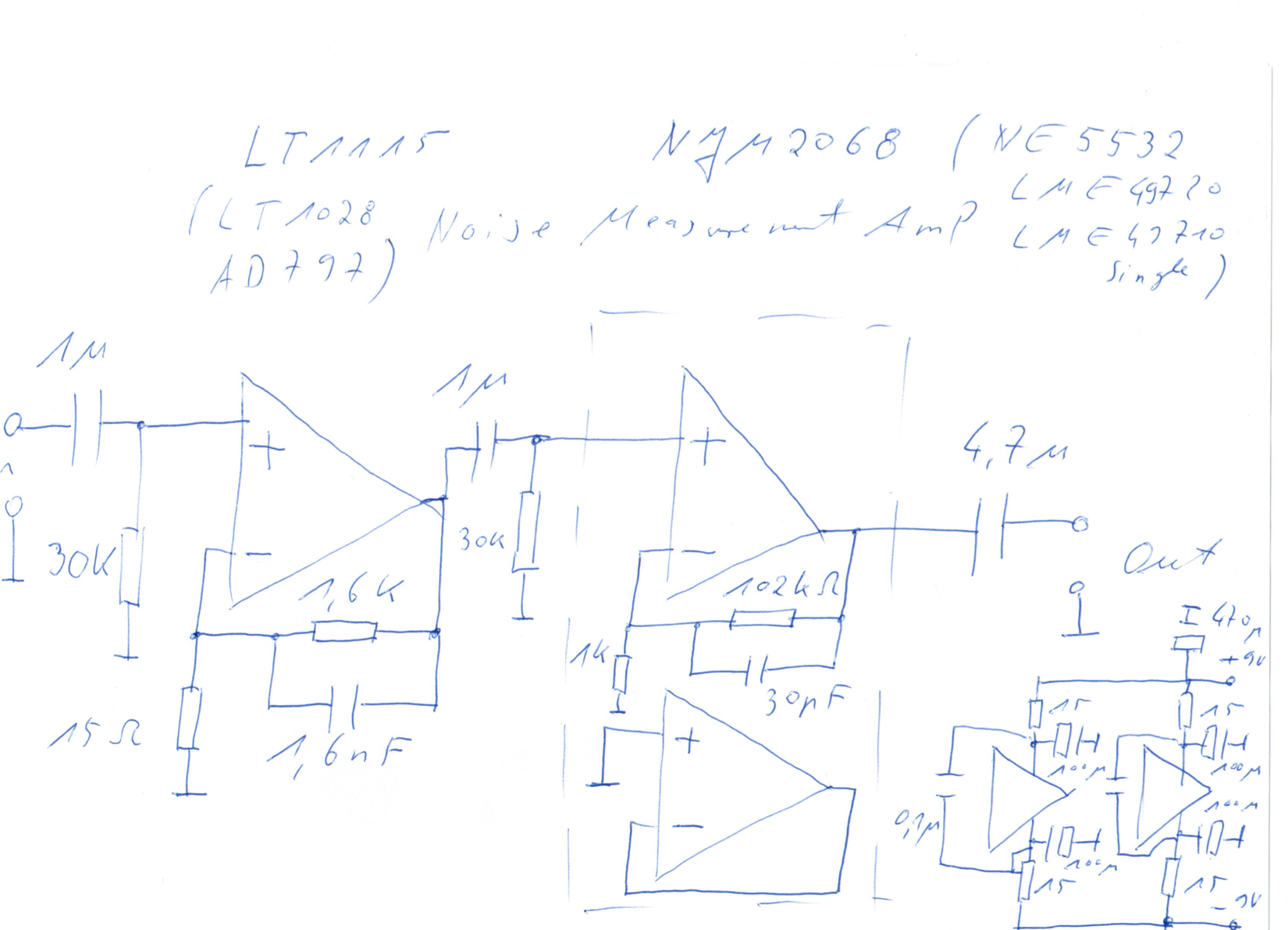

Here is the circuit diagram of the noise measurement amp.
The first opamp is a low voltage noise part.
The second stage is less critical.
The first stage has minimal effect on the noise measurement because the Duts are in a 26dB amplifier.
When you want to build in DIL i have given alternatives.
In SMD there are more alternatives like LME 49990, OPA1611 for the first stage and even more alternatives for the second stage.
The design is completely AC coupled to avoid problems with offset and servo.
Good MKTs are fine. This is not about the sound.

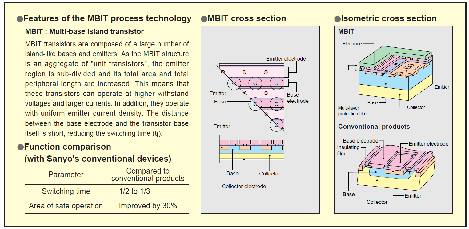

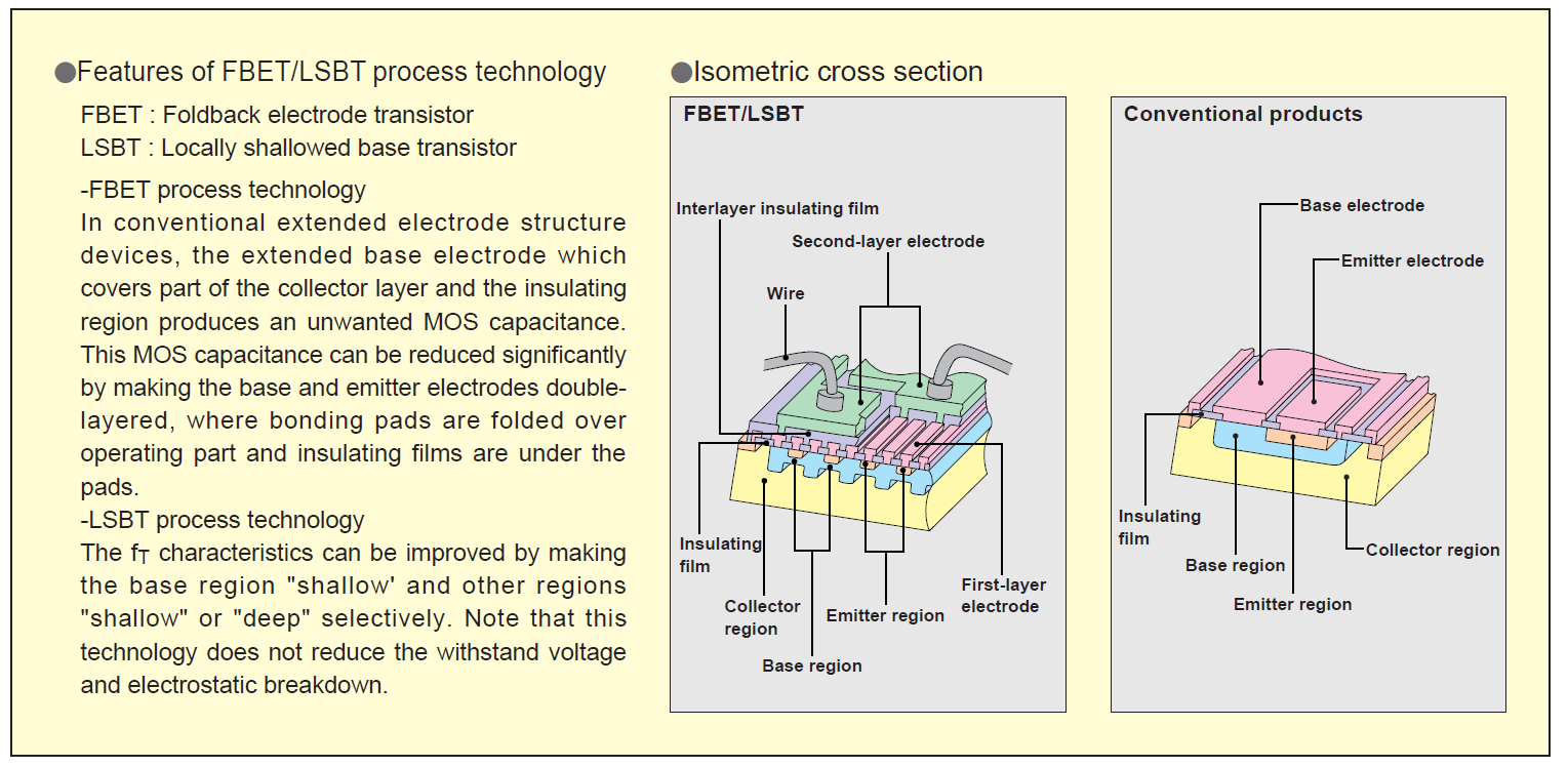

Joachim, one technologie that also have low rbb are the FBET , MBIT process from Sanyo now onsemi. They are very linear.
Syn08 have measure 0.21nV/rtHz at 10mA in 2sc3601.

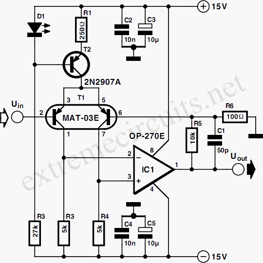

So, this will make an ultra-low-noise op-amp?
