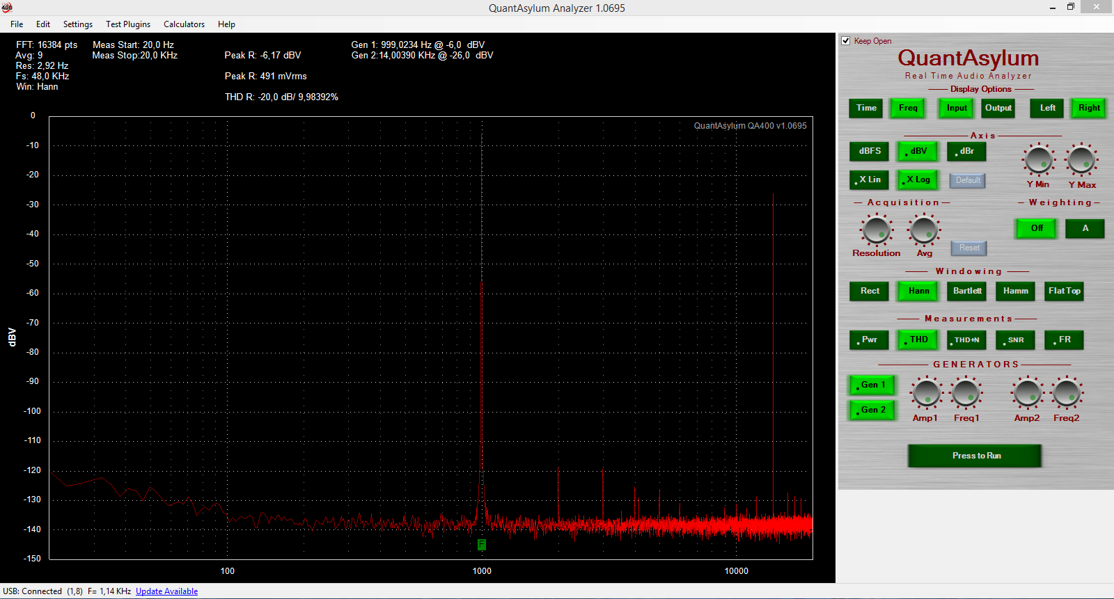

Calvin, i think you made a wrong calculation with the emitter resistors.
I changed now the 25 Ohm at the input to 120 Ohm and the 25 ohm at the output into 4 Ohm. I get now 35mA idle.
As far as i understand the voltage over those emitter resistors is the same.
The input idle remained because of the CCS but the voltage that develops over the 120 Ohm resistor is higher then before, around 0.145V.
0.145V over 4 Ohm is 36mA.
When i change back to 25 Ohm at the output we have 0.145 / 25 = 5.8mA that is more plausible.
I also do not think that the combination of 120 Ohm and 3.3 Ohjm ( in my sample 4 Ohm ) is the sweetspot of that circuit.
You will see in the measurements i made that the original starved version has lower THD.
The version with 35mA has a little bit lower K3 which is good but K2 went up by 10dB.
For the sound that may be even good but i will try to reduce the idle in the output to 6mA and see what happens,

I made some more experiments with the idle.
Unless the output is really cranked up there is not much change in the distortion spectrum.
At least at the level ( ca. 0.5 V ) and load ( 10kOhm ) i am measuring.
For the time being i settled on 120 Ohm and 12 Ohm.
I also build in the MosFets but sofar i can not make it work.
Because i am lazy i did not build Frans version with the higher resistor values but kept the values from the BJT version, like Calvin did in his last post.
Anyone an idea what could have going wrong ?

I have the Mosfet version working.
I think what went wrong is that the N-channel belongs in the positive feed ( top ) and the
P -channel belongs in the negative feed ( down ).
Unfortunately i get a lot of distortion so something is not right.
