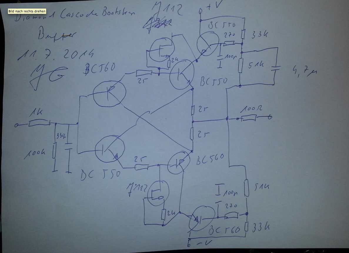

So why a new buffer ?
The Calvin and the Keantoken are fine but that are not my designs.
Also to build my standart buffer, a modified JLH, got much harder because the 2SJ74 is now nearly imposible to get and the Linear System substitude is not as good as i hoped for.
Anyway, one good and cheep way is the BJT diamond buffer.
I build a lot of varieties, the Piglets Dad, the Mr. Evil, the Mike B and others.
Audible problem in diamond buffers for me is that they produce more uneven distortion
( like 3rd and 5th ) then even distortion ( like 2nd and 4th ) so they tend to sound very dymamic and crispy but sometimes also a bit harsh.
So i set down to make a diamond that has mainly 2nd harmonic.
The design i came up with is not totally new.
For example Dadod has shown circuits like this.
Unfortunately i see mostly simulations only and no real measurements.

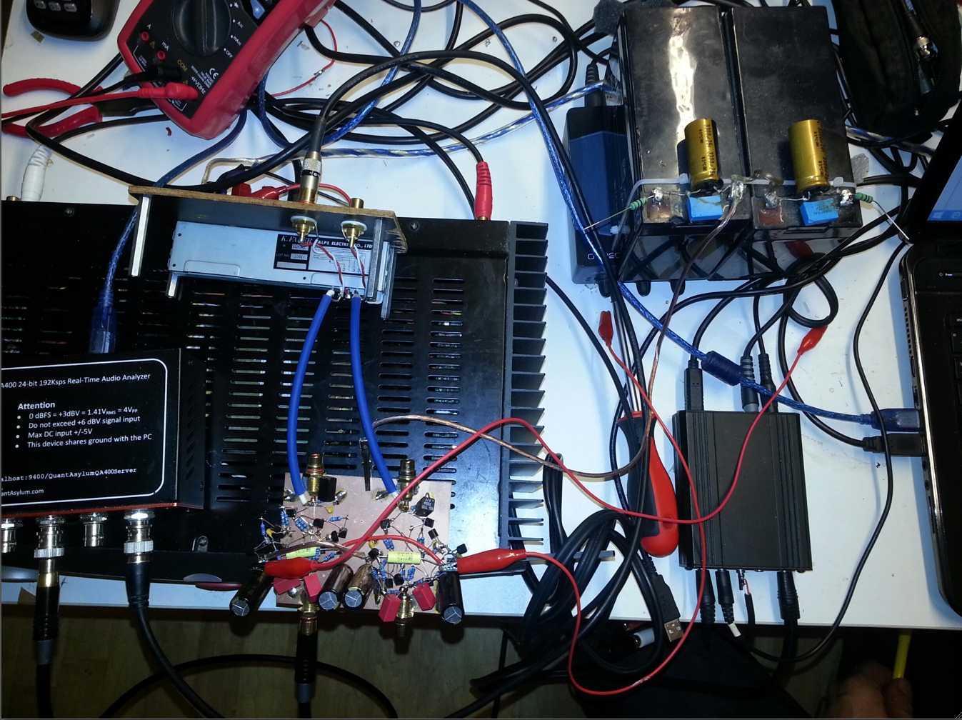

I think i have a circuit now that works.
Mind you, this does not come out of the simulator.
I just build it with my intuitive feeling about circuits and some experience.
It may well be that some of you are able to improve it or find a better dimensioning of the part values. Commends are wellcome.

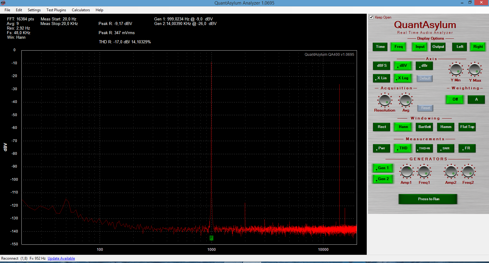

Here is the two tone FFT at the sweetspot of the Quant Asylum QA400.
Both channels are remarkably similar so i likely " measure the measurement instrument ".
Actually your circuit is the basis for this buffer.
It is not a new circuit anyway. I saw it first in a Hawsksford designed phono stage at the end of the 80th. There are other variaties.
I build your version first.
It is very good for such a simple circuit.
The circuit in post 9883 has some advantages though.
When you read post 9881 my version also has prerunners like the one Dadod made.
I knew the idea before i saw Dadods circuit from a book by Douglas Self where he bootstraped an IC Opamp ( i think it was a simple TL071 ) for stunning results.
So where is the difference to your version ?
First i replaced your 15kOhm bias resistors with JFet constant current sources.
That improves PSRR and lowers distortion.
Then there are the outer bootstrap transistors.
Instead to reference the cascode bias to ground it is refferenced to the output.
You can see that as a driven cascode.
Another point of view is that they make a copy of the output signal and modulate the supply to the buffer with that signal.
Theoretical such a power supply bootstrap can reduce the distortion to Zero because the Ube diodes in the diamond are more or less distortion free.

I just have drawn up a version that is driven by the input.
Schematic later.
It could be even driven by the difference of the input and output.
Maybe this idea is crazy. It certainly gets more complex from this point on.
