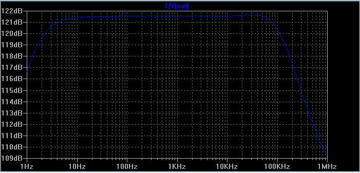

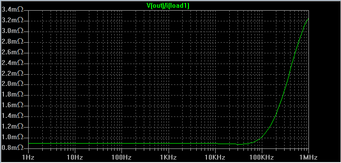

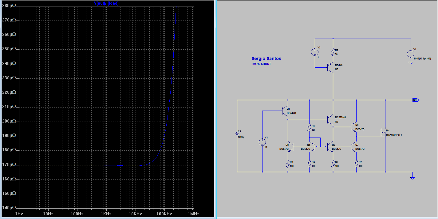

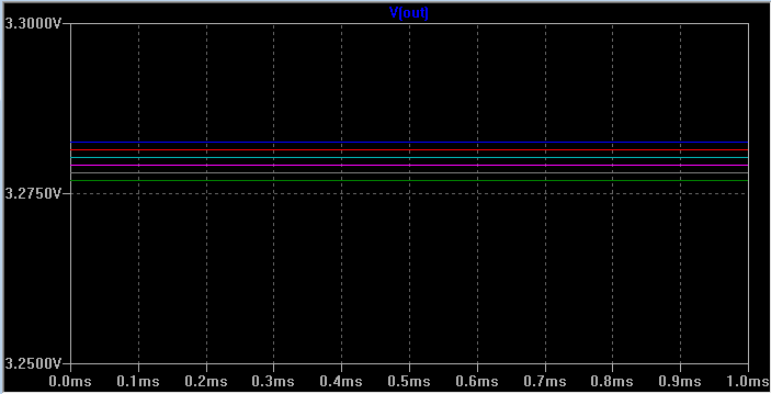

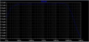

This is the shunt that I am working on.
V3 is a voltage reference like a tl431 and the voltage at the output is equal to the reference voltage.
Maybe i will open a new thread about this one.
The second image is the output impedance, third is the power supply rejection ratio, the last one is the output voltage with different temperatures from 0º to 50º in 10º steps.
Looks good to me. One thing I might change, why not have a little bit of gain, then you could use a 2V (or comparable) reference and 'tune' the gain factor for 3.3 and 5 (or any other) output voltage.
Also if you use a reference lower than 3.3V then you can feed the reference from the output voltage and that may be a better option than using the 'dirty' supply.
As you may (or not) know, I do like all the BC327/337's 🙂. Makes me wonder, could one use a BC-combo as a band gap reference 🙂

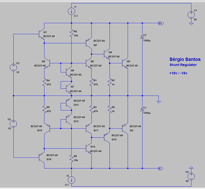

A example of a positive and negative power supply , in this case +15V and -15V output.
edit: In this case the output impedance is even lower that the 3.3v exemple 300 micro ohms for the negative and 600u for the positive.
I have think of that ,and made some sim´s, but adding gain adds unnecessary complexity, I personally use the tl431 as reference voltage , the resistor r3 and c2 filters the noise from the voltage ref.
Using a current source to feed the tl431 enhance the psrr of the voltage ref. so I do not think it will be a great gain to feed the reference from the output voltage.
I also like the BC327/337's
The things that I want to change is the main current source, and a speed up circuit for the voltage ref. filter.
