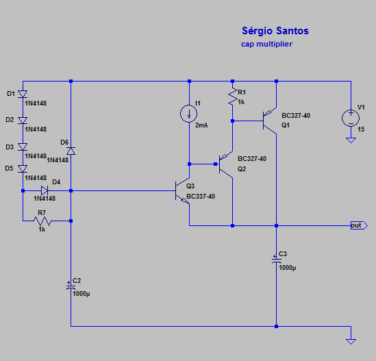

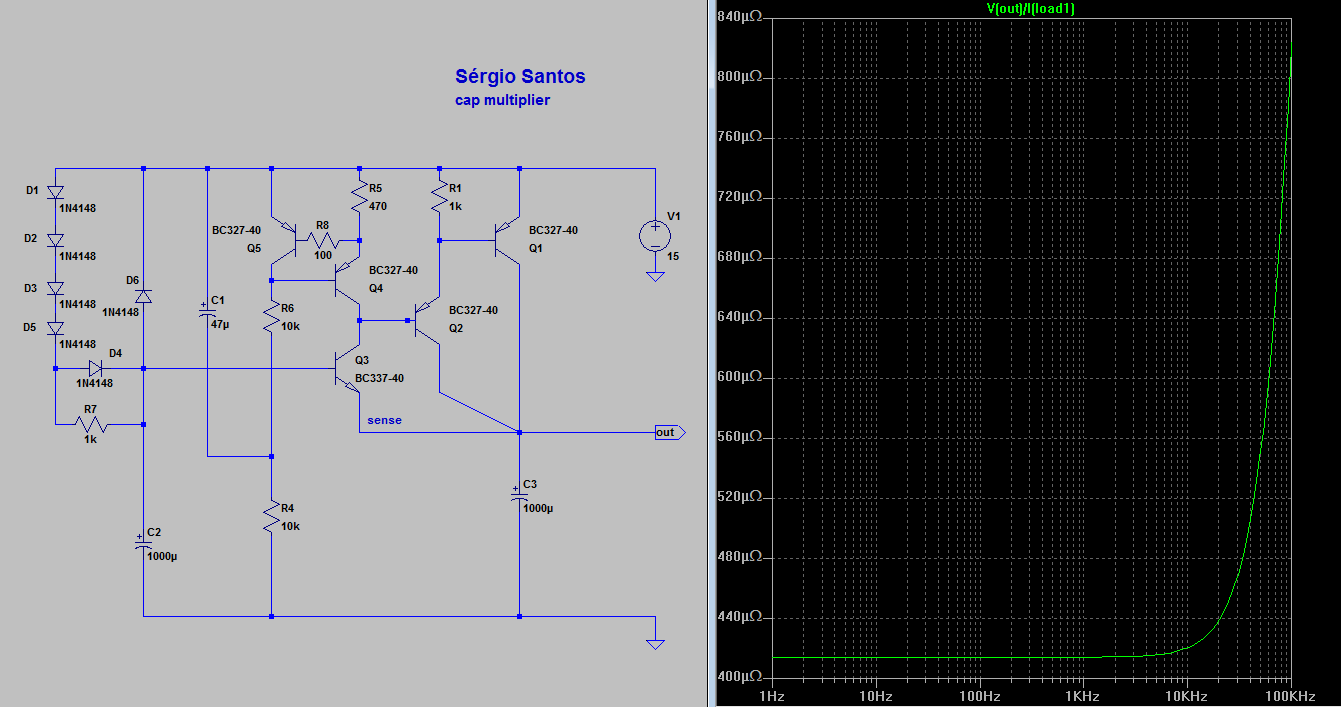

Today I was testing my shunt regulator that has a Pré-regulator, and I realize (remember) that when one use a pré-regulator there is no need for a great PSRR as the total PSRR is the sum of the pré-reg PSRR and the main-reg PSRR.
And, I want to design a new regulator for my headphones amplifier, that works in class A and consumes 50mA per channel.
So, I went to ltspice, and try to improve the output impedance of the Keantoken multiplier.
This is what I have right now. It uses the FdW current source. the bc337 will be good for at least 100mA, as the voltage at collector-emitter of Q1 is only 2 volts.
Q1 ,Q2 and R1 can be substituted by a Darlington. Diode D4 serves to fast charge the capacitor C2. I tried not to use exotic/hard to find componentes.
Improvement proposals are wellcome.
The first picture is the simplified circuit, and the second the full circuit without the pré-regulator, that is based on a lm317/337. The load current is 50mA

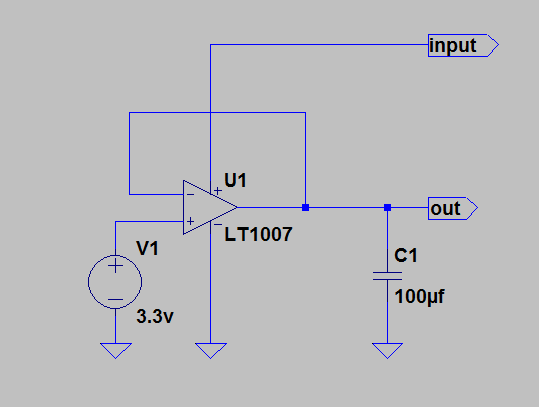

You can put a large capacitor in the output of a opamp , larger than 100uf. If the capacitor is too small or low esr the opamp can oscillate..
The ess reference DAC board has regulators based on this, I have tested with opa2134 and works good.
normally opamps have better PSRR than reg chips , new designs have better than 120db.

Lower R1 (50...100 ohm) and add a base-stopper to Q1 🙂 I think 🙂
800uOhm at 100Khz looks very good.

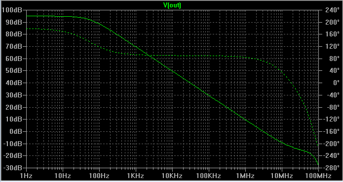

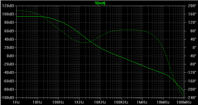

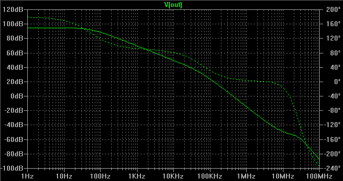

Interesting. Did you not experience oscillations with only 1uF ? It seems a low value to me, the higher the capacitance the better, also a low ESR capacitor can make the open loop phase margin decrease enought to cause the opamp to start oscillating.
pictures from a opamp open loop gain and phase margin.
1 - without capacitor at the output.
2 - with 1000uf / 0.02 ESR (the phase degrades at 2 Khz where the output impedance is lower, more stable this way)
3 - with 1uf / 0.02 (phase margin is only 6º and the phase degrades at much higher frequency)
Thanks Frans, it seems that lowering R1 value will lower the loop gain. But I will try .
One thing that I have doubts is in the protection diodes, for take care of turn on and turn off , hoping that you and the rest of the guys could help on this matter.
