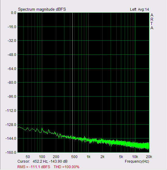

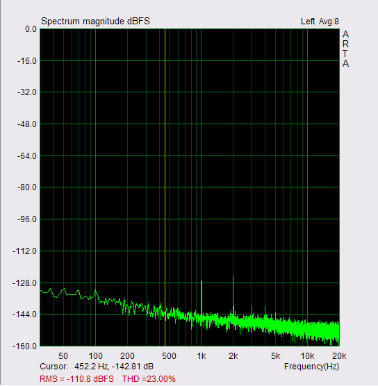

In my current DAC, I use for the analog power suply a simple lm317 with 20000uf at the power pins of the PCM1794, and it dos the job just fine , this picture is from the noise at the power pins of the DAC chip. first without signal and second with 1Khz at 0db in both channels.

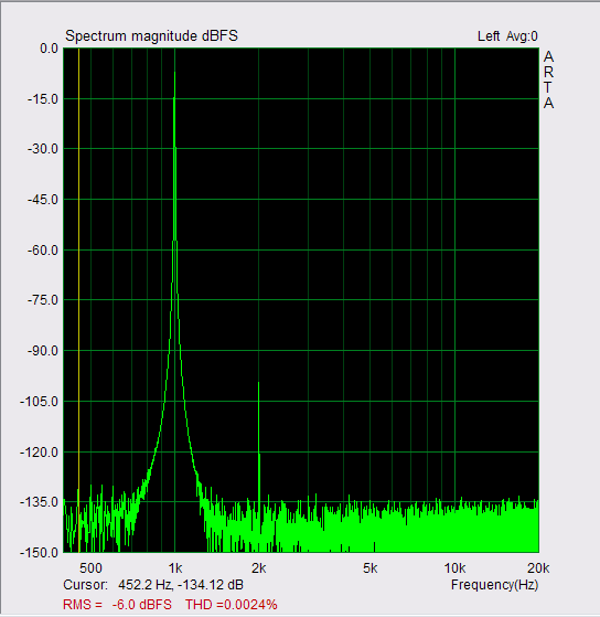

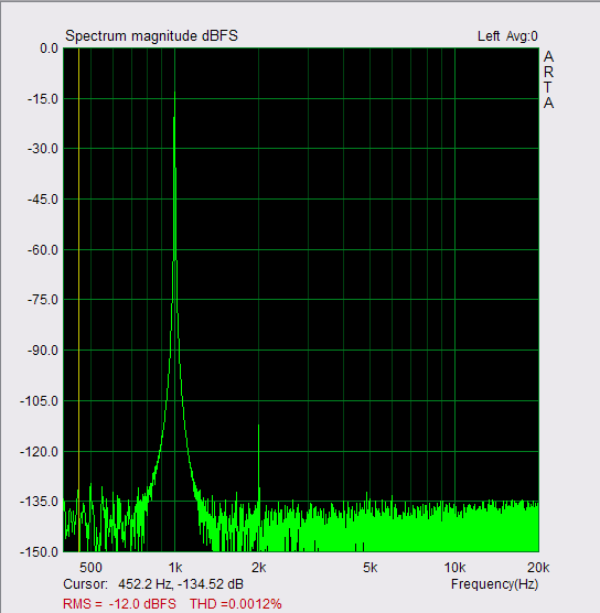

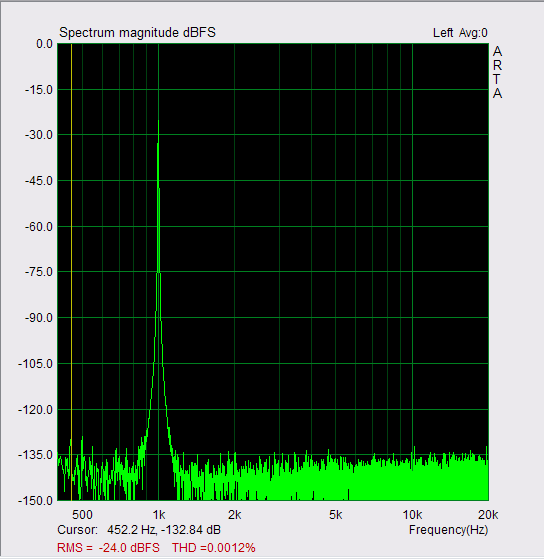

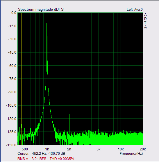

I have try various types of I/V converters in my DAC , some with very low distortion figures, but the one that I like the most have a bit of second harmonic, I have almost shure the diference in sound is due to the second harmonic.
The sound from this DAC sounds much more natural and 3D that the versions with lower distortion. And I realy like it a lot , have already listening to it for several hours, and for me it is just perfect.
I have only listening with my beyerdynamic DT880 . when I am testing some new equipment I only use headphones , as I do a lot of stupid mistakes , in this month alone I manage to damage one ES9018 chip and another PCM1794
In your experience, do you also think that a bit of second harmonic gives a better sound?
The first picture is from the output with -3db, second -6db, third -12db, and last -24db .

But in this case altering just the value of a single component , I can alter the harmonic fingerprint of the circuit. And with less distortion it sounds good , but it is a bit boring , but with a bit of second harmonic the sound is more exciting , more alive.This effect is very noticeable in the guitar introduction of the track "once upon a time in west" from Dire Straits
I try to mimic this effect in my emu1212 sound card (very low distortion ,but poor SQ), adding a circuit with a 2sk170 to add some second harmonic distortion to the emu1212, but sadly the sound quality remain the same.
Yes, i think a bit second can be a good thing.
