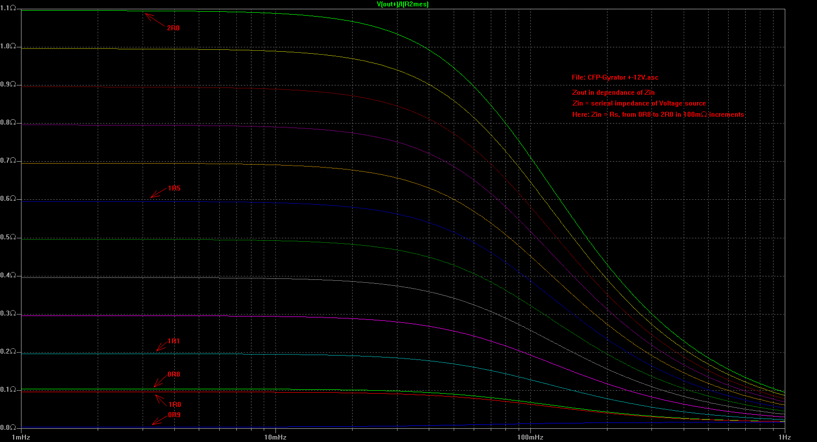

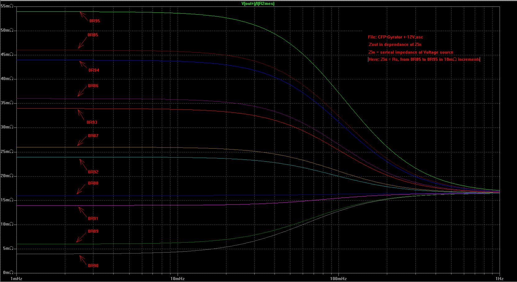

simmed extensively with different schematics and it seems that Kean´s speed-Up Diode is the best compromise on performance vers. parts number count. So I did sims for symmetrical supplies.
So far, we could see a rise in Zout below a very low Frequency towards DC.
I noticed a behaviour regarding DC- and VLF- output impedance which I haven´t understood yet.
Basically the output impedance of the Gyrator depends also on the Rser {Z(output)} of the supplying voltage source, with rising Zout for rising Rser > 1R.
But varying Rser from 0R to any positive value, the minimum Zout of the Gyrator will not be not be lowest at Rser=0Ohms (which is the default in the sims), but at a resistance of about 0R89-0R90Ohms. Here the Zout actually drops below the mean value of Zout in a middle frequency range.
See attached files.
The most linear Zout results between 0R92 and 0R93Ohm.
Kean already mentioned the 1R impedance in an earlier post.
Was this value found by lucky accident, or is there an Theory backing up?

The HF-noise may indedd give probs for integrated regs like LM317 et al. They´re simply too slow. But this is where a Gyrator excels.
Imho, the choice for an SMPS makes the useage of an gyrator mandatory.
But then I see no issue -and had none in praxis so far- using SMPSs.
