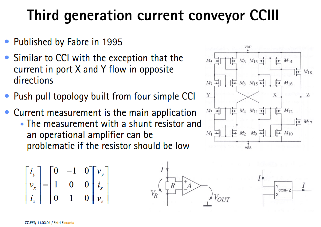

O.k. I do not know where I did get this stuff, it may even have come from here, but I thought that I should post it. Talking about 'current conveyors' did inspired me to research it and this was what I found. This circuit can take a floating source and convert it to a ground referenced voltage (yes I know there are more ways to do this, but I like it). And it is called a 'current conveyor' (rather fitting 🙂).

Frans, that one you posted looks from Sansens book " Analog Essentials ".
He is a MosFet specialist but it can be converted to BJT.
It is not exactly the same then i posted. My circuit needs only 8 transistors and is AC couple. I do not know if the circuit you posted is superiour and i am not sure about the noise performance.
I like the way the matrix is written. When i studied electronics in the 70th we calculated a lot matrixes.

Found that as well and way to do current conveyor with op amps still light years away for me to turn it in to BJT.

This is where I got it http://cas.ee.ic.ac.uk/people/dario/files/E416/cc_handout07.pdf
