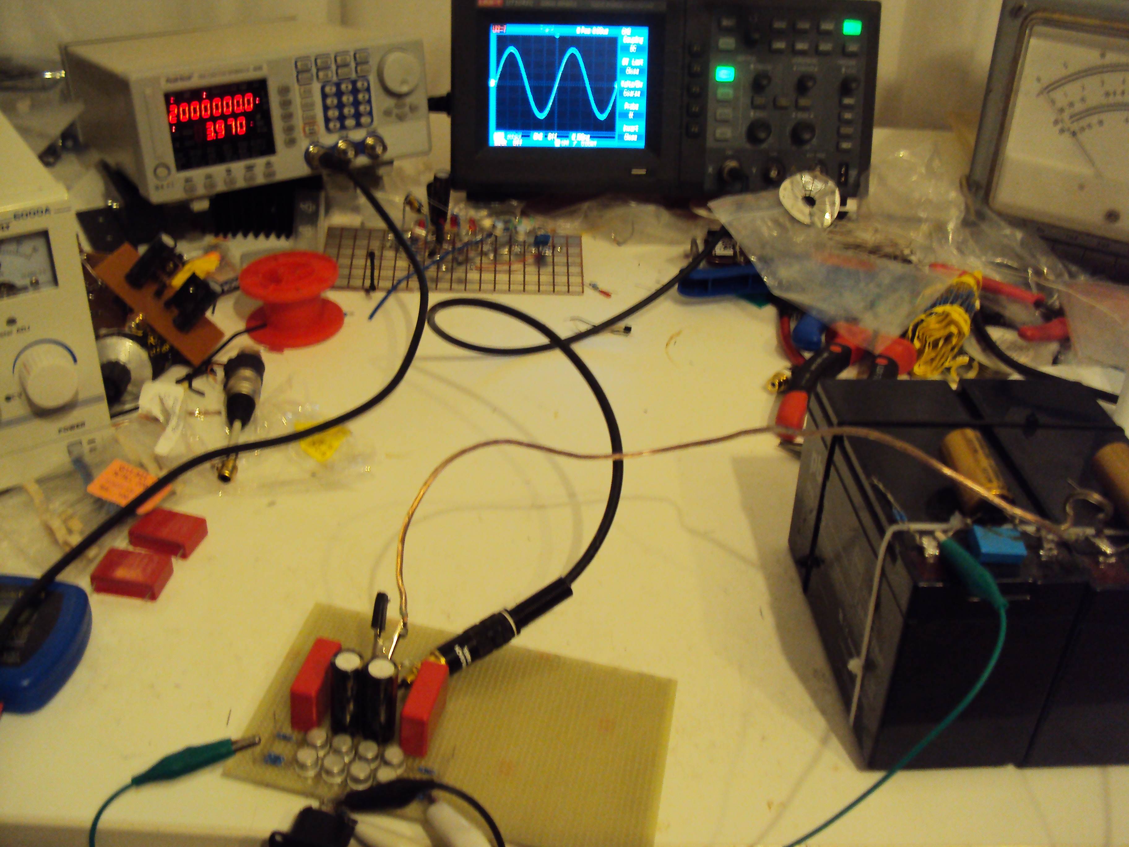

One channel is working !
Gain is quite high now. I use a " cartridge dummy " of 5 Ohm so gain is about
220 x 2 / 5 = 88.
Under that conditions the frequency response goes to a little under 2 Mhz - 3dB.
See the picture. Gain-Bandwidth according to this is around 100MHz, more or less the transit frequency of the used transistors. This circuit does not have Miller multiplication.
It is fast. How i measure a balanced transimpedance input with a single ended generator of 50 Ohm output impedance is my secret. Non of the German magazines and their associated labs can do it so when a transimpedance RIAA is tested you do not see any measurements. Ask the guru.

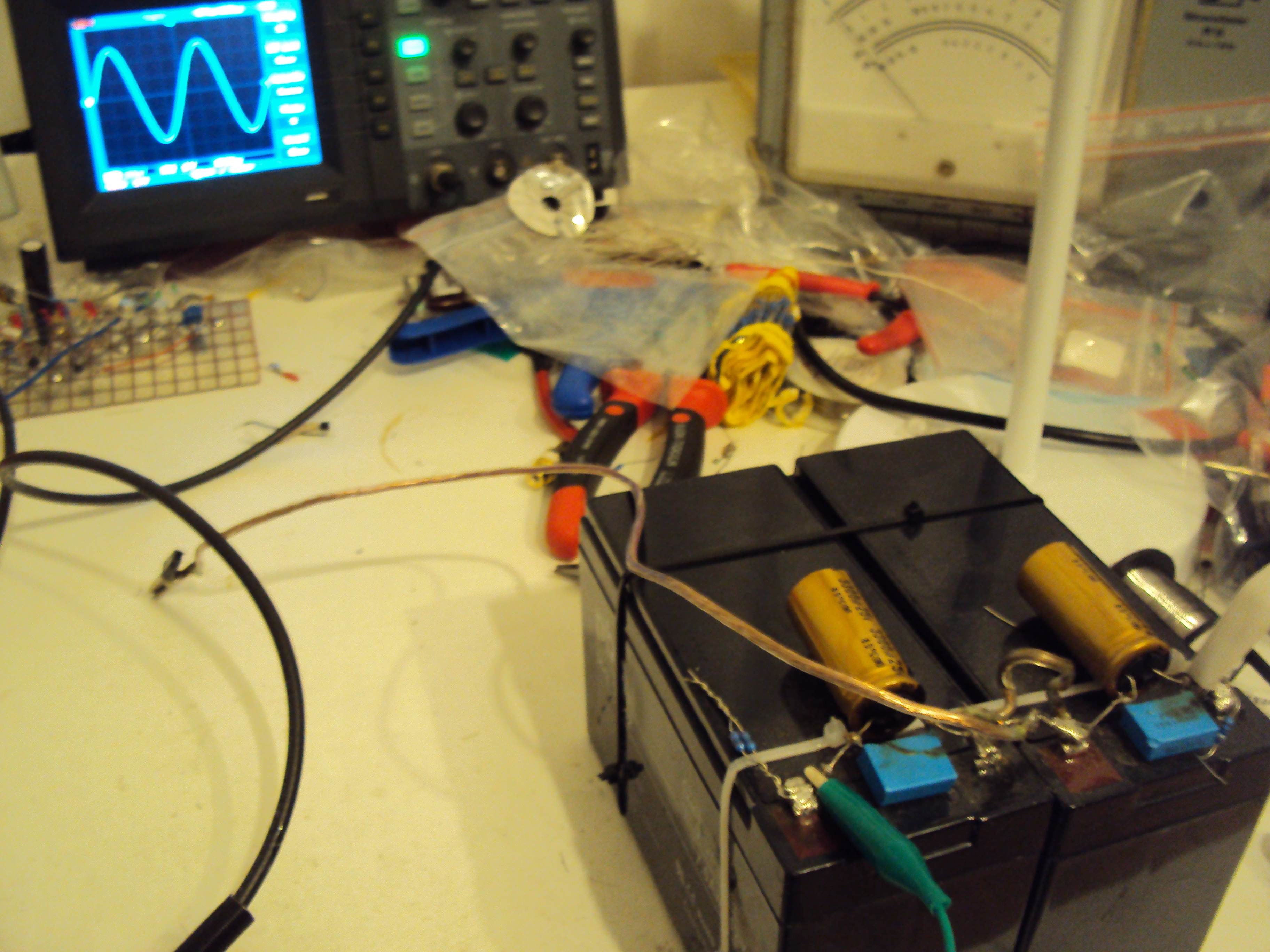

As i suspected the circuit can be run on a floating supply. You see in the right picture that the center tab between the batteries is disconnected.
What is the advantage of floating ?
That would deserve a separate thread.
Floating center tap might promote further isolation.
Good for low current preamps working in class A ?
Not very good if one of the rails pulls more current than the other https://mail-attachment.googleuserc...878&sads=DdfLofjqvCU2hzi5Y7x7spId_m4&sadssc=1
When you look back on this thread i already did a lot of work on transimpedance inputs.
What bugged me is the input offset. I think this is solved when the input is balanced.
The other was how to measure such an input. After some brain storming i got the idea of the floating resistive divider and it worked.
It has also the advantage that the generator can be run on a comfortable voltage range and the devider also reduces noise from the generator.
I had that idea from Dough Self when he measured at low volume but his implementation was single ended.
