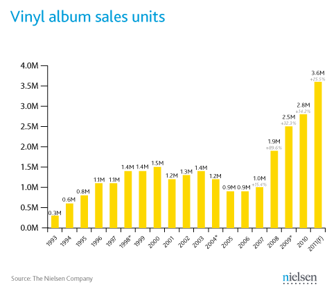

This is an interesting statistic, since 2006 vinyl sales goes up again. It is not huge but nevertheless it shows a trend.
One of the leading, and also very old and famous, CD shops is closing its doors. Plato, in Rotterdam, but also Plato in Den Haag are closing the shop forever. That in itself is not very shocking, but the comment that was made, on television, by one of the competitors was enlighten 🙂 he did say, something like, They are going out of business due to not serving the market, the market is moving to vinyl, and Plato was selling CD’s only. Makes you wonder… where is this going…
3voor12 - Home
And some perspective http://www.smh.com.au/digital-life/hometech/vinyl-gets-its-groove-back-20120606-1zuv7.html
I see the trend when going to Audio shows, vinyls is growing,. Think the future will be a split between analogue and bandwidth limited analogue (digital) streaming... The good news is that regardless speakers are needed..🙂 for me the fact that vinyl is increasing s a sign that the audiofile hobby is growing and that the hobbyists like the ritual of the LP... The streaming and unlimited access removes the value of the music, it becomes a given, always present, but not of value, analogue restores the value, the adjustments, the tweaking and our influence on the result, makes the hobby grow and lures the users into the very best addiction..😉
