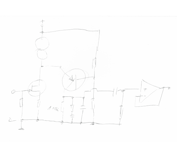

With single ended you have the problem that the high current in the folded cascode gives much too much DC over the transimpedance bass resistor. 50mA over 100kOhm is a lot.
Since the output of the folded cascode is at or near zero DCV I don't see the point here.
I don't choose a higher current in a folded casc. than I would in a regular one (of course
as seen for a single transistor).
I still do not understand. Even when we set the current low in the folded cascode, say 1mA, we still have the problem by Ohms law that too much DC voltage develops over the RIAA. This way ......
