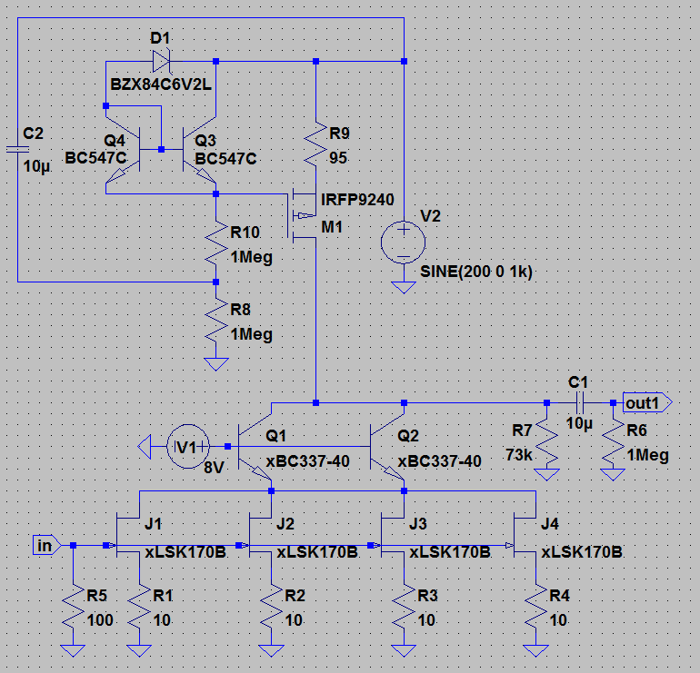

Here another CCS.
After some experimentation I got this (see attachment) it has a very slight negative temperature coefficient and seems to be really stable.
Varying the load from 1 to 100 ohm gives only a delta of 2.7 uA on the 26mA output current, that is about 1ppm.
As it is running at a good current it will get warm and thus the negative temperature coefficient will help stabilize it.
The zener diode can be replace by a string (3 or 4) of led’s. And a capacitor could be added parallel to Q3(ec), this will remove some noise. I do not know what the overall noise figure of this circuit is.
[Edit] P.s. it runs (in the schema) at/from 200V, but that is not needed the collectors of Q1 and Q2 are (in the schema) at about 7 Volt.
[Edit] P.s. it will be needed to replace the 1Meg resistors with 100K resistors when running from a more realistic voltage.

So you are really using a big P-Channel one. I should have some.
Have you calculated the gain of this circuit ?
No success on my side so far. I get the DC drift super stable but i end up with too low gain. Of cause the low gain relaxes the demand on the CCS.
As the current in the 170's is very critical it is difficult to get a realistic figure for gain and noise (and this is not my field of expertise you know 🙂). Maybe the easiest way is just to build it (it's not very complex).
See it as just one of Frans’s doodle’s 🙂

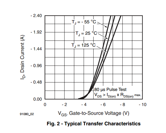

Some research gives the attached graph (for the IRF9610) it shows that Vgs is independent of temperature for about 100mA Id; for the IRFP240 this is at 4.8V at 300mA (about). Somewhere there should be a fit for 30mA (as is needed here).
Or, it should be possible to match a DZtc to the DMOStc and get a temperature neutral system with only a zener and a mosfet 🙂 No need for the 2 transistors (but keep the resistors and the cap).
It will not work for the purpose, due to the small SOA and 150mW maximum dissipation. At 30mA and Vcc 35V the device to be used must be able to dissipate at the least 20 * 30m = 600mW (and that is not even considering any margin/SOA concerns).
