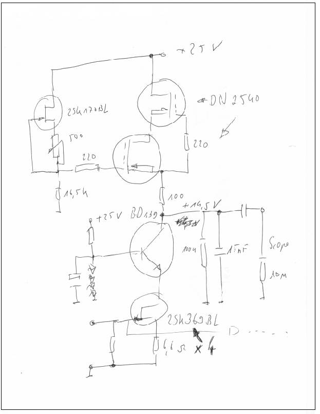

I have seen the Bartola Gyrator. Depletion mosfets can also being run on fixed bias.
That could help to stabilize drift. I have the depletion CCS on my bench and could try this rather fast.

Stefano, you could try to build your solution and i will setup the Bartola CCS.
That is easier for me because i have the DN2540 allraedy on the bread board.

Jaochim, could you please let us know when you have run the Bartola CCS how it works and how much gain do you get out of the gain stage?
Stefano, i am a bit slow today, sorry.
I had to redesign the Bartola because i do not have the small Supertex depletion mosfets.
I am trying a J-Fet for biasing now.
Franz has designed a stable CSS too. He requested that i review it before he posts it.

Anyway, good news, The J-Fet - Depletion Fet CSS is rock solid and the stage amplifies.
Circuit comes soon.
In what world do we life today ?
Circuit comes soon.
I have some concerns about the gain i am getting. If i have not wired something wrong it seems too low.
