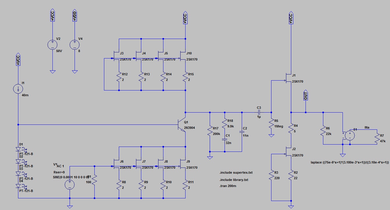

The CSS has to provide THE EXACT SAME CURRENT THEN THE INPUT STAGE PROVIDES AT IDDLE, ALL THE TIME. If that does not happen the DC voltage at the output node is not EXACTLY at 1/2 voltage of the supply. That condition gives the MAXIMUM DYNAMIC RANGE ( Tietze- Schenk ).
I am also thinking that with one monolithic i.e. one pair of IF there should be plenty of gain, very low noise more thermal stability due to the monolotic.
I was also thinking why wouldn't we use Jfet for the current source?
In this instance using the same paralled IF monolithic?
Is it a stupid idea?
here is the idea I was describing before.
It onlu gives 46dB gain which is clearly not enough.
The problem however is:
1) the noise simulation shows 0.87nV/rtHz for only 46dB which puts it into the noisy side
2) the topology is INVERTING and I don't think there is much it can be done here. I would have expected that since output is sourced from a common source
Another thing that needs to be noted and that I just thought of is that output of the first stage can't be half of the rail, this wouldn't lead to maximum headroom, but has to be rail-Vcascade-2V(for saturation) which clearly shows that for good headroom capability you need high voltage rail which migh be a problem for regular JFets or at least operating to their maximum derating.

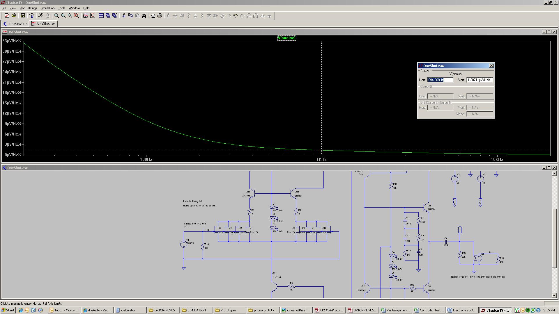

Now to comment on some progresses I made on the design, do you guys still remember the one shot approach?
I modeled it up as it seems to be a pretty nice circuit.
it can be easily obtained 62dB out of it, non-inverting topology.
However Noise simulation would seem to rule this out. Below is the noise simulation's result.
Residual noise would be comparable to a modified paradise without ElCap which sounds wonderful, but IMHO noise is unacceptable.
Some reasonable noise level could be 0.7nV/rtHz.
Any comment? Is it possible to fix this?
