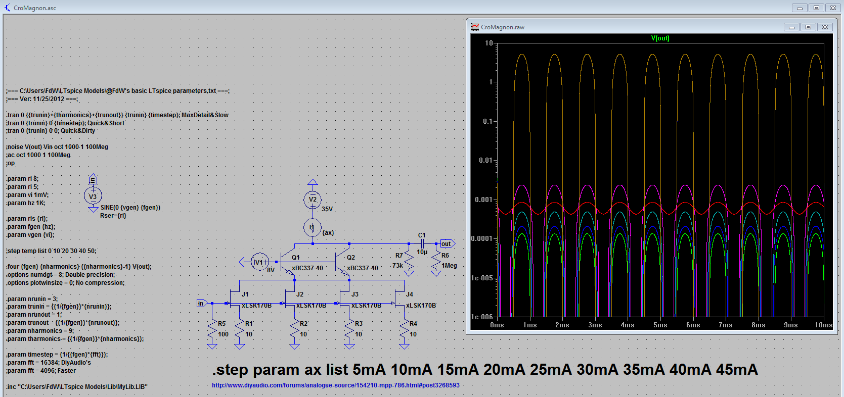

Like this? Does not work (for now).
Well, Sampler made it work. How, i do not know. Maybe he comes back on this.
yep it is the same model I have and sampler has simulated.
I agree with you that it doesn't work and I would be astounded to see that such a simple circuit boosts 80dB with relatively low distortion, it would be the MOST minimal circuit you can ever think.
I would rave to try such a topology if it was working.
However I still don't understand why Sampler got that result.

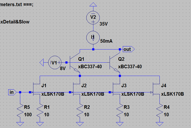

Frans, your circuit does not work because there is only ca. 25mA idle in the input stage and your CCS delivers 50mA. That makes the voltage over the CCS break down.

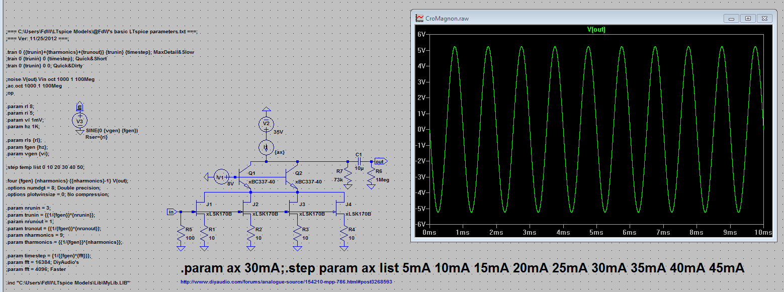

I got it to work on the basic idea. It is a matter of having the right amount of current droving on the top current source of the cascade.
Here is a screnshot.

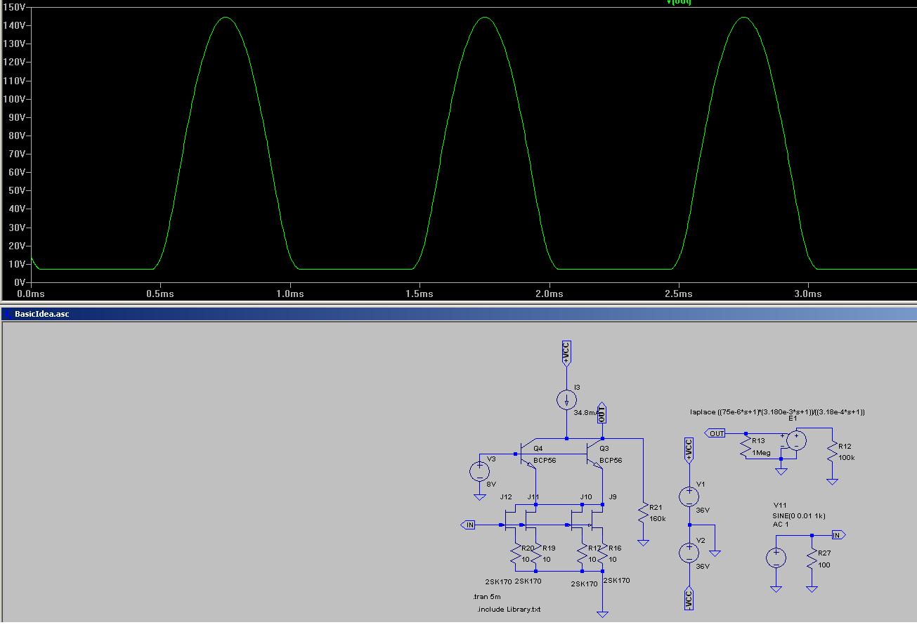

Yes, and now it works 🙂 I got the 50mA from Stefano's work (V(D7)+V(D8)+V(D9)-Vbe(Q3))/100 = +/- 50mA 🙂
With the CCS at 25mA the output voltage is (purple) about 0.002V but at 30mA (and more) it goes to 6V (or there about).
My approach to a problem like this is to first simplify it to the max (and that is what I did 🙂).
And this is the output at 30mA (1mV in)

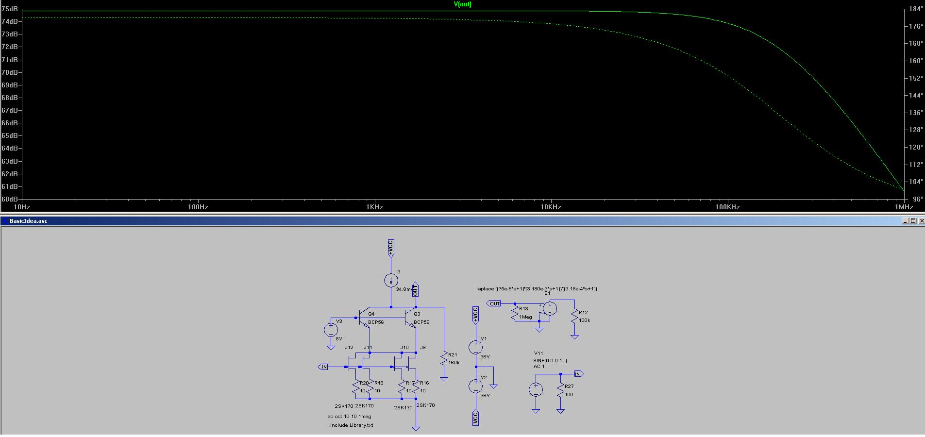

Well, what is the optimum idle in the input stage ?
We want high gain and the gain of Fets goes up when the idle goes up.
50mA from 4 x BF862 gives a transconductance ( Gm ) of ca. 160mS.
Gm x R is the gain so we want high Gm and high R. The problem we then run in is DC stability and we need a high impedance node at the output of the input stage or the gain will drop again because the output impedance Rout appears in parallel to R in the formula Gm x R. You can than say G ( gain ) = ( Gm x R ) / Rout.
This high impedance comes with the problem that even a small DC shift in the input stage is transferred into a big DC shift over R, in our case the RIAA transimpedance components shunted to ground. The task is to find a low drift, low noise, high impedance CCS.
