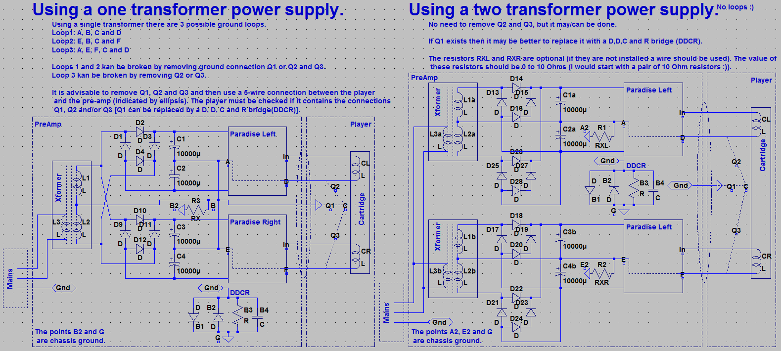

The 'ground loop' is more like a multiple connected ground system, where one connection is routed though the transformer (both amps share the same ground return to the TX) and the other connection is at the input (the shared return/ground of the cartridge/player). The shared cartridge connection can be broken by using a 5 wire connection to the player (connecting Left+ and Left- to the left amp, Right+ and Right- to the right amp, and having a separate player ground to the amp ground).
This is not something that I have experience with, and something that I would not advice. My advice is, get 2 TX's :)

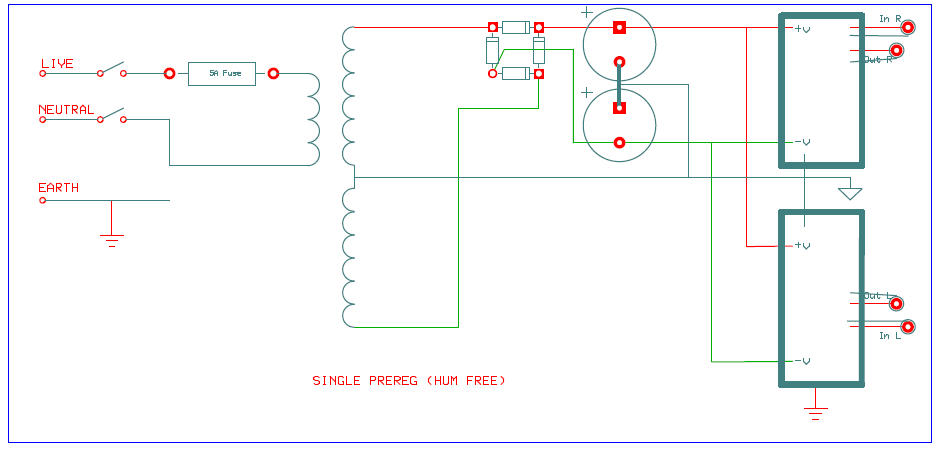

Just to make it clear I am using a single TX with single prereg without any hum.

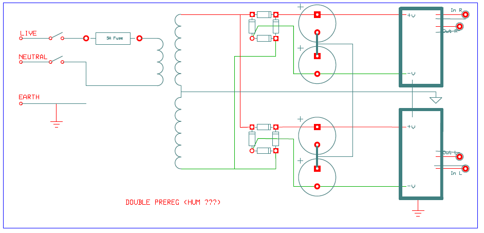

I removed some components so you can view easily what I mean.... the two pics below represent the single prereg that I am using now (perfect) and the new layout I would like to try.
Please let me know if you see an aditional GND Loop in the double prallel prereg sketch :)

If there is no hum in the first then I see no reason for hum in the second. Beyond that, check the player for the Q1, Q2 and Q3 connections.
Just one more question Frans, in your double mono schematic (two tx) I see you do not connect both grounds (left and right) together.
Also you do not make any reference to the output connections, so I admit we can leave both channels running completely independent without any common reference between them. What if there is a slight voltage difference between both channels grounds... does it procuce a current flowing in the output interconnects ? (I assume both output negatives will be joined inside the following preamp / power amp).

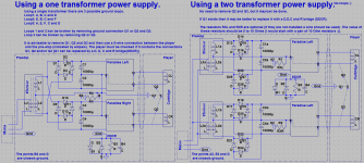

That’s right (spotted) and it is wrong (drawn). Check this out here is an updated (again) drawing :) In this new arrangement for 2 TX's the circuit/signal-ground is only connected (left to right) in the attached amplifier, no loops possible any ware. Your concern about voltage differences is cared for by the RX, RXL and RXR resistors.
Wow this is difficult to get right... but we will succeed :)
Regarding TT connections, IMO Q2 and Q3 are not common because in good setups, the four wires comming out of the cart are always isolated from each other.
Connection Q1 to C is normal if C is the tonearm tubing, but C does never connect to any wire comming out of the cart.
That is why a single TX + prereg works.
But no harm in checking :) I will leave the notes about it in the drawing.

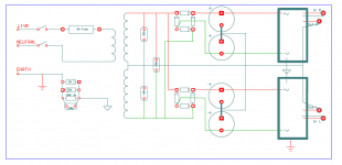

Now it looks cool.... wonderfull idea those 10 ohm resistors to take care of gnd voltage fluctuations... I am really glad you cared to hep me in this subject.
Now about chassis grounding and TT ground connection.... My best results where obtained by connecting the chassis directly to mains earth and connect the circuit gnd to the chassis via the DDCR.
So A2, E2 and G should be all connected together forming a star but isolated from the chassis. The TT arm GND wire should then be connected to this star gnd and not to the chassis.
Please take your time to review this because these are my findings... not a rule :)
