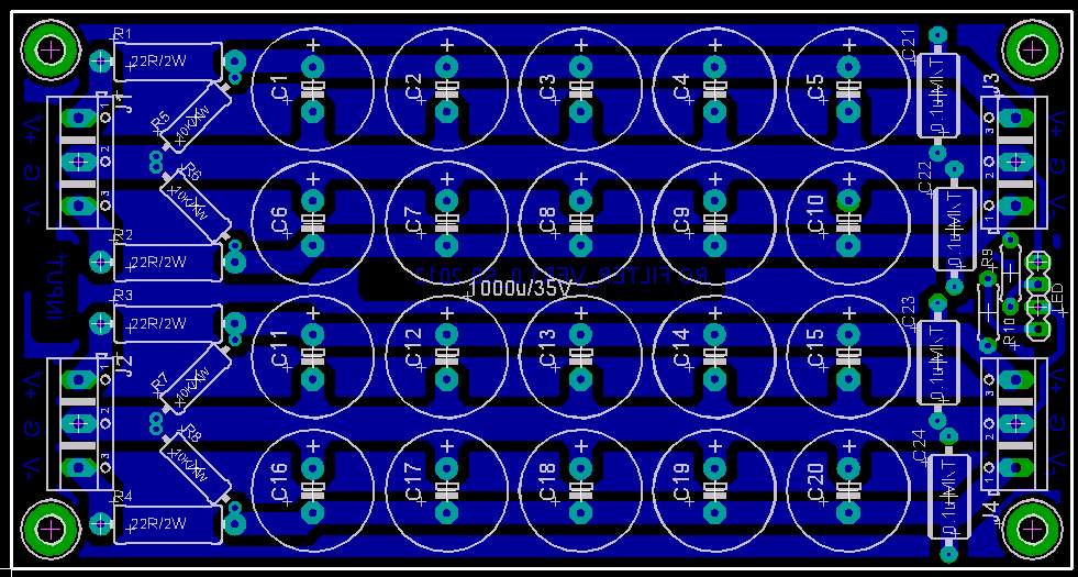

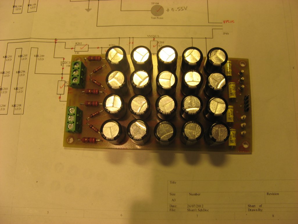

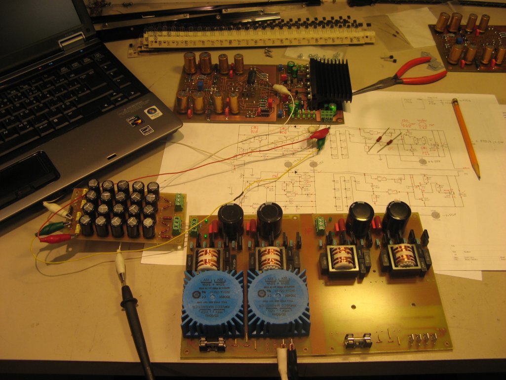

Finally had time to start to assemble my Paradise preamp boards. Both shunt supplies section are working fine. I tested them using a simulated preamp load, and was able to check my pre-reg and rc-filer small pcb as a complete circuit. That confirmed that the pre-reg pcb is ok, and with the specified parts, the RC filter drop resistor gives me 26.5V at the input of the preamp insuring that the shunt heatsink is not too hot. I'll continue the assembly of the preamp.

Installed all the preamp parts, all matched per sections. Here my readings, I'll check the RIAA curve accuracy this evening. Since everything is well balanced, I guest it is working fine.
Supplies +/-18V, 150ma ea
TP3= +14.5V TP5, 6= +16.36V
TP4= -14.5V TP9,10= -16.36V
Each Gain Cell transistor, each emitter resistor V=115mv (3.5ma each)
Vin = 0mv (adjusted with R1)
Vout: DC offset keeps changing around +/-25mv
Gain: 61.4dB at 1Khz
Vout max: 30Vpk-pk

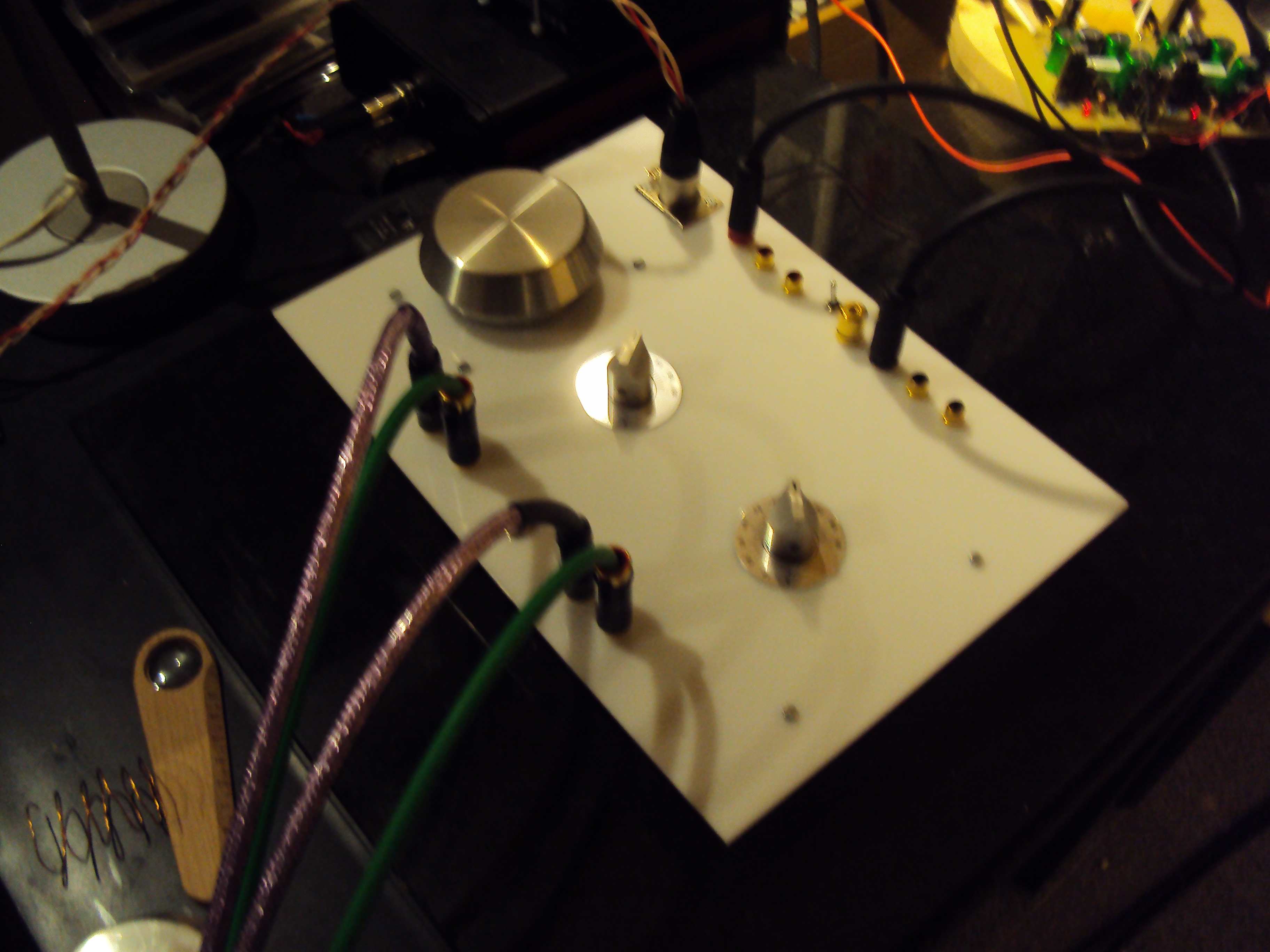

In the backround you see a phono stage
called " Stille " ( Silence ) i prepare for the Vienna Klangbilder show.
