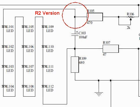

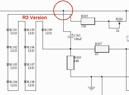

Hi. I think there may be an error in the Regulator R3 schematic. See the included schematics. In the R3 version schematic the +Side of C103/C203 is connected to the VPLUS/VMINUS line on top (circled in red). In the previous R1 and R2 version of the schematic, the same capacitor is connected to R105/R205 to act as a filter for the led bank voltage reference. It think this is the correct way of connecting C103/C203 but I may be wrong.
Which schematic is the correct one?
Thanks for spotting this, I reviewed the versions and we decided to change this connection to VPLUS/VMINUS in version 2. So version 2 and also version 3 have the caps connected there, only version 1 had it connected at the resistor / LED junction.
