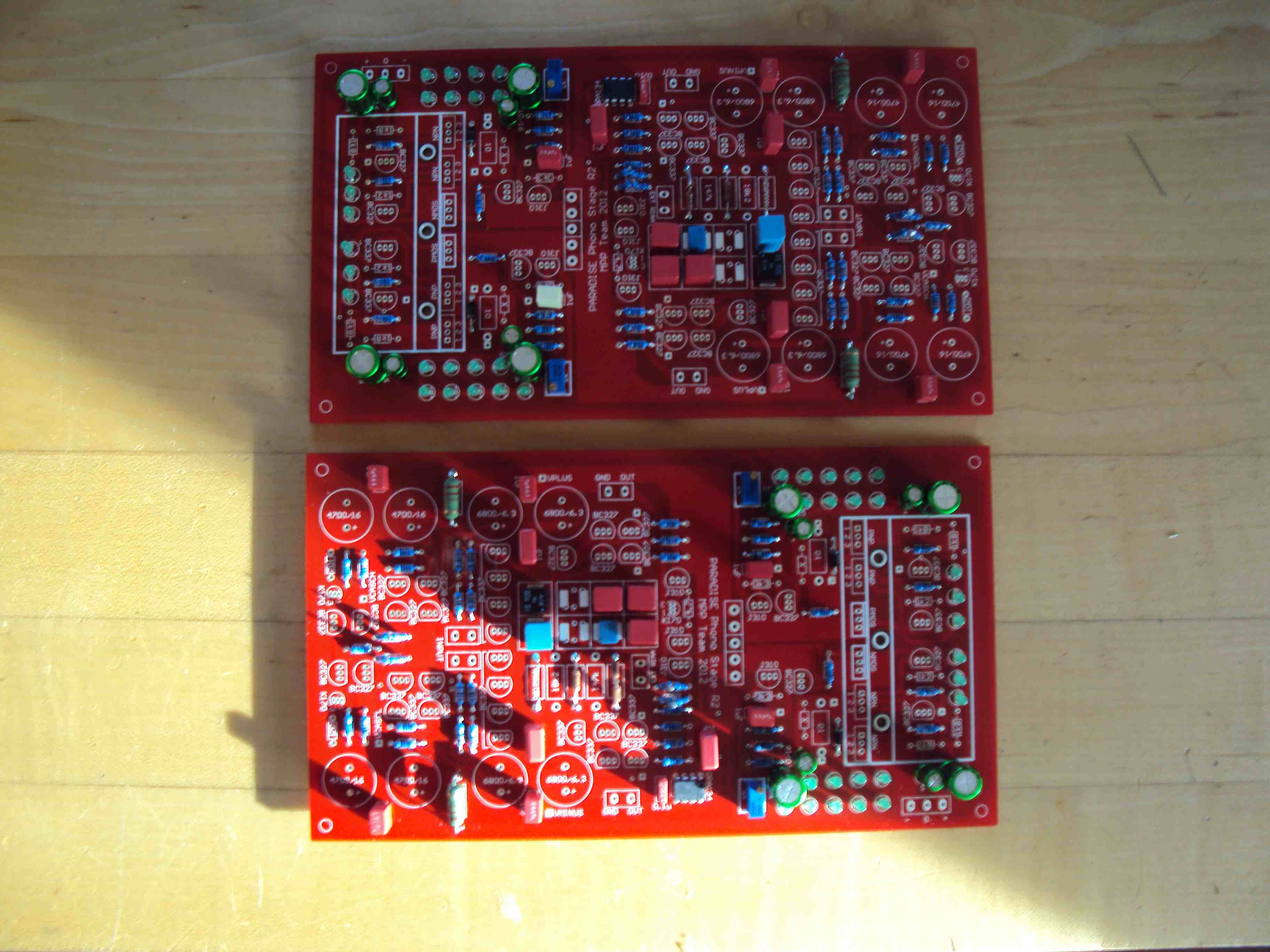

Some more stuffing has being going on.
For the RIAA is use Styroflex in the treble. I got exactly 11nF in both channels.
In the midrange i have 3 x FKP2 10 nF plus 3.3nF KP1830 for a total of 33.2nF, both channels the same, that is still 1%.
The smaller resistor is a Dale CMF55 non magnetic 9.09kOhm and the bigger one is a series connection of two Dale CMF55 for a total of 73.6kOhm.
For the servo i use LF411, that is a bit cheaper then the OPA134 and works as well.
I have to order more parts to finish.

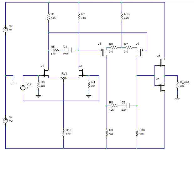

Here, as an example of a two stage transimpedance RIAA, the design of Mr.Evil.
I did not check the mathematics but i seems to come close.

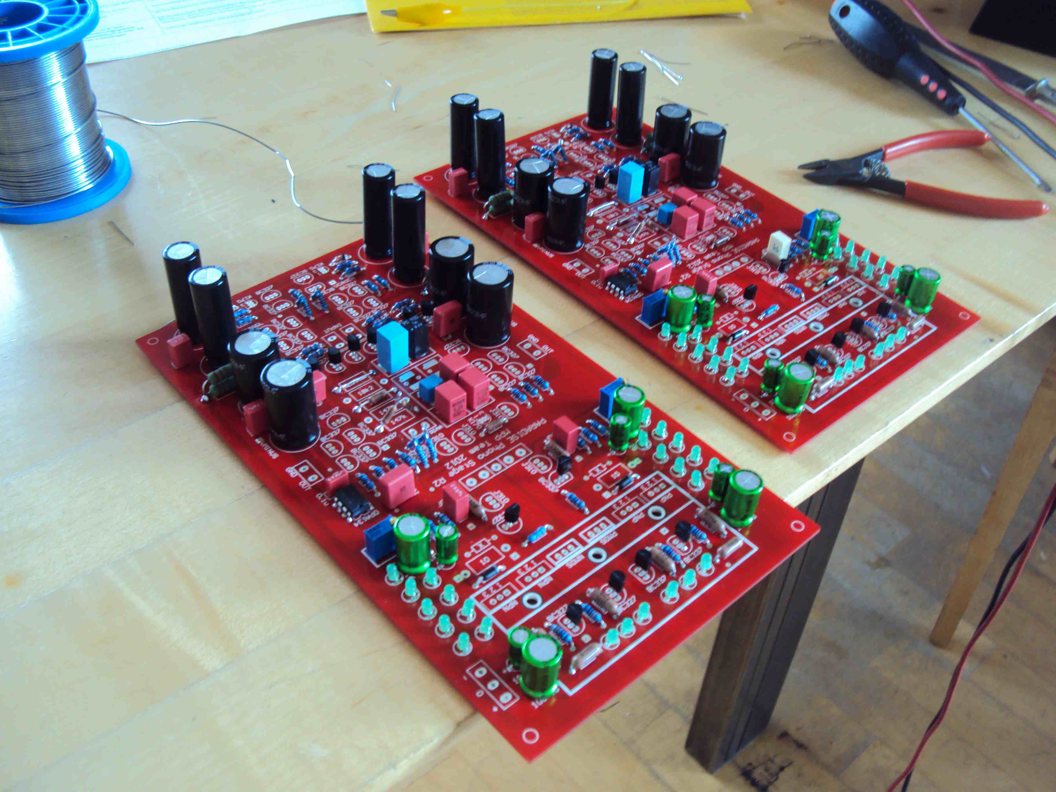

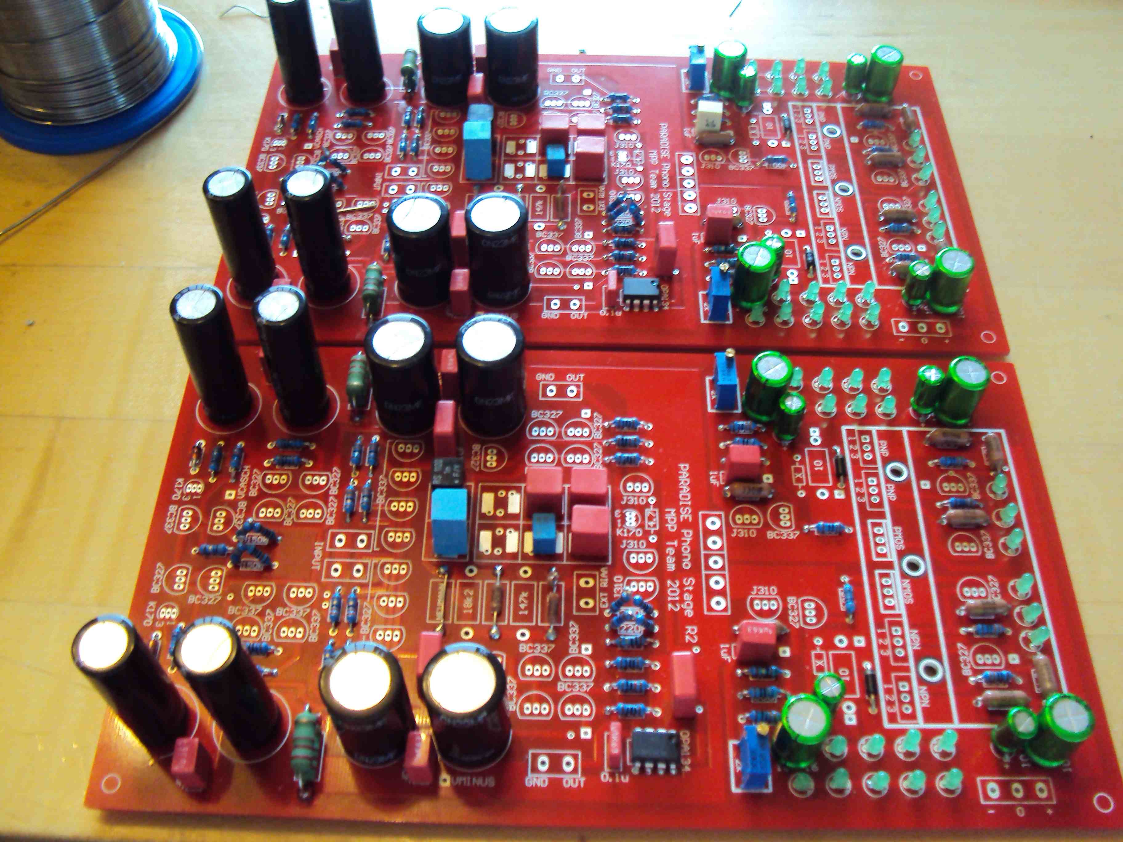

I got more parts from Mouser and have stuffed the Paradise R2 more.
The electrolytics are Panasonic FR. That is a new line that has the same low ESR and high life time then the FM range. They look more compact, so this seems to be competition for Rubicon ZLJ that is a smaller version of ZL. Price is affordable. I also ordered some Dale RN60D.They are i size between RN55 and RN65, cost only 10 cents in small quantity and best, the are non magnetic ! Besides some J310, that are still on order, i can now finsih the boards.
