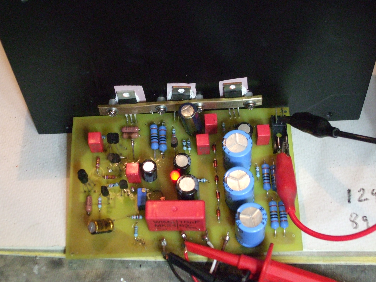

I was pretty sure of that, as I could not find MKP on that footprint.
I have already quite a few MKS 2.2 uf from buerklin any detrimental reason not to use those?
these should do fine. please remember that the caps in the shunt regs and the servo should have 1uf as per schematic, else you are changing the time constants. the other caps are optional, 2.2uf should be fine. the footprint is 5mm but you can drill further holes to make them fit (watch that ground plane for accidental short circuit, though). DC voltage rating should be 30V min.
you may have notednthat the holes for the power diodes in the shunt reg are a little tight, thats already fixed....
let us know how you progress, any issue with the betabuild please drop me a line so I can fix the PCB......
have fun!
have fun!
Oh yeh

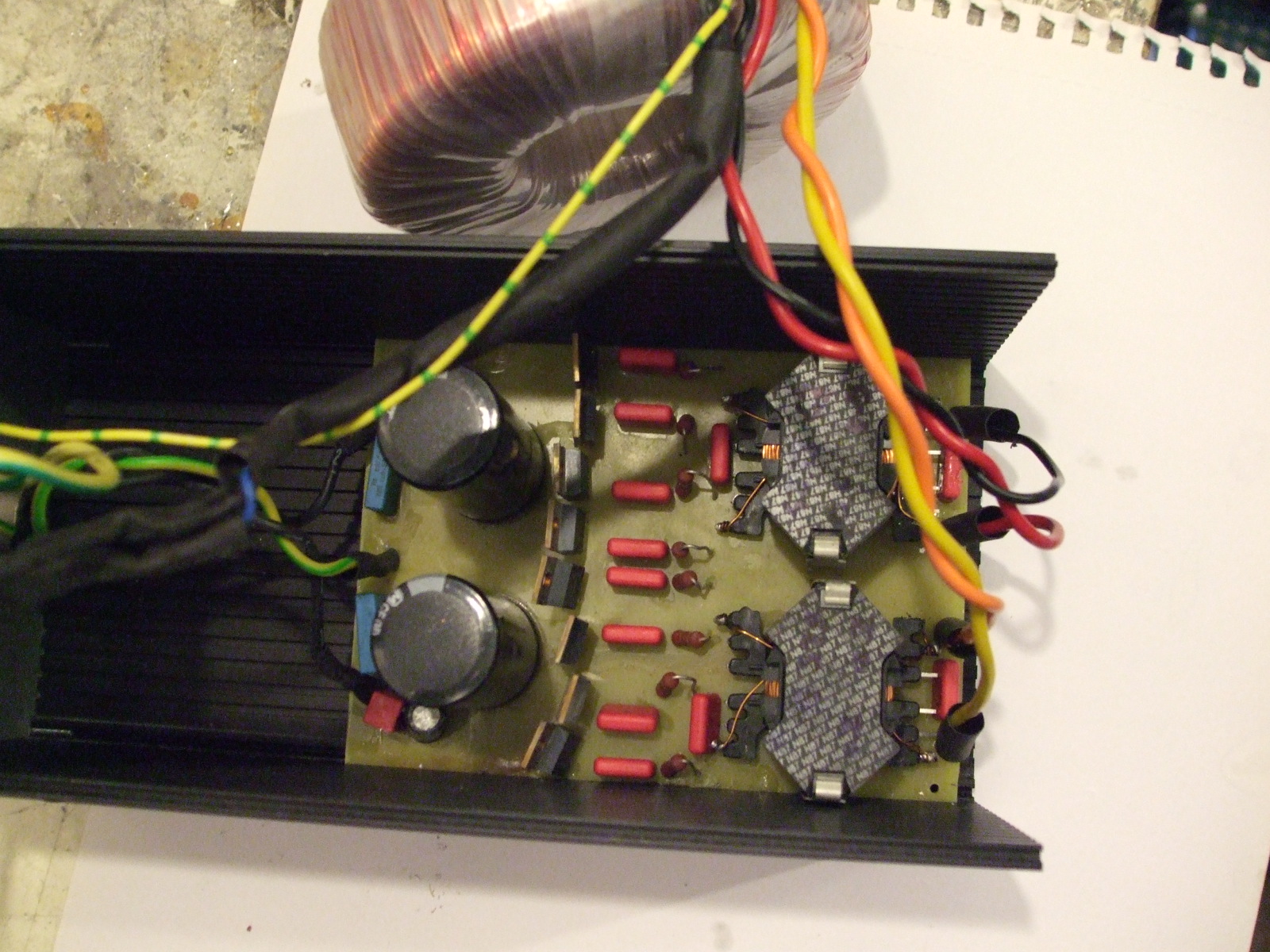

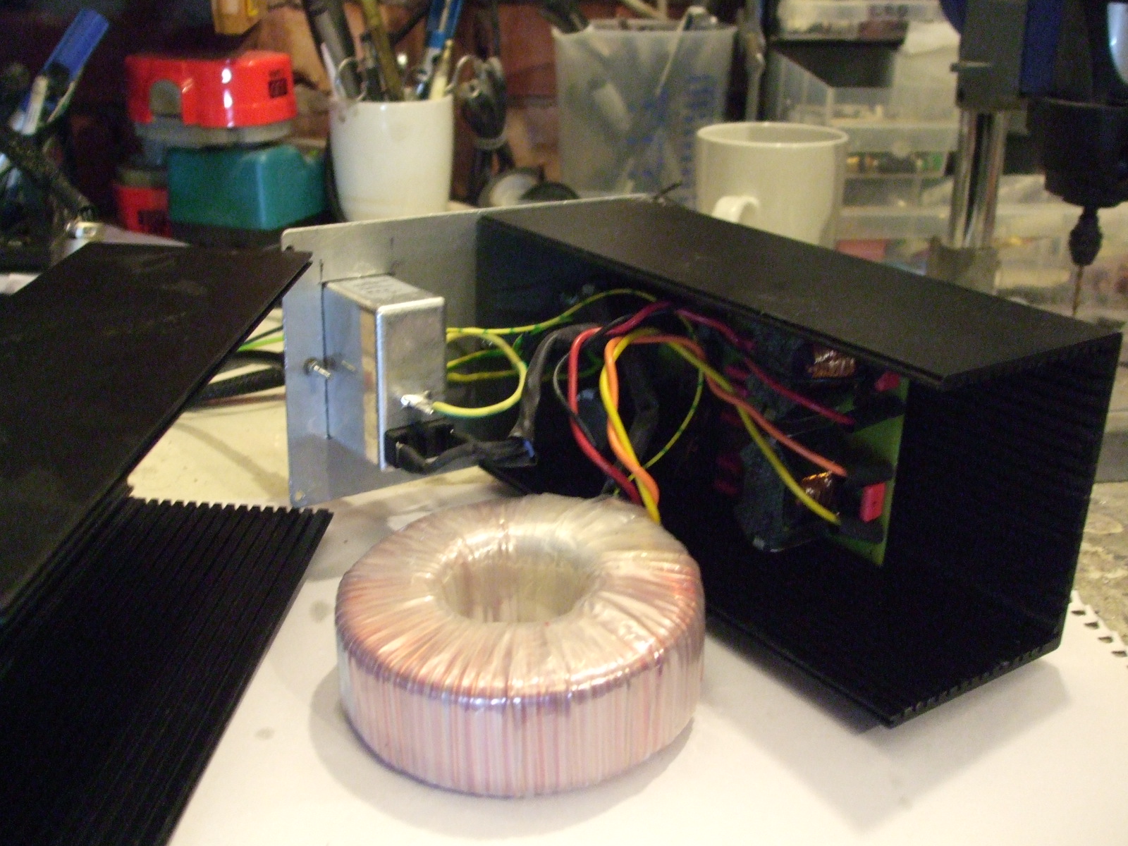

Got pre-reg ond same FiFi raw suply cooking
for preamplifier from bolshy droog on other tread.
Those dudas give prety clean 35V at 140 mA so as I got one set already may as well make second set for Phono stage.
Sorry if taking long was hoping for pre-amp to be finished 2 weeks ago
Raw series Shunt reg
Separate Trafo box with emc filter and ...pre-regulator
