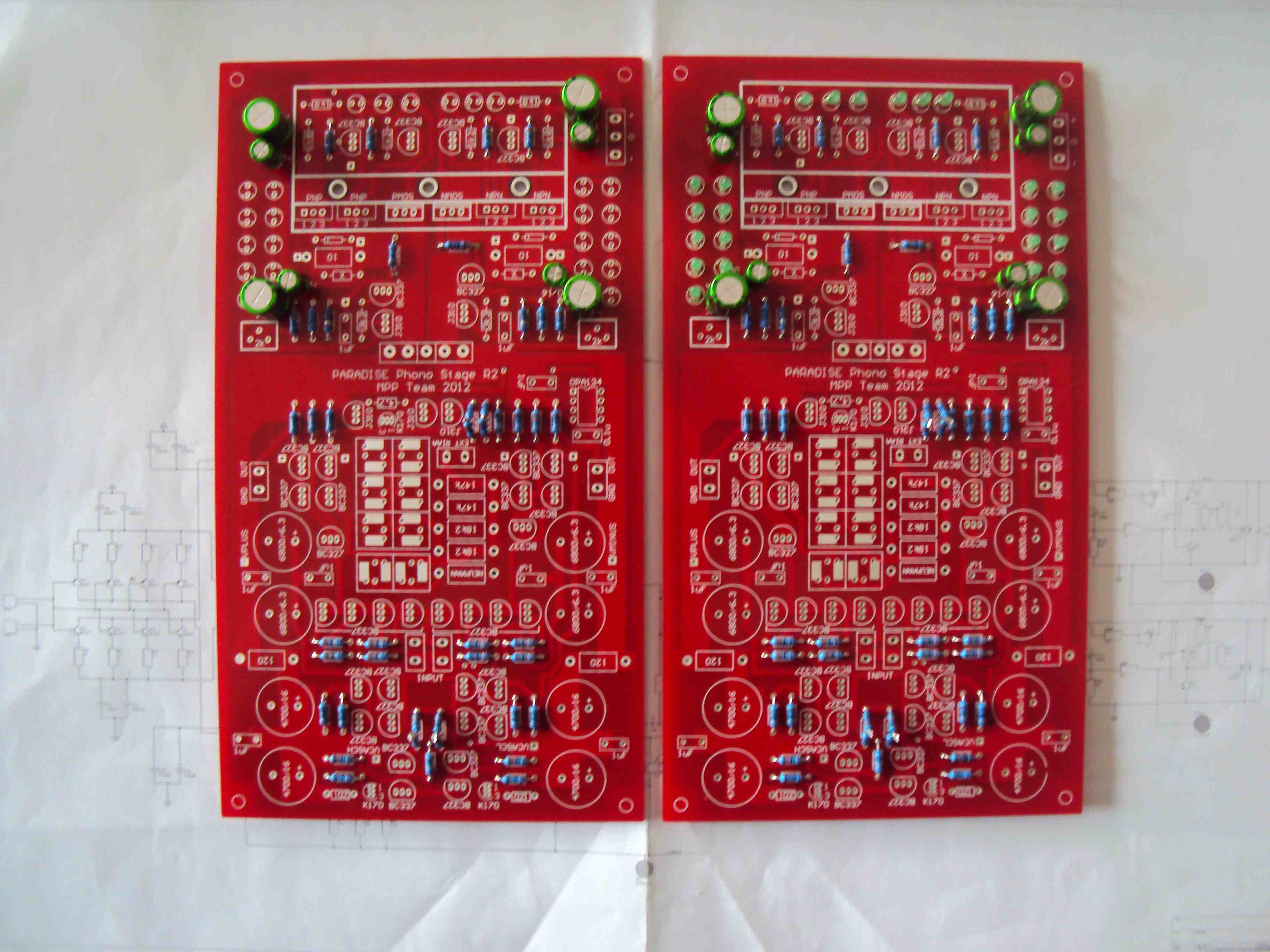

I start to stuff my new Paradise boards today !

great that your caps have matching colours with the LEDs ;-)
have you checked the polarity of the LEDs especially the three at the "north" end? one of them is the other way around... this will be fixed.....

Yes, the Leds are correct this time.

Unexperienced beta builder stuffing boards 101
Resistors first and then bits and bobs with same height
And drawing and boom and sharph pencill to tick things off.

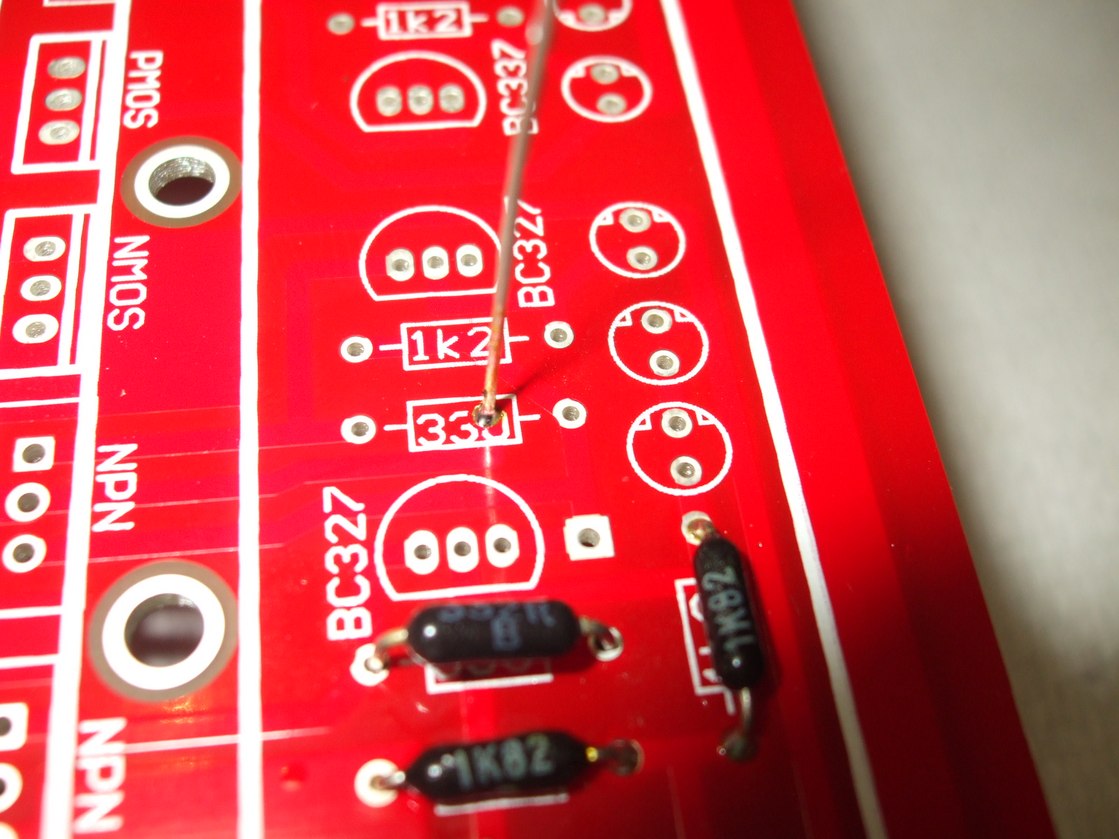

Any way while I am doing stuffing boards 101
Clean up the wires sticking out of the resistors those IRc are bit worst than most and have same yellow like residues of varnish like especially near body ends.
So just a bit of 400 or 600 emery paper folded in half and gentle up down up down.
Ps boards solder pretty well and fell real quality like. Me personally as inexperienced would like bigger pads but I am pretty sure that by this afternoon I will get use to it so no problems

Bksabath, i have seen that hidden Vias too. As far as i can tell soldering a wire into them is not necessary but i will check with Hesener.

So far so good board are prety solid no truble disoldering / swapping components.

Big question:
What is the right (calculated) value for the RIAA resistors?
I know board is marked 18K2 and 147K
